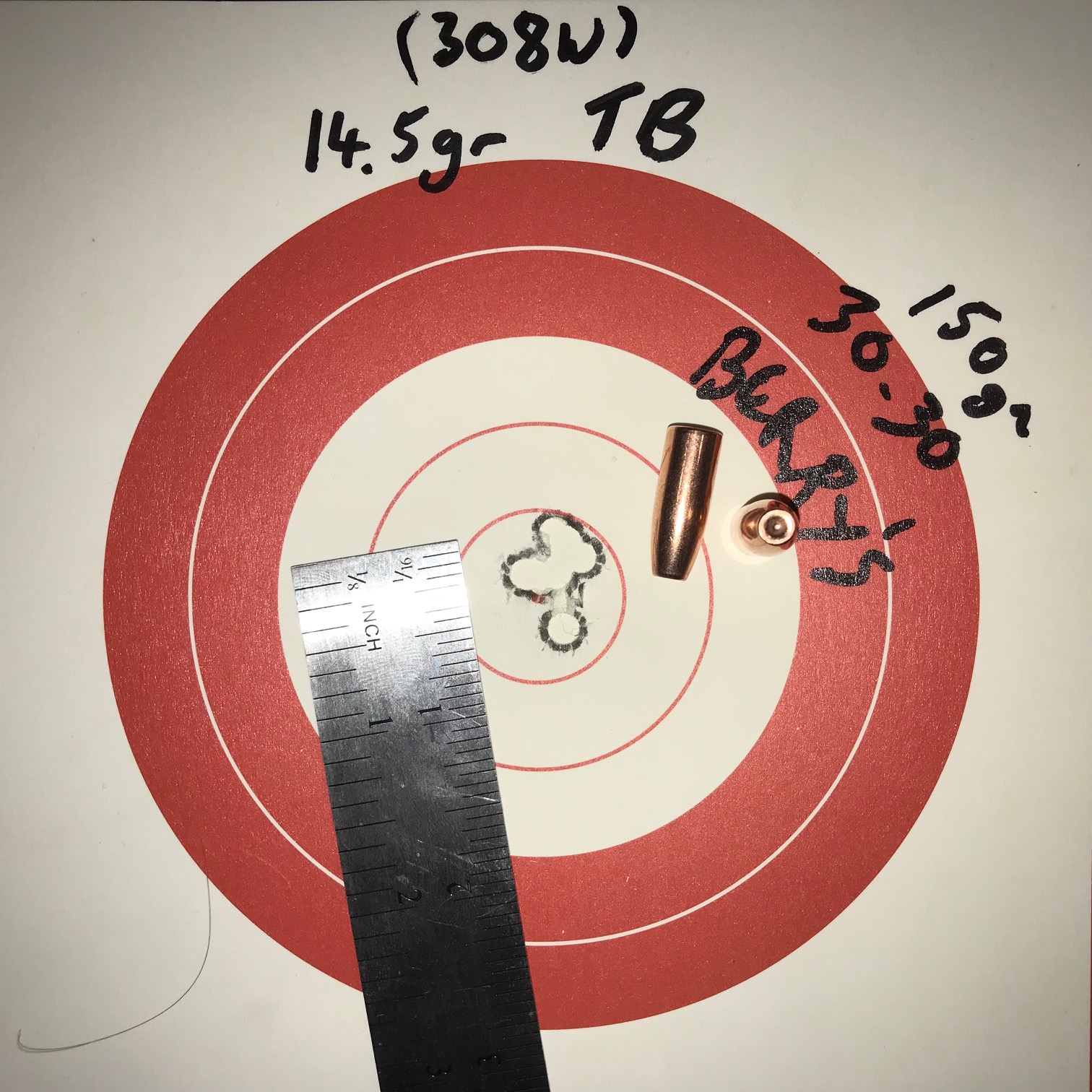

I shot this 50m 8-shot experimental group in my 308 bolt gun recently; a full case of Trail Boss under the aforementioned Berry's bullet:
14.5gr Trail Boss under Berry's 150gr 30-30 (.308) @50m
The one shot that's a bit low was me pulling the trigger at the wrong time - that's just ludicrous accuracy IMO given how little it cost to cook :crazy:
Getting back to your BO requirements - you should try and get a heavier barrelled carbine if possible - perhaps the Ruger Ranch?

Nice shooting mate, and I am looking at the Ruger American ranch. Be perfect for what I want it for.

Would Trail Boss in your 308 do everything that you were hoping to do with the 300? I think that a 45/70 with Trail Boss is a pretty good alternative to the Blackout.
