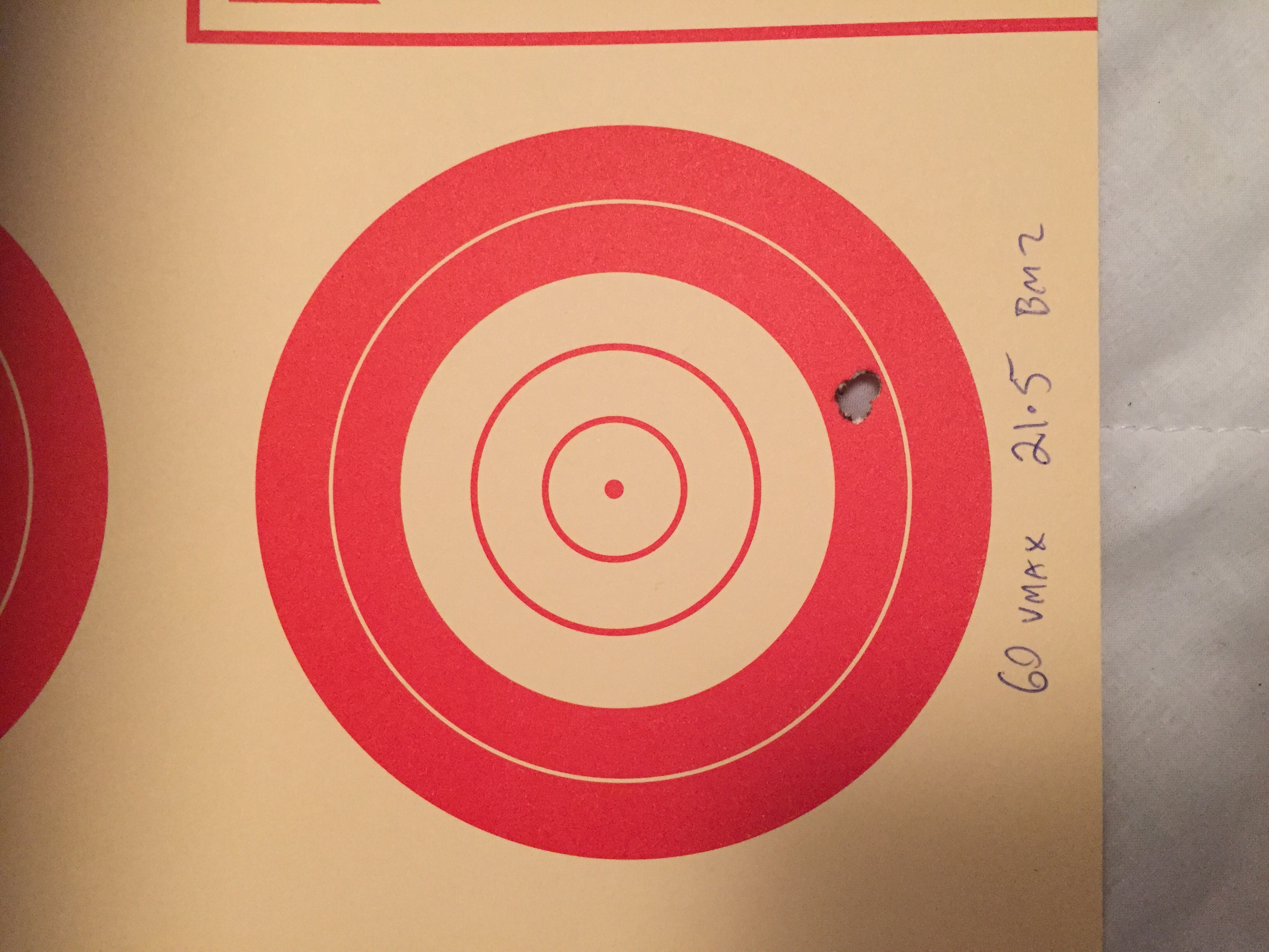

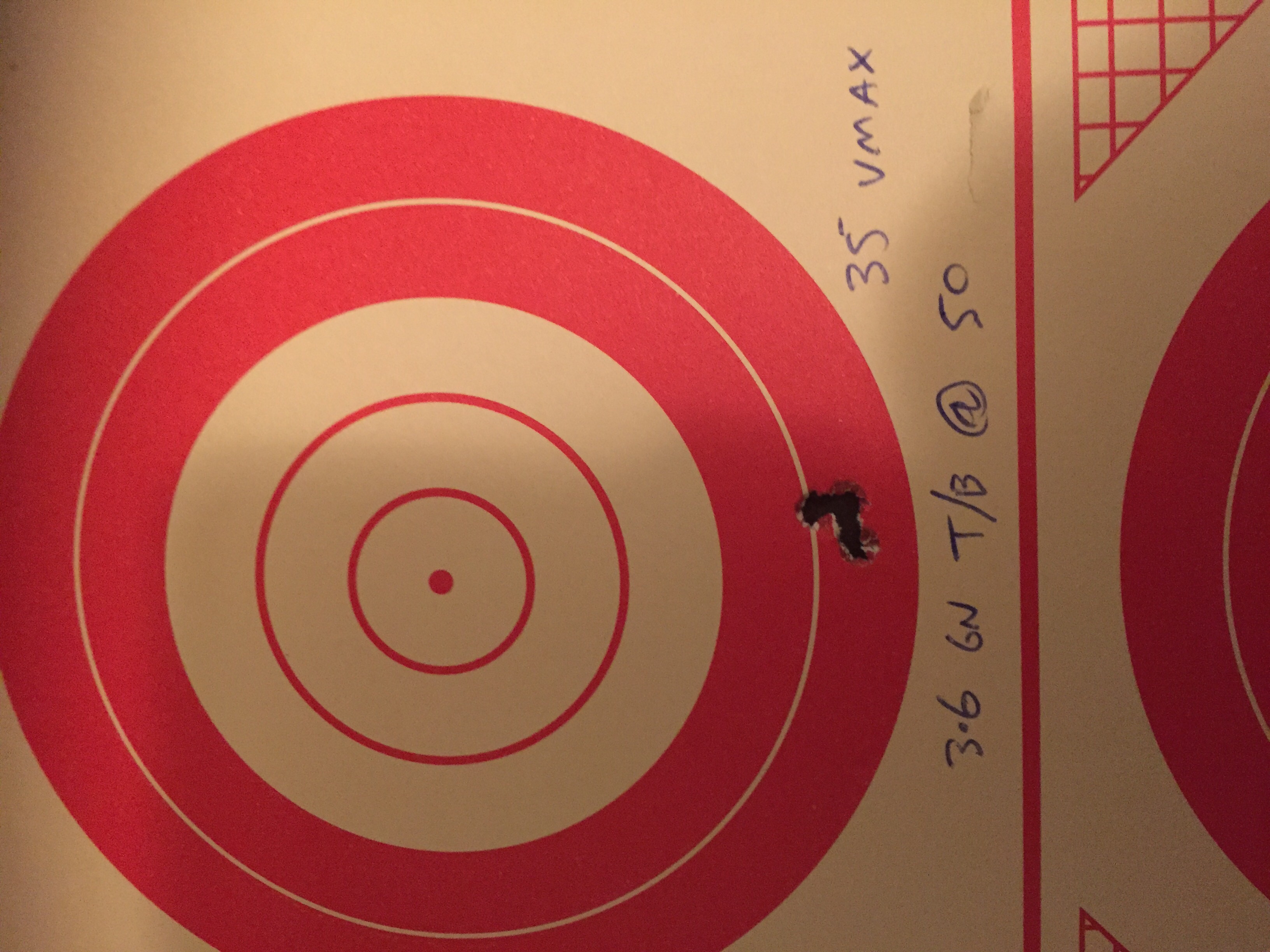

Post by Oldbloke » 08 May 2019, 7:00 pm
"I know , I could buy a perfectly good howa pencil barrel 223 for $700 and download it to 22 hornet and use the extra cash to buy some loadin gear and ammo but i dont want to , thanks all the same."
Bad decision. Buy a 222 or 223 and reload. I use both a "normal" and a "hornet" load out of my 223.

Another fine old fox round, 17 rem. My own 22 “walk around “ rifle is my model 70 Winchester in 222. The following group was shot by a mate in my rifle with 60 vmax at 100. The 60’s have a trajectory that’s close to my 6.5x55 at 100 and 200 , with 2800fps with 21.5 gn of benchmark 2 . I can get 55’s going faster, but I like the 60’s accuracy and better wind bucking abilities :thumbsup:
3 shots 60 vmax at 100

Post by JimTom » 08 May 2019, 8:00 pm
Nothing wrong with that at all mate. Nice load.

JimTom wrote:Nothing wrong with that at all mate. Nice load.
the ole 222 is a nice cartridge that makes good accuracy easy. that group and others like it were shot of a fold out cheapie tripod front rest and a caldwell bean bag under the butt. no lead sleds and viced rests for me ;) it made me mates day when he shot that group . straight after that he shot a perfect clover leaf out of his 222 brno fox , so he was on a roll that morning :D
anyway, back to hornet. the following pic is the trailboss load with 35 vmax at 50
:drinks: :drinks: :thumbsup:

The following is a 3.6 gn T/B load crimped with a 35 vmax
Trail boss load
