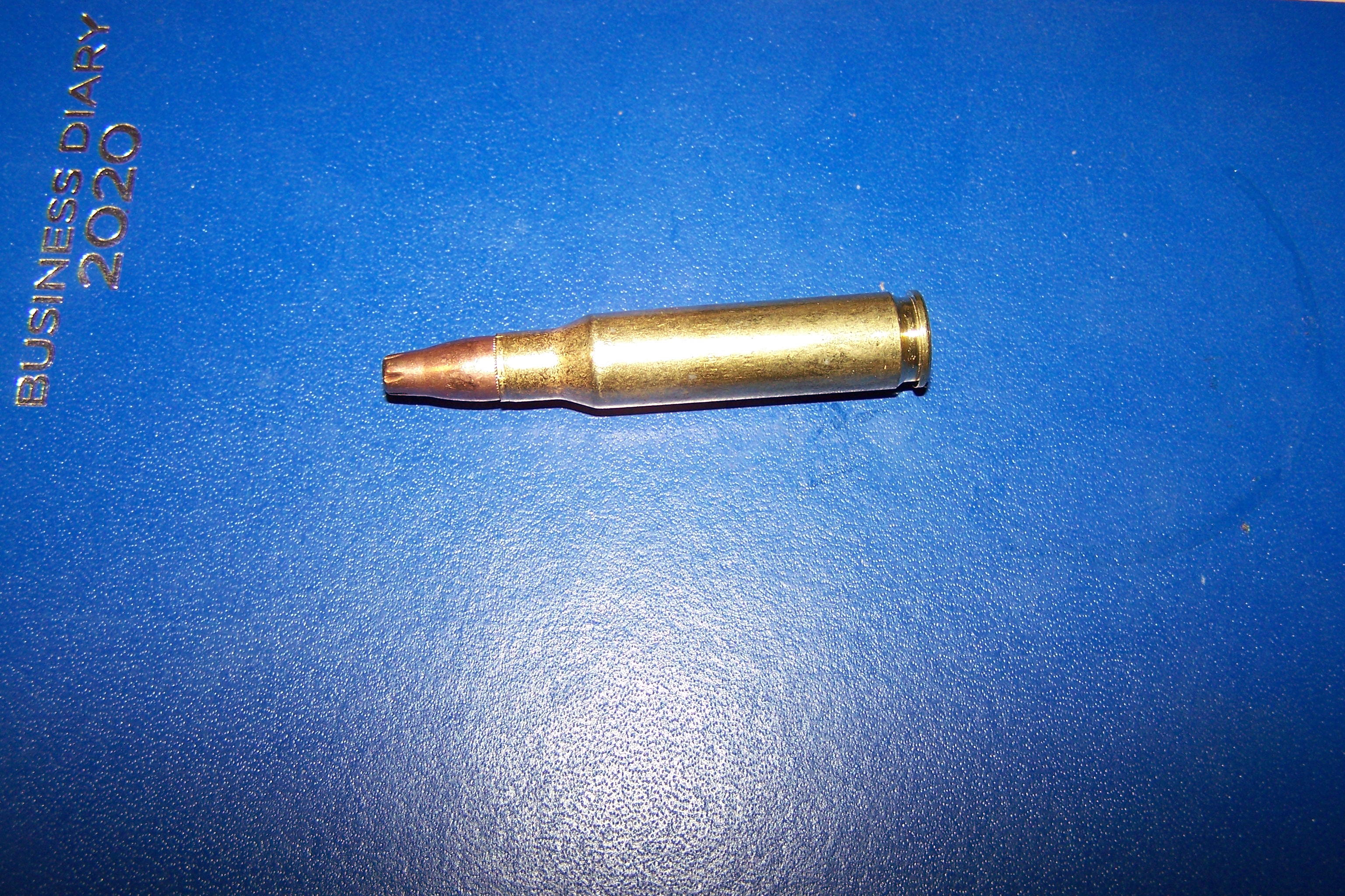

Post by Die Judicii » 21 Mar 2020, 8:33 pm
They are Hollow Points to boot.
Will post a pic of one shortly.

Post by Die Judicii » 21 Mar 2020, 8:46 pm

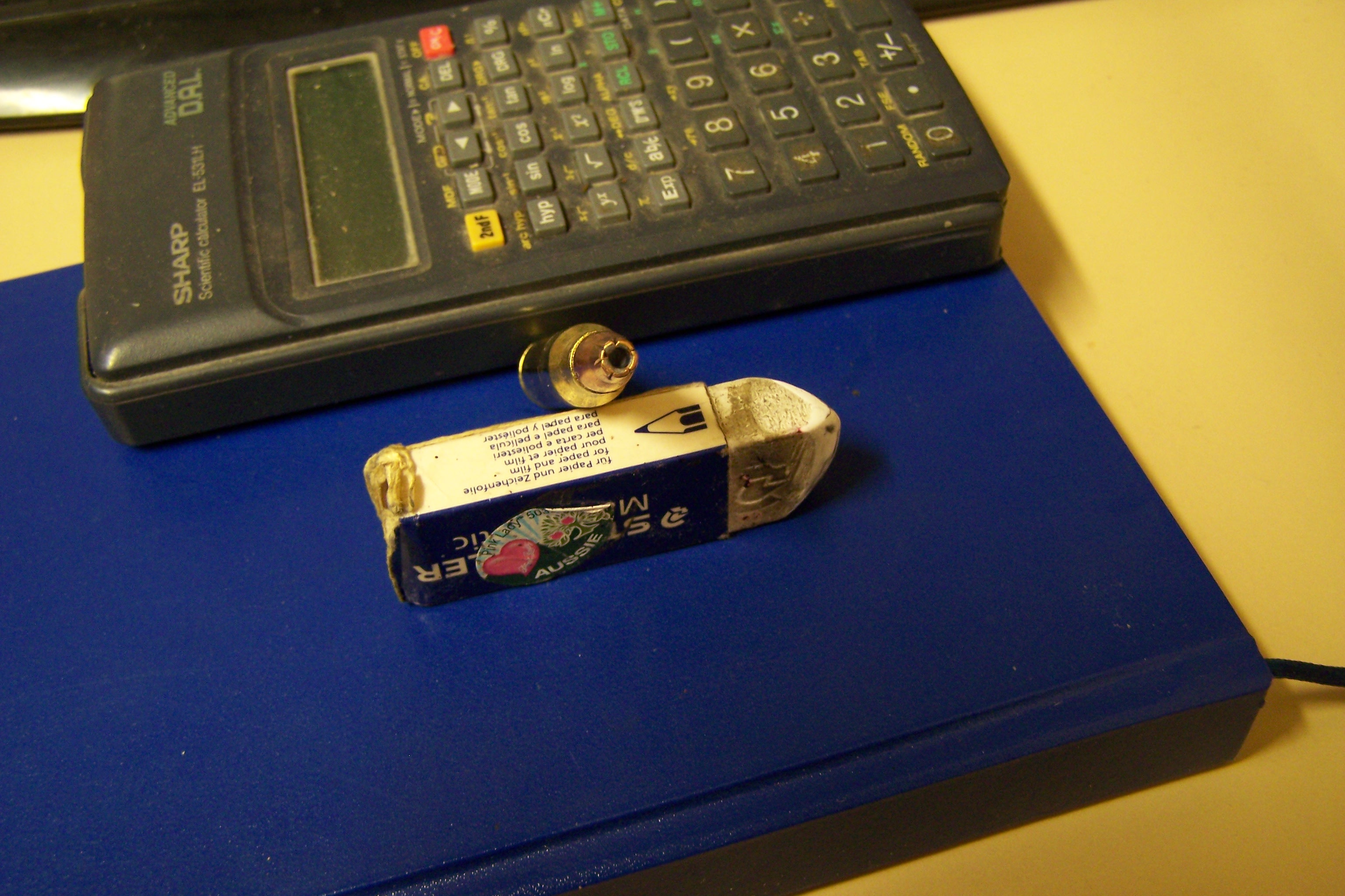

Post by Die Judicii » 21 Mar 2020, 8:53 pm
Overall lengths,,,,,
Winchester Subsonics = 2.547 inches
Remington Corelokts = 2.713 inches
Posts: 4408
Re: Sako twist rate/projectile weight
Post by bladeracer » 21 Mar 2020, 9:01 pm
Die Judicii wrote:Overall lengths,,,,,
Overall length of the cartridge doesn't tell us anything, although the shorter length does imply a blunter bullet.
