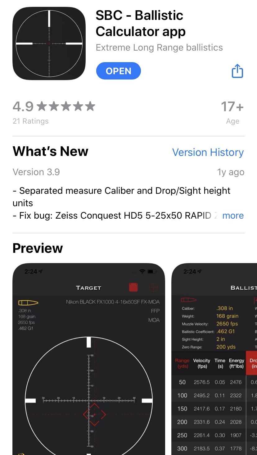

Post by TassieTiger » 04 Jun 2020, 7:46 pm
This is free and will answer quite a few Q’s
https://itunes.apple.com/us/app/sniper- ... 1026883819
Re: Temperature and trajectory
Post by Aliqua » 04 Jun 2020, 8:59 pm
TassieTiger wrote:This is free and will answer quite a few Q’s
Disclaimer: Android user. Clicked link out of curiosity, $15.99 :(

Well that will teach ya Aliqua.
It’s def free on iPhone. :violin:

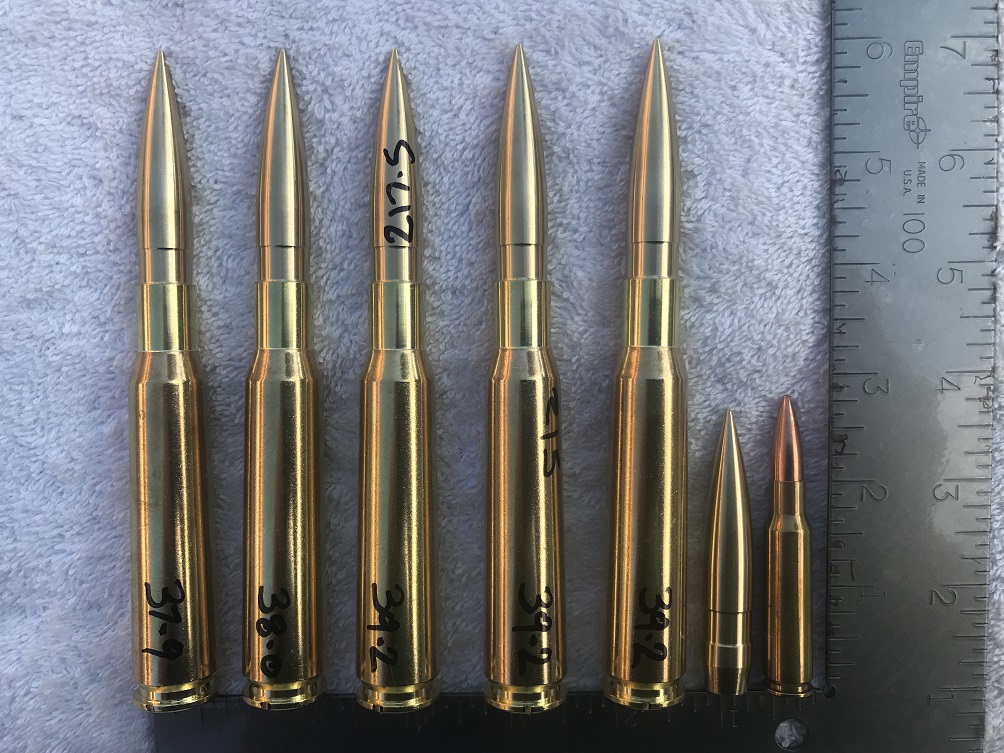

Post by brett1868 » 05 Jun 2020, 9:19 pm
Onya mate :friends: while i have your attention, do you neck-turn and FLS every reload?
If you watch any of the Bryan Litz doco on YouTube from the 2017 KOT2M you might see me lurking in the background. I observed that comp then competed in the World Titles straight after which was both enjoyable and extremely frustrating.
I do neck turn and a pile of other prep work to brass that needs to hit 600yds or more as there's not much to be gained from the full prep on hunting rounds.
For the 50 I start with quality brass - Lapua, FLRS, Trim, Neck expand, Neck turn to 0.018" wall thickness, Anneal, FLRS again, Primer pocket uniform, Flash hole uniform, Seat old primer in backwards, Weigh and zero scale, Fill with water and weigh again recording the capacity in gr H2O, Remove primer, Dry, Measure case wall thickness at the midpoint, Notch the rim on the thinnest section, Prime, Charge, Seat long, Measure and adjust seating before final seat, Check and adjust concentricity depending on projectile. Store in custom made box with projectile pointed down.
Clarification -
Case mass is irrelevant as 2 cases of the same mass can have different internal capacities.
Case wall thickness @ midpoint - Long cases can banana in the chamber when fired which affects concentricity. Chambering the round in the same direction minimises variations in POI at distance.
Pic below is the full potato of prep, using 808gr LeHigh defence bore rider projectiles that I import from the U.S of A. With a light load of 217.5gr of AR2218 they produce 2600fps with a SD of 6.8 and ES of 2.7 which is friggen awesome for this cartridge. Best 5 shot group so far was 5 into 3.8" & 1000yds and it hits harder then the 308 on the right does at the muzzle :)

Post by SCJ429 » 06 Jun 2020, 9:09 am
Unbelievable ES when you are burning over 200 grains of powder. Those projectiles look the ducks guts.
