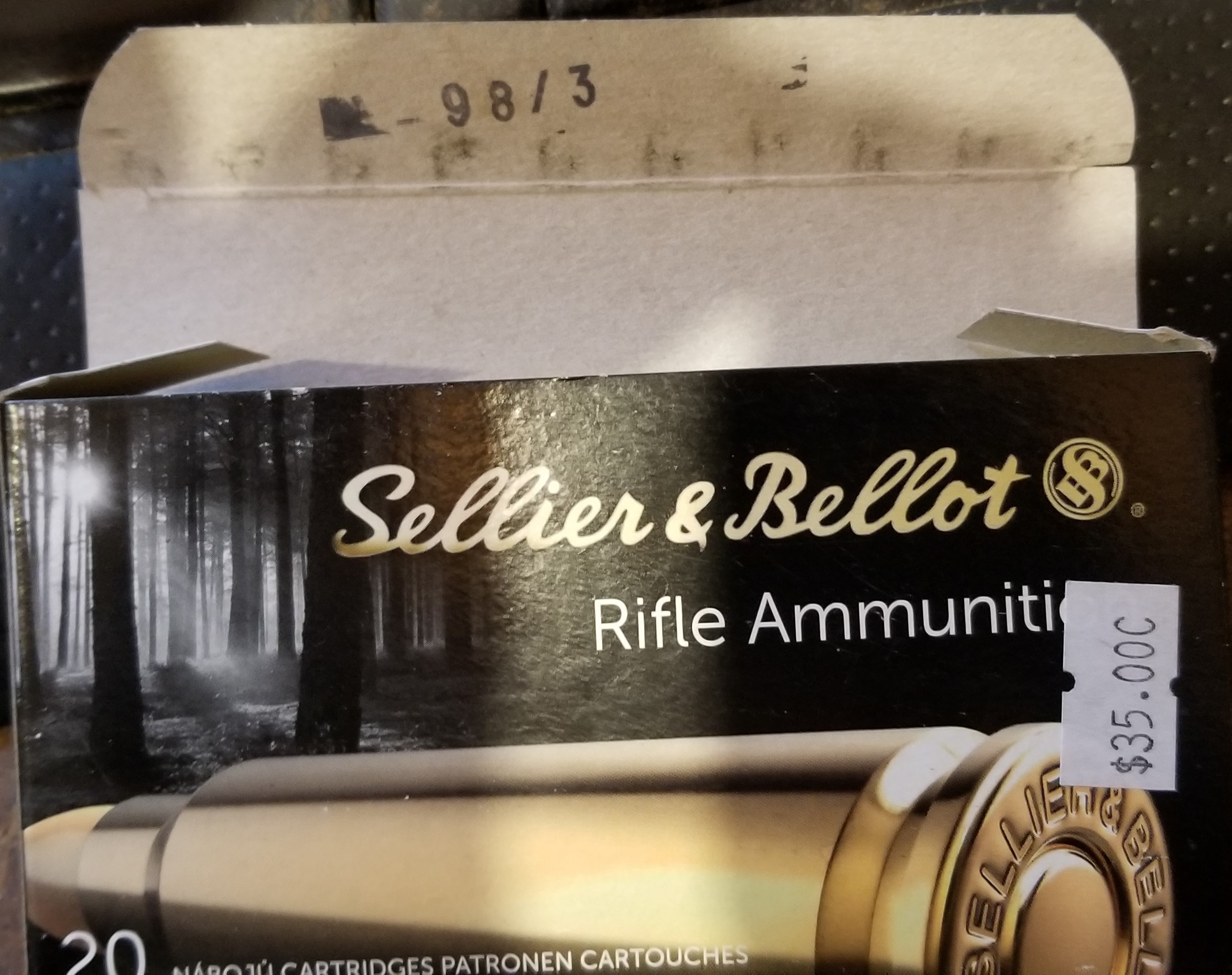

Okay, was in the shop this morning and grabbed a box of ammo.
Inside the box lid is stamped "98/3" - surely this stuff was not made 22 years ago?
Velocity is specified at 728mps or 2388fps.

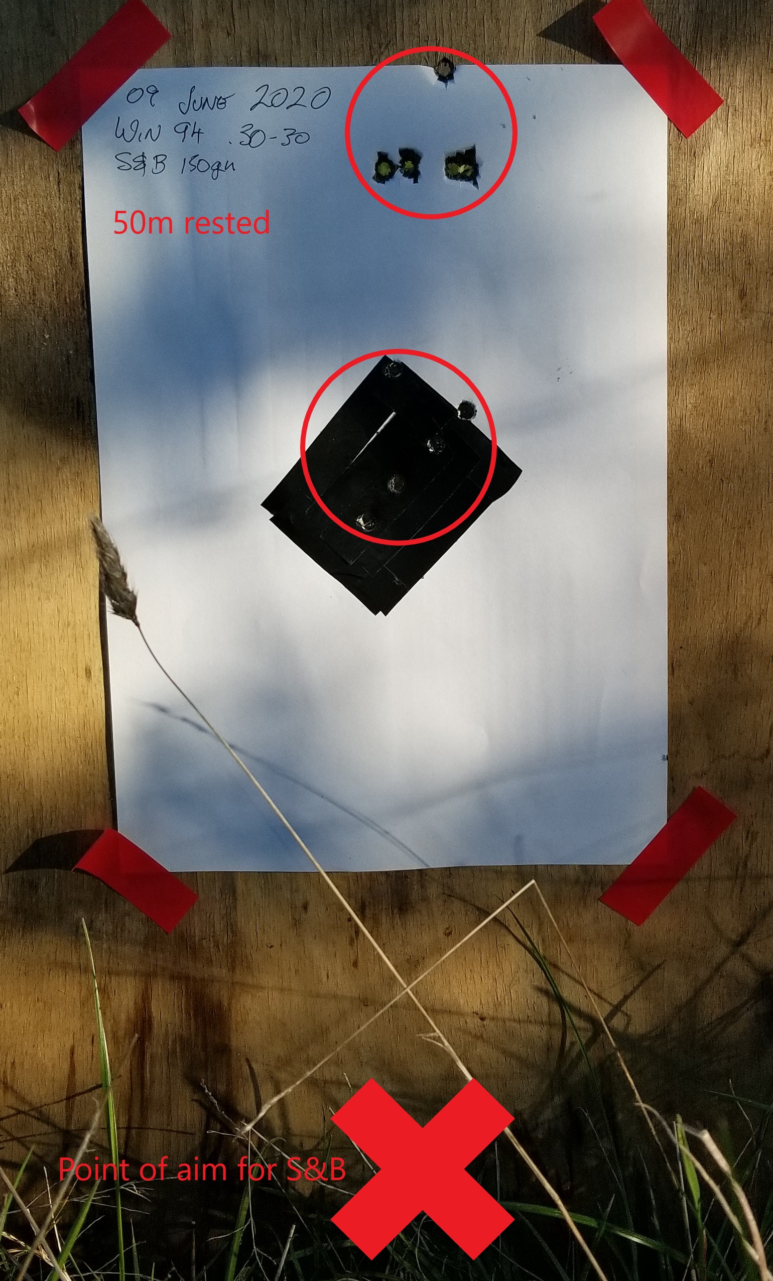

I fired a five-round group of subsonic 150gn Berry's first at 1050fps, grouped at 55mm on zero.
I held low for the S&B and grouped 38mm, just holding "somewhere on the bottom of the board in the grass", very nice. Group is about 400mm higher than my subsonics at 50m, but directly above - nice to know. The S&B is zeroed at around 500m for me :-)

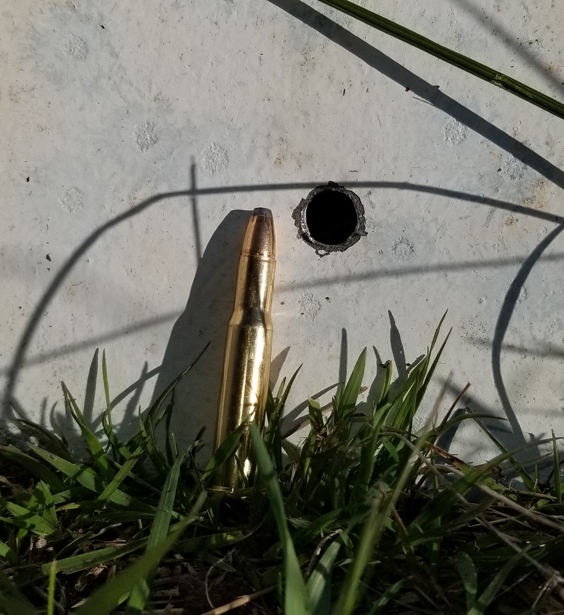

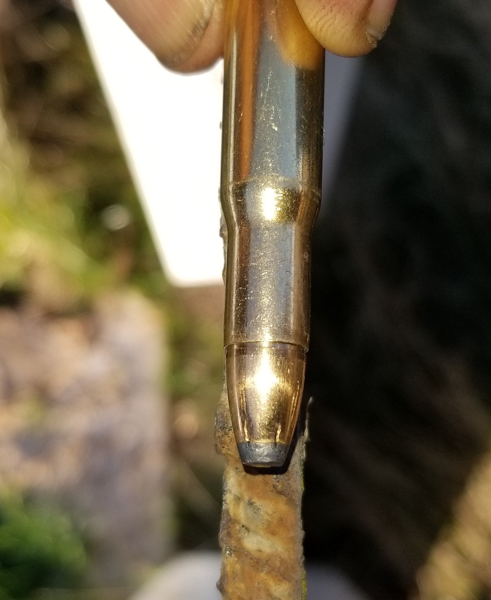

Then, for giggles, I fired one at a 410UB at 50m. 8mm steel web and it punched an impressive hole through it.

I would guess that you want to know the velocity for the same reasons anybody else would, including myself :-)
Have a look in the lid of your own boxes, I'm curious what else the stamp could refer to.

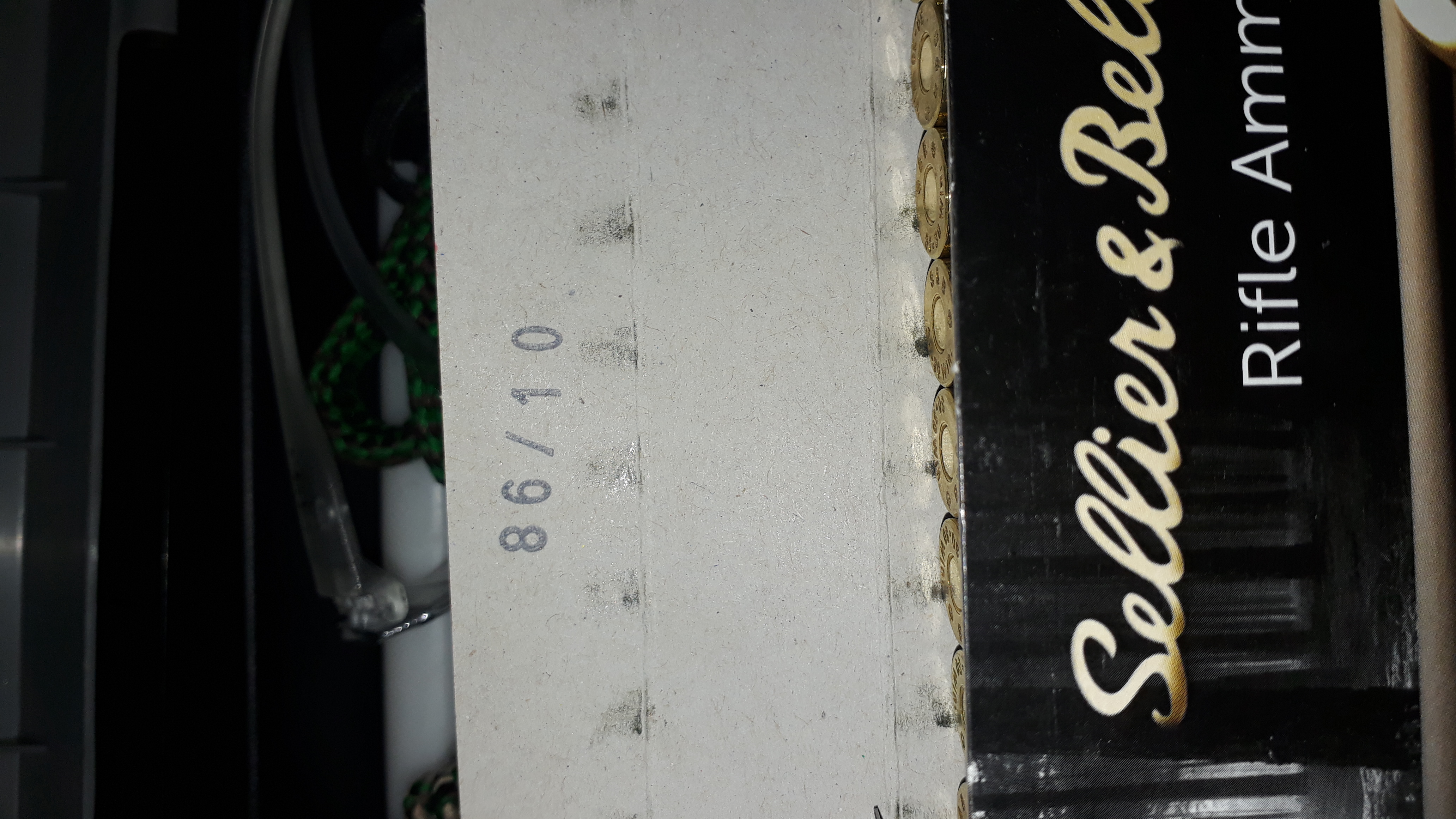

Wasn't expecting this...
Wow! That's pretty crazy :-)
I guess they did a massive run of .30-30 ammo back then.
