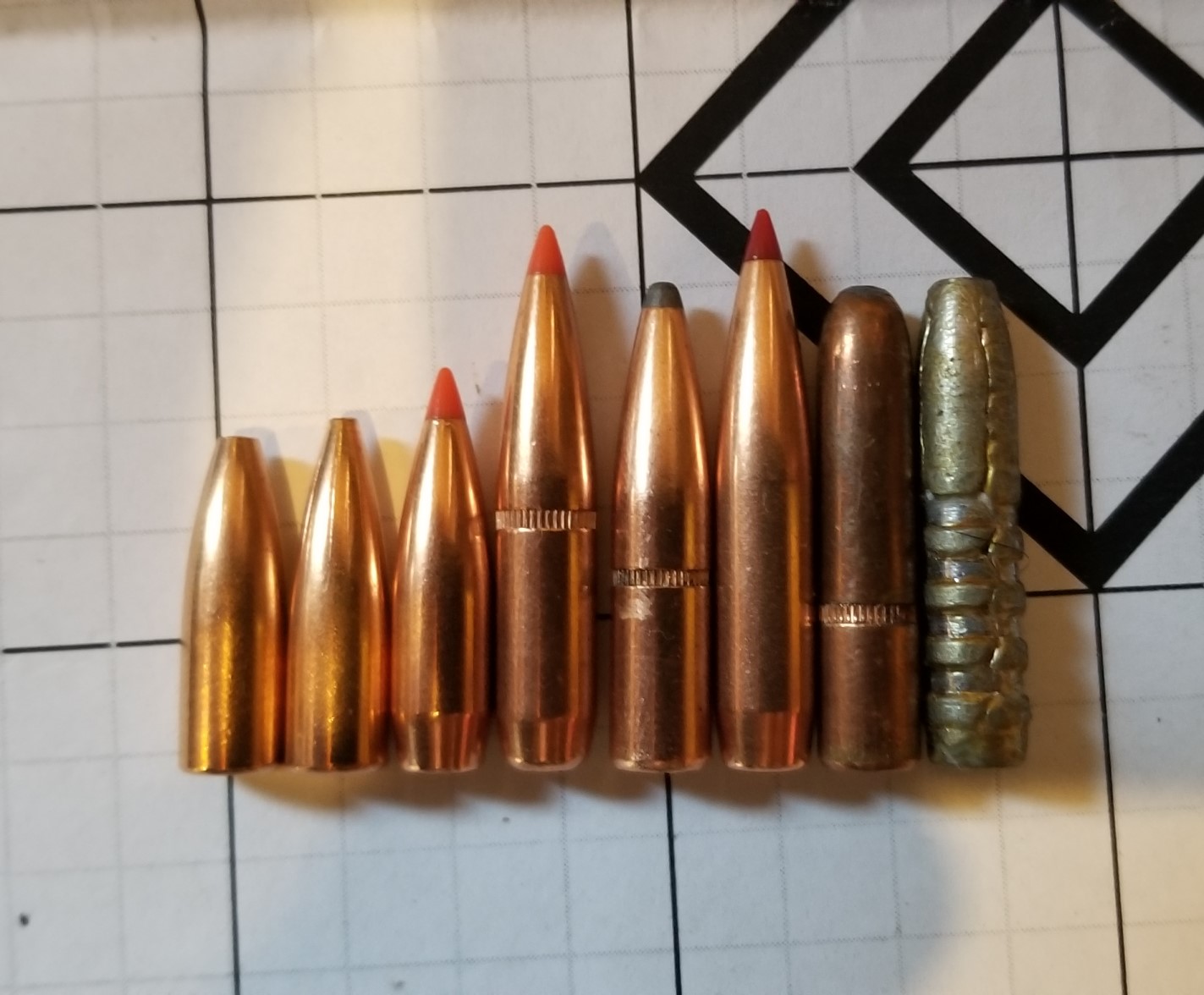

Heaviest I've used in my 6.5's is 170gn bullets.
85gn, 90gn, 95gn, 140gn, 140gn, 147gn, 160gn, 170gn.

Harrynsw wrote:
TassieTiger wrote:In that case - I’d look at the nosler hunting BT in 120gn...
http://www.gunsngear.com.au/nosler-65mm ... ectiles-50
Would it stabilise heavier options? I want to go as heavy as possible
Cool :wtf:
What are those 2 dildo looking projectiles on the right??
And what barrel length/twist rate you got going blade racer?

Harrynsw wrote:
Cool :wtf:
They are Hornady 160gn RN, very similar to the original 156gn RN bullet (bullet is the correct term for the specific type of projectile fired from rifles and handguns), and the cast Lee 170gn "Cruise Missile". I'm not aware of any bullet heavier than the Cruise Missile in .264".
My Swedish 18" M94/14 Carbine, 29" M96 Rifle, and 24" M38 Short Rifle all have the same 220mm twist rate as far as I'm aware, about 8.5"-twist.

Post by bladeracer » 20 Jun 2020, 2:57 pm
If you're interested in the Cruise Missile, this is where I got my mould.
https://www.midsouthshooterssupply.com/item/000066.5swed/6halfmm-swedish-170-grain-double-cavity-reproduction-mold
It throws bullets well over-size so you can size them down to suit your rifle, around .272".
