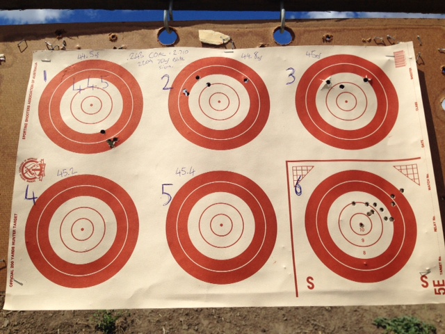

Post by 5Tom » 25 Mar 2014, 8:00 pm
Here is the target I shot on Sunday. It was at 100m and I numbered each target for each different load I tested. When I took this picture, it was early in the day and didn't take a photo with the results for all the targets. The Boxed target is .22.
So for target 1, I got a very good group with a bipod attached.
Targets 2 and 3 were with the bipod also, but I can't understand why it scattered like that compared to Target 1.
Target 4 ended up like number 2 and 3.
Target 5 was when I took the bipod off and got similar results to target 1 (maybe ever so slightly worse)

Post by Chronos » 25 Mar 2014, 8:26 pm
5Tom wrote:Here is the target I shot on Sunday. It was at 100m and I numbered each target for each different load I tested. When I took this picture, it was early in the day and didn't take a photo with the results for all the targets. The Boxed target is .22.
no offence mate but i'm not convinced the bipod is your problem.
you list loads as .243, 70gr blitz and 44.5gr of 2209. i'd suggest that 2209 is too slow for such a light bullet out of a .243 and this might be confirmed by your lightest load being the most accurate (and a fine group with one flyer).
The 6th edition of the ADI book doesn't list loads for 2209 until bullet weights reach 80gr and then load range goes from 38.3-40.7 grains. i'll have a look at some other books but have you considered using a faster powder? i'd consider 38-40gr of 2208 for around 3550fps
EDIT: I checked uncle nick's book and he lists a load for 70gr using 2209 of 43gr to 48gr so i retract my observations as it seems you're right in the middle of his load range (nick has been known to run some hot max loads)

Post by Apollo » 25 Mar 2014, 9:06 pm
Chronos, glad you corrected that.
Berger Bullets even list H4350 (AR2209) in their reloading manual as 42.00 - 46.70gr (page 449) and they are known for conservitive figures with powder. Anyway, load data is not the topic here.
Looking at the targets pictured I can't say that using a Bipod has anything to do with the results on paper.
What I would like to see on paper is one load, perhaps the first and a couple of targets shot under the same conditions and equipment then make whatever change was made and see what happens.
I think the intimation is there was an equipment change between the targets... I'd say keep everything consistant ie.. stick with the Bipod. They aren't that bad.
Apollo

Post by Chronos » 25 Mar 2014, 9:31 pm
Apollo wrote:Chronos, glad you corrected that.
I understand that the load is not the topic here and that the op only posted a photo of his first few groups but the first group is pretty good and as the powder charge went up the groups got worse.
I agree, pick a method and only change one variable at a time (powder charge)
It's possible there are other factors at work here beyond the bipod
Ive spent an hour going over three load manuals for .243 loads for 4 bullets from 65gr up to 95gr and have chosen to test 2208 for 65 and 75 weight bullets and 2209 for 85 and 95 weight bullets going off velocity and pressure numbers. I will also try two other powders if I get time.

Post by 5Tom » 25 Mar 2014, 10:17 pm
Here's a comparison between the initial load test and the most recent test.
The only difference here is that I used a bench rest for test 1 and a bipod for test 2. Same pill, same powder, same COAL, same primers and the same batch of cases. Test 2 was supposed to narrow down on the best charge given the results from test 1.
Test 1 - Bench rest
.243 2209 70gr blitz test.JPG (107.28 KiB) Viewed 15049 times
44.5gr shows tight group without bipod.
45gr shows 3 shots extremely tight with two flyers as the barrel got hot.
Test 2 - Bipod
.243 2209 70gr blitz ripley 2.JPG (147.42 KiB) Viewed 15049 times
44.5gr with bipod and results are identical.
45gr (exactly the same in Test 1) and it's ******.
5Tom

Post by Apollo » 26 Mar 2014, 9:04 am
I think you said from target #1 the first shot was the flyer, In the other target with 44.5gr which shot was the flyer. What I'm getting at here is to see if you can get rid of the flyer and make the groups really good and consistant.
Anything can cause a flyer other than first shot out of a cold clean barrel so before trying again fire a few shots to foul the barrel before attempting your groups then try your groups but keep a note of which shot creates a fly if any. Don't know how many cases you have in your batch / rotation but if you can see when the flyer happens I would grab that case and put it to one side and keep it out of the main batch and reload them as a seperate lot next time. Don't know if you have weight sorted your cases and or bullets but that's what I do amoungst other things and I rarely if at all get a flyer shooting target. I take my time weighing powder to ensure each load is as exact as I can get using a Balance Beam Scale. I don't like or trust digital scales of any description.
My new cases once fired are US cleaned, dried and tumbled then I weight sort them from lightest to heaviest in one batch of say 100 - 150 in progression and kept that way for my target shooting but if you also use them for hunting / varminting it's a little difficult to keep them in order. Might sound strange but after I reload a batch I will then use my digital scales and quickly check all loaded rounds to see if they pretty much agree in weight and if one has a noticable difference I put a texta mark on the head of the case and note how it performs.
If your main use after you do this load development is hunting / varminting then I would concentrate on seeing where your first cold shot lands and sight in for that since that will most likely be the main event you will encounter out and about in the field, group placement with a warm bore then doesn't count.
Not knowing your main purpose out of all this I hope some of this helps. My .243W is a Tikka T3 Varmint with Single Set Trigger which has been highly modified and trued since it is also a "switch barrel / stock" to a target rifle 6.5x47 Lapua calibre.
As a .243W I have three main loads depending on my usage planned. I use 55gr Nosler Ballistic Tip, 80gr Sierra Varminter Blitz and 100gr Sierra GameKing at this stage. The later two will in future be combined and swapped to 90gr Berger Boat Tail Target Bullets (suitable for Varminting too).
I've rattled off too much, sorry.

Post by 5Tom » 30 Mar 2014, 7:23 am
I'm actually thinking of modifying the bipod by cutting into the bar that limits the extension of the legs, then inserting some soft cork to add some buffer. That should allow the legs to be fully deployed and then when "loaded", the legs can over travel from its original position rather than flexing the legs.

Post by MR. WINCHESTER » 01 Aug 2016, 5:50 pm
I ( mostly ) always used a bipod during my 'bunny busting' years and never felt that doing such, compromised accuracy.

Consistency is the key to precision. Point of impact will change from position to position, with bipod, without bipod, preload, no preload..... Do it the same, shot to shot, with a decent rifle and you should keep plugging the target, be it paper or prey.
Re: Shooting with vs without Bipods.
Post by Browning » 01 Aug 2016, 6:27 pm
Mates and I shoot of a bipod all the time at the range and in the field and all our rifles shoot groups that you'd be happy with any day of the week....
I reckon there's factors other than a bipod that are having a greater influence on groupings...
