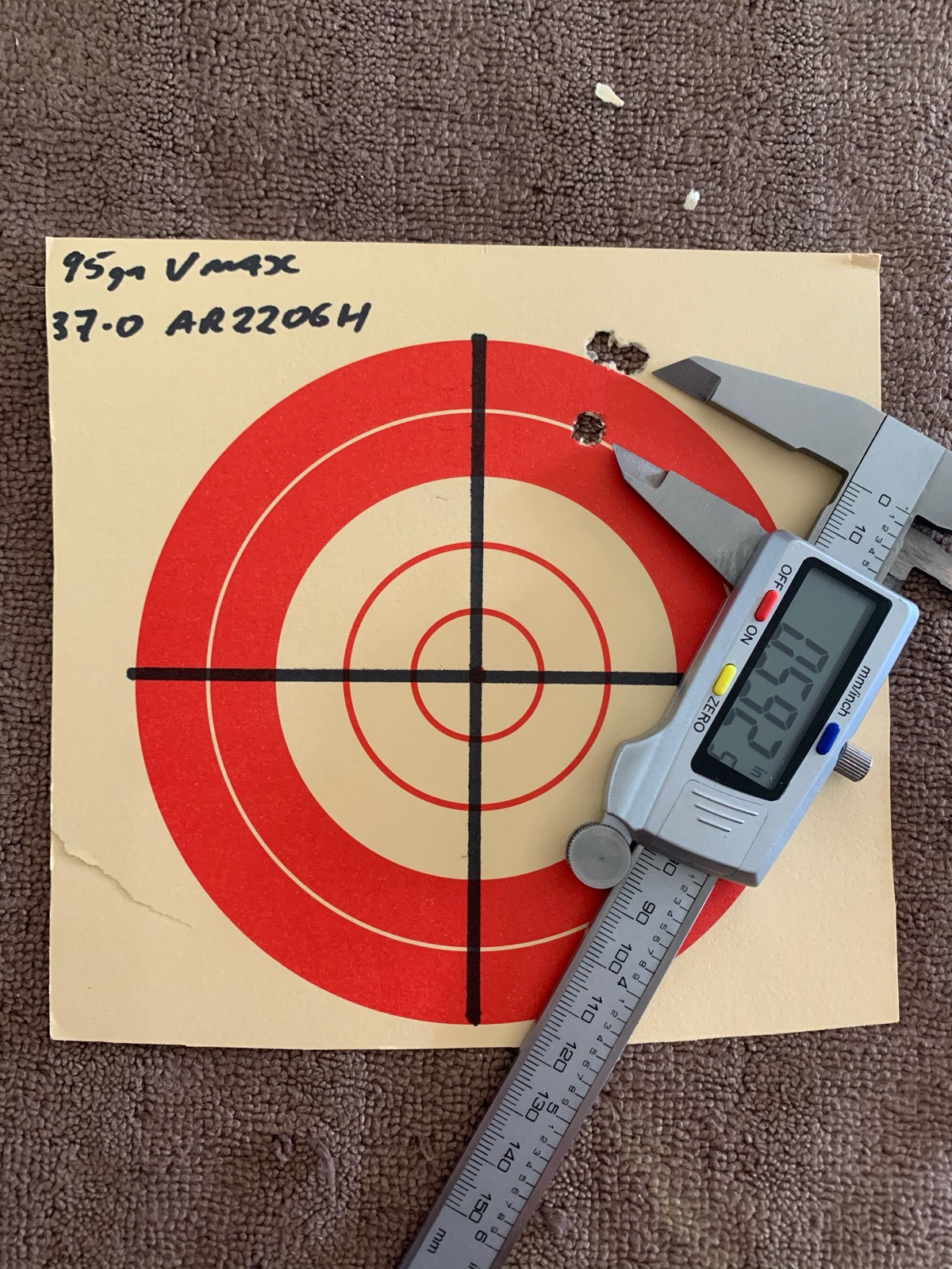

Post by JimTom » 24 Dec 2020, 6:10 pm
Mate I tried some 95gn Vmax out of my creedmoor using AR2206H. The best group was 0.6” @ 100m, however I found the groups didn’t have the consistency of the heavier projectiles in the 140gn range.
Not exactly what you were after however I hope it helps.

If it helps the barrel is 24.4” and is a 1:8 twist.

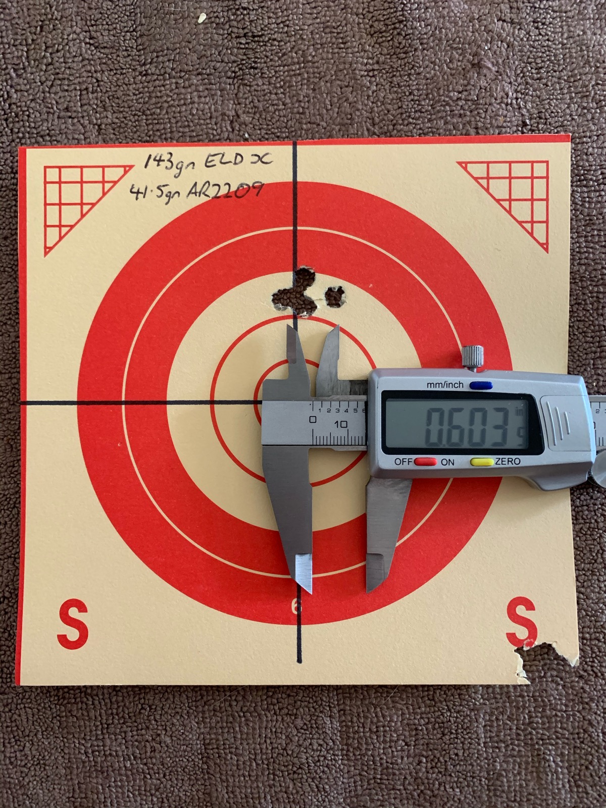

Post by JimTom » 25 Dec 2020, 1:53 pm
Just to show I am not making it up mate. These were shot at 100m, only a three shot group for the 95gn Vmax, and a five round group for the 143gn ELD X. Pity I pulled that last shot or it would have been a good group.

When I originally purchased my 6.5 I had envisaged using it as a longer range shooter so experimented with the 95gn Vmax for dogs etc.
It is now used exclusively as my night rig for pigs so I mainly just use the 143 ELDX.

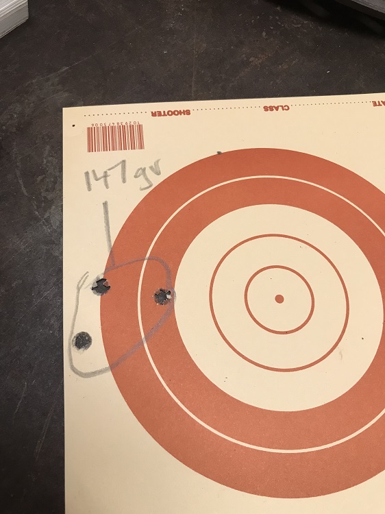

Post by Pedro » 30 Mar 2021, 3:51 pm
My 6.5 x 55 shoots very nice groups with hornady 123 gr with 2206H low recoil, It also likes 140 gr with 2209 much the same size groups then to really get me scratching my head hornady 147 gr with 2209 don't group that good @ 100 but @ 200 are great

Post by SCJ429 » 30 Mar 2021, 6:39 pm
What size groups are you shooting at 100 that come good at 200? 1\4 inch at 100 and 1\2 inch at 200?

Post by Pedro » 01 Apr 2021, 3:31 pm
147 @ 100
147 gr @ 100.jpg (123.13 KiB) Viewed 28657 times

Post by SCJ429 » 01 Apr 2021, 7:08 pm
So you shoot groups over two inches at 100 metres and then you can shoot 1\2 inch groups consistently at 200 metres?
Unfortunately poor groups at 100 result in poor groups at 200 metres. Has the rifle ever shot a decent five shot group at 100 metres and then followed up by shooting a five shot group at 200 metres roughly double the size. For example, I can shoot groups with my 6mm around the low 0.2s at 100, then shoot around 0.5s at 200 and then I am lucky to shoot under an inch at 300 metres.

Post by Pedro » 02 Apr 2021, 8:19 am
i have just bought this rifle ( new ) and in the process of developing hand loads for it with 5 shot loads consisting of 123 gr 2206h 130 gr 2206h then 140 gr 2209 147 gr 2209 will post other pics later. No tall stories here just amazed at the results, and hoping to get an understanding of what members thoughts are and if anyone else has experienced this. An employee @ sth side brisbane gun shop has explained to me that the barrel of a rifle expands and contracts as the projectile moves through the barrel and upon exiting is unsettled then in flight with wind resistant's against it settles it down. Could this be possible in the nano second between 100 and 200 ??
I total get what your say SC and agree with you.
