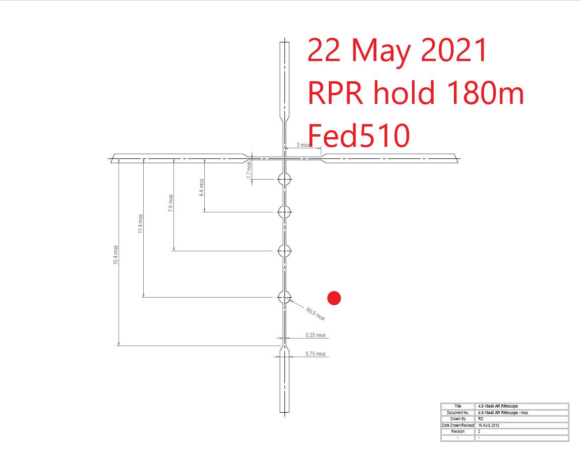

Yep, particularly as you significantly change bullet weight and/or velocity. Sometimes you have to play with the secondary load a bit to hopefully get it vertically below your primary load. With large game, a minute or two to the side isn't a big deal, that's why you zero with the precision load. Barrel harmonics play a role in that the position of the muzzle when the bullet exits can be different by a few thou, due to a different velocity or bullet weight travelling rapidly up the barrel while spinning at a couple-hundred-thousand RPM.
I was shooting Federal 510 .22LR at 180m on Saturday, and it was hitting four-minutes to the right of my CCI Std Velocity zero in the RPR. Same bullet weight, but one doing 1070fps, the other doing 1260fps. No wind at all, as in the wind meter wasn't moving at all - very rare out here :-)
This was my hold on the chicken at 180m, aiming for the junction of the right side of the leg with the bum.
