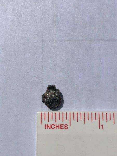

Post by Bello » 04 Nov 2021, 9:41 am
Hi
Below are two pics of a 140gr Sierra Game changer (270 calibre) I dug out of a deer shot between 100 meters and 200 meters.
The projectiles were very accurate out of my 270. Just nothing left of the bullet.
I think the Hornady SST are the same in regards to being a little on the lighter side of construction. Possibly better past the 200 meter mark.
I found the Hornady SST and Sierra Game changer to be accurate, and did the job.
These are just MY personal observation, if it helps anyone.
For my 30-06 I am going to give the 165gr partition a wirl :thumbsup:
