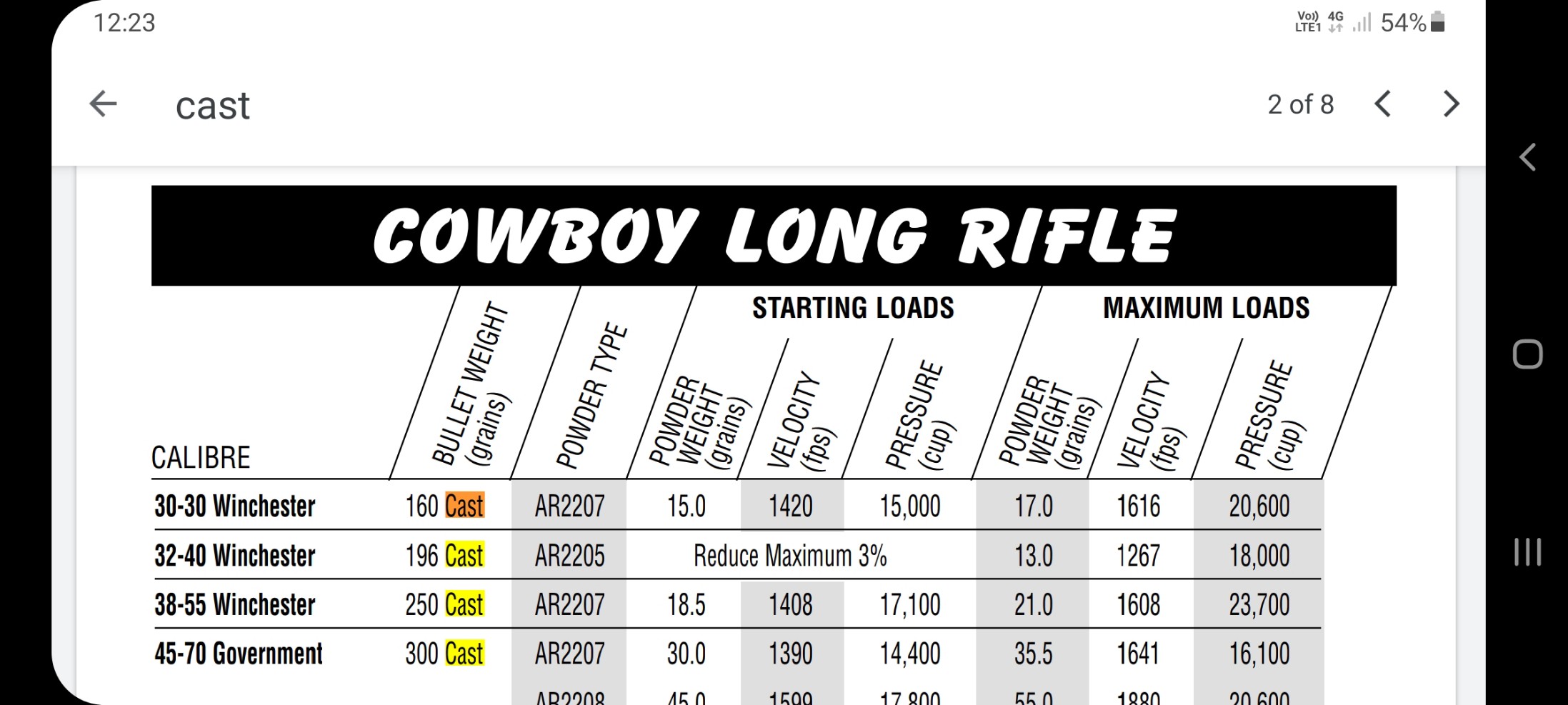

Post by Oldbloke » 29 Nov 2021, 11:27 am
From the 3rd Ed 2000 ADI manual.
Re: cast bullets
Post by flashman » 04 Dec 2021, 5:43 pm
Thanks all good on the ADI powders then ,is Trail boss worth getting as well ? Its a cowboy action powder i gather ....

flashman wrote:Thanks all good on the ADI powders then ,is Trail boss worth getting as well ? Its a cowboy action powder i gather ....
Grab it if you can find it, there's not much you can't load with Trailboss, but it does have a velocity ceiling in the "reduced" realm, particularly in larger cartridges. Light bullets in .204, .223, .243 and such can exceed 2000fps on Trailboss, but it's difficult to get most of the bigger stuff over 2000fps.
Basically, I would grab any Trailboss, AR2205, or any AP/AS/APS powders you can find, it isn't being made currently.

Post by Hardcast » 19 Mar 2022, 3:18 pm
Do you want to try casting for the sheer enjoyment, or do you just want to shoot cast bullets. ??
There's a few Cast bullet manufacturers out there who make a good product. Most though are too hard for hunting. Black Hawk from Hawksebury River Cast Bullets is one.
My 30.30 loved the cheap Lee mold. 160 grn. gass check. My 30.06, the heavier Lee, 180 or 200 grn. The Lee, Liquid Alox lube will do fine.
Send a message if you run into trouble. There's a lot to learn. Cast loads are not quite as forgiving as jacketed.
