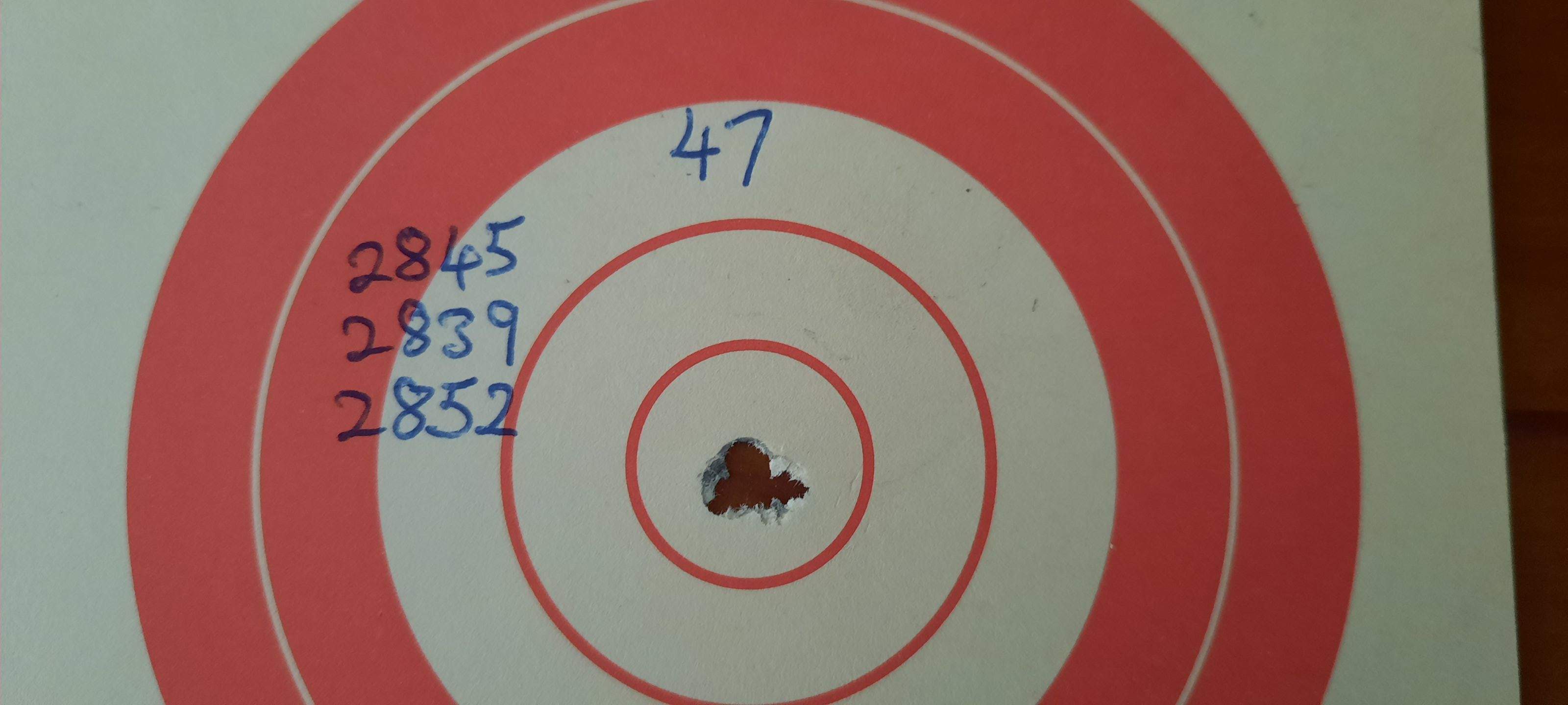

This is the 100 metre group with the Creedmoor barrel. Disregard the velocities, they were mistakenly written in for the 46.5 grain load. Bartlein barrel 26 inches long, Win case, S&B LR primer, 47 grains Re26 and 140 ELDM at 2.810" OAL.

Can't complain about that but how does it do from 600 onwards is the key
