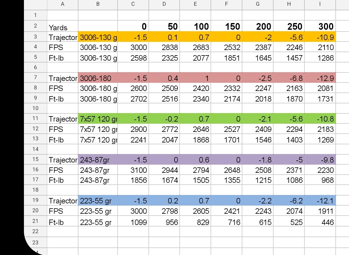

I did a comparison a few years ago. Frankly, for hunting purposes not a lot of variation out to 300mtrs.

Agreed, I don't understand why anybody would say the .308 has a poor trajectory.

Post by Oldbloke » 01 May 2023, 1:56 am
308 is a great round.
30.06 is betterer tho. :allegedly: :lol:
