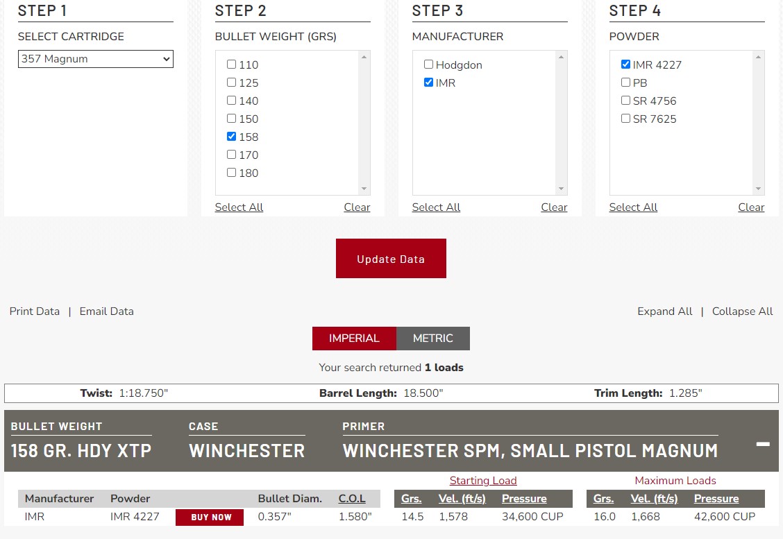

I can only see a single load listed by Hodgdon.
Screenshot 2023-05-03 204519.jpg (123.96 KiB) Viewed 2199 times

Post by bigrich » 03 May 2023, 8:57 pm
thanks for that blade, i've been on the net looking for data , and depending on the source, it varies a bit . older speer data for 4227 powder is hotter than the hodgen load you just put up . and i'm finding hornady data to be really down played . i guess cause of all the 100 year old plus winnie 92's that get converted to 357 . paco kelly talks about action strength on older guns being not that good with modern preasures . i was going to work up from the mild side and watch for signs , but getting some first hand experiences from others on this forum would be advantageous :thumbsup:

Post by No1Mk3 » 03 May 2023, 10:00 pm
IMR list a load of 16,3g of 4227 to give 1600fps in a carbine, it is listed as MAX, 35000cup and compressed load.
