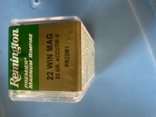

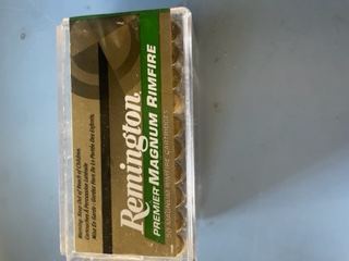

Post by Bello » 31 Jul 2023, 4:12 pm
Hello Waimo
Some years ago, I used to own a 22 magnum, and I found the ammo I tried wasn't too accurate in my rifle.
I tried a number of various types and weights of bullets, and none seemed to have any real consistent accuracy in my rifle.
Then I came across some Remington, Accutip-V 33gr. They were a premium bullet, they seemed to shoot better in my rifle.
But and there is always a BUT....they were very expensive.
It was cheaper for me to use 223 than the 22WMR.
So, I sold my 22 Magnum.
