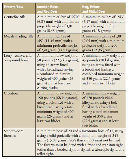

Post by Oldbloke » 06 Sep 2023, 12:50 pm
This Qn comes up often.
Your in tassie, but in Vic there are minimum requirements. Therefore:
308
30.06
270
They are popular for a reason.
Very available.
Legal all species
Cheap components for reloading.
But there are other options as previously mentioned.
For fallow, load a lighter bullet if your worried.
Min Deer Cartridges New.JPG (78.3 KiB) Viewed 13402 times
