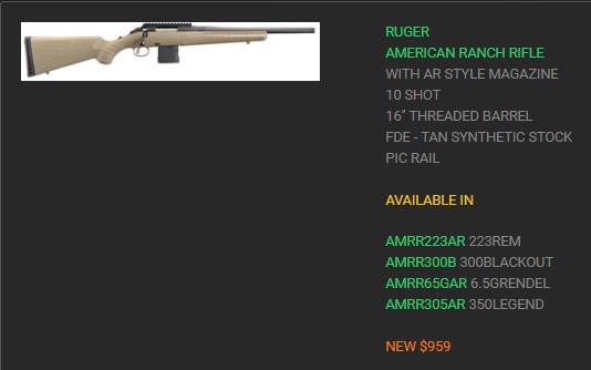

Cactus wrote:Fair point Larry , do you know off any with a 10 shot mag , And a 18 inch barrel . Looking at a short action also . There is no doubt that the .243 would be an awesome round ( I have a Brno in .243 ) looking at something more compact
Ruger American Ranch Rifle maybe - 16", 10rd, 6.1lb, short-action?
https://ruger.com/products/americanRifleRanch/specSheets/36926.html
Screenshot 2023-12-08 133847.jpg (23.48 KiB) Viewed 17554 times
Could drop it into an MDT LSS chassis using AICS mags if you wanted to.
Do you mean a mini-action? The short-action is .308Win length but is more versatile, even for .223.
I've read through the thread and it seems to me you just need a common cartridge, like .243 or 6.5Creedmoor, and download it to the performance level you want. No mucking around at all and everything cheap and readily available. And both fit the short-action. Personally, I would avoid a rimmed cartridge in a bolt-action.

Bladeracer that is my 300 blk rifle which I find perfect for my shooting. That’s why the thinking of getting into the 6.5 Grendel but as mentioned before unless I buy factory brass for it , I will not be getting great velocity out of fire formed x39 brass .
