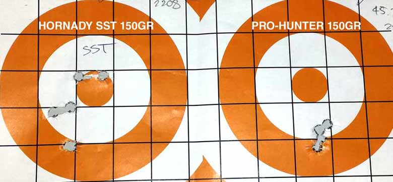

I've found flat base Sierra's to be the best bullet by far in my Ruger Hawkeye. Whether or not that's due to the increase bearing surface I couldn't say for sure, but the results speak for themselves.
Here's a picture of some of my load testing...
sierra pro hunters
Hornady 150gr SST's (boat tail) on the left, Sierra 150gr Pro-hunters (flat base) on the right, both at 100 metres.
Had similar or worse results with half a dozen other boat tails before trying the Pro-Hunters. Haven't bothered trying any others since they shoot so well. Haven't done any testing at longer ranges to share with you unfortunately.
Anyway, hopefully that's of some help to you.

...and that's in .308 Win.

Decent group, stringing out a bit quick there though?
Hot barrel, or shooter factors?

Post by Lorgar » 02 Sep 2013, 9:02 am
Redwood wrote:Decent group, stringing out a bit quick there though?
More my fault than the rifles at that point I'd say.
I'd been at the range for a few hours testing a dozen different loads and was a bit over it by then, lol.
Those two loads/groups were the last pair of the day, and from memory I shot the Pro-Hunters very last thing.
By then I was just pumping out the rounds for the last few groups one after the other without giving it time to cool down at all.
I've loaded up a bunch more handloads using the Pro-Hunters with 0.1 gr increments on either side of that load for fine tuning.
Will get to the shooting range some time in the next couple of weeks and see what's best.

Lorgar wrote:By then I was just pumping out the rounds for the last few groups one after the other without giving it time to cool down at all.
You should be in for some good results by the sounds of things if that last group was shot while hot.
I'm reasonably new to reloading so still working through my hand loads to fine what's best, but I'm getting about 50% more spread than that, and more random too. Nothing in a straight line like that.
Looks good to me :)
