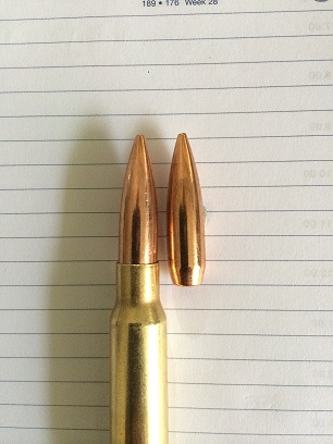

Hope this photo is clear enough. My seating depth. The Bullet Bearing Surface Length into the Case Neck is 0.150" .

Post by cruze82 » 21 Jun 2014, 5:08 pm
ok same pic to show how deep in the neck it is

Post by Chronos » 21 Jun 2014, 5:19 pm
cruze82 wrote:ok same pic to show how deep in the neck it is
or isn't :lol:

Post by Apollo » 21 Jun 2014, 5:29 pm
Now that IS a shallow seating depth and in my opinion not usable.
Think I'd go a bit further but not much, depends on your purpose. The way you are describing things it sounds like it's more target than anything else. If target then all you need is to hold that bullet at the seating depth off or in the lands that provides the best accuracy. Concentricity then becomes a matter of achieving the best consistant accuracy amoungst other sorting practises.
