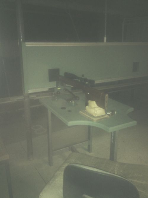

Post by jennageit » 11 Sep 2014, 6:18 pm
Hi Apollo,
I'm open to ALL suggestions and hints.
Looking back at what I did last night, compared to my first and second shoot, although the score was lower, I feel like I'm getting the hang of it.
As for hunting, I wont be going hunting until I can almost guarantee (as much as I can anyway) that I will only need one shot to kill whatever I'm shooting at. Of course, life doesn't always work like that, but if I can't be positive of getting the good shot in, I'll wait for another opportunity.
I went shooting with my dad when he was shooting roos, and we found 6 roos that had been shot and not killed. Dad put them out of their misery.
So, feel free to give advice, tips, etc etc
I've included a pic, sorry about the crappy quality, of my setup last night before I started shooting.
Jenna

Post by veep » 11 Sep 2014, 10:00 pm
Which range is that?
What's with the funny little windows? :lol:
veep
Posts: 197
Re: Two "no go bang"!!!
Post by jennageit » 11 Sep 2014, 10:08 pm
It's Leongatha Small Bore Rifle Club, and the little hole is where you shoot through.
Jenna
