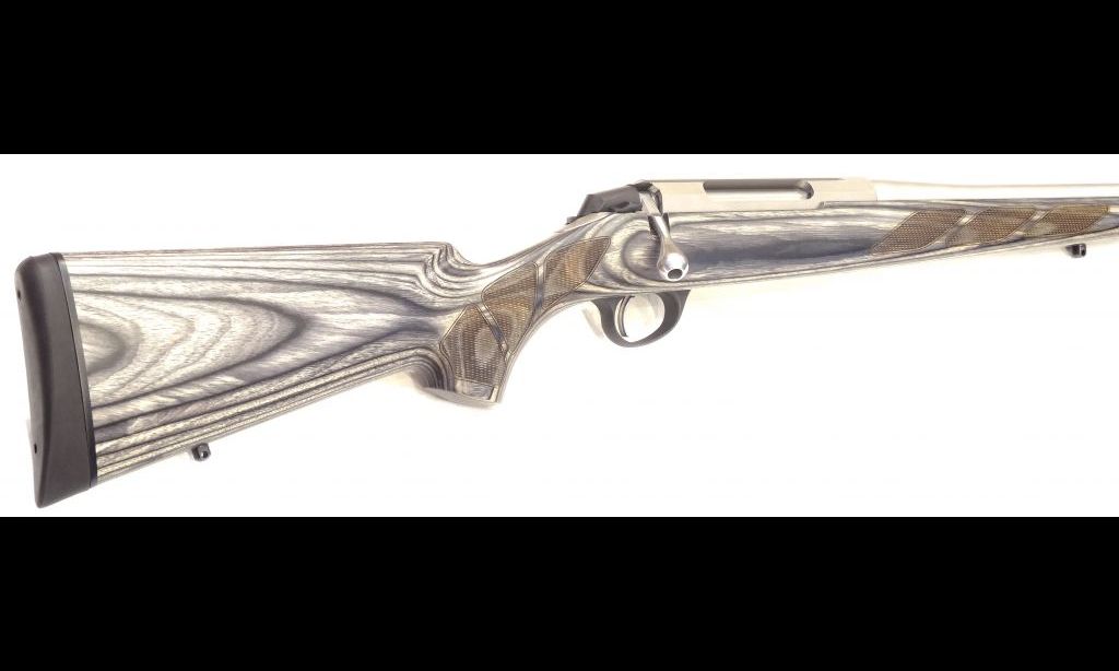

Post by Stoney » 25 Apr 2018, 4:09 pm
G'day fellas, I have just agreed to buy a second hand old model Tikka T3 Stainless Laminate in .223 that has had no use from a bloke I know at a very good price. Problem is I have no idea what twist rate it is. I don't have the rifle in hand yet. Question..... Is there any markings, or way to tell on the rifle what the twist rate is? I understand Tikka offered two twist rates with these rifles? Cheers. The pic is what the rifle looks like. The newer T3x? have different checkering it seems.

Re: Best rate of twist for a .223?
Post by pomemax » 25 Apr 2018, 4:41 pm
its stamped on the barrel 223 rem space then a number 8 or 12 or what ever just went and checked mine is an 8

Post by Stoney » 25 Apr 2018, 4:47 pm
Cheers pomemax. Thanks heaps for that mate.
Stoney
Posts: 411
Post by JimTom » 25 Apr 2018, 4:56 pm
From memory it is stamped on the barrel of mine.
Post by Stoney » 25 Apr 2018, 5:00 pm
Yes, I just txted the seller and it's an 8. That's exactly what I wanted. To be able to shoot the heaviest projectiles. Thanks you good bastards.
