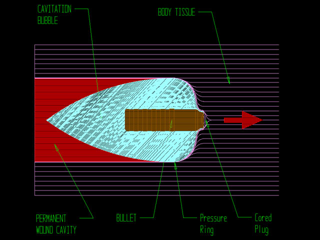

In short creates a huge wound channel while maintaining the direction of travel. Channel picture from their website.....

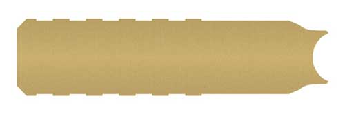

And there is "the depressed nose" shown in a bullet cutaway

Post by Jack V » 04 Mar 2015, 5:33 pm
That wound cavity is an artist impression not a photo of an actual fired bullet entering ballistic gel .
Jack V
Posts: 692
Re: Hydrostatically stabilised bullets
Post by Norton » 05 Mar 2015, 12:51 pm
Obviously.....

Norton wrote:Channel picture from their website.....
Nice and symmetrical when going through a computer simulation :lol:
I think I'm with the general consensus here on it being mostly fancy talk. Once it's going through various materials at different angles, sinew, muscle, bone, fat, I'm sure they deform and course is influenced must the same.
