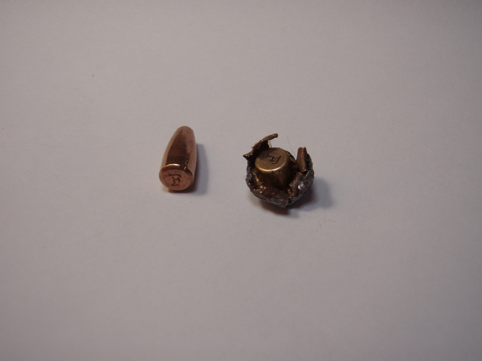

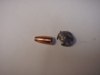

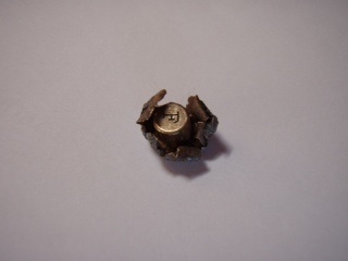

Gents just to demonstrate effectiveness of these hand swaged projectiles.
Here is one I pulled out of a wallaby, ( under permit ). Range was just over 150m. It was recovered from just under the skin on the opposite side of entry.
They were fired out of a K-Hornet at about 2900f/s
The jacket was made out of Federal cases .22LR cases as they have a slightly thicker wall thickness but can be a bugger to swage. Federal .22LR cases tend to vary in initial case weight and therefore the new jackets need to be checked for weight after trimming to length. More expensive brands of .22 ammo do not vary as much but have thinner cases. There always seems to be a trade off somewhere!
The cores were not bonded to the jacket. If you look closely at the last pic you can see the firing pin indent at 1 o'clock on the new projectile.

Post by BBJ » 12 Jan 2014, 10:31 am
I gotta say, I'm impressed with the weight retention in that.
That last photo could be from a bullet magazine advertisement.
