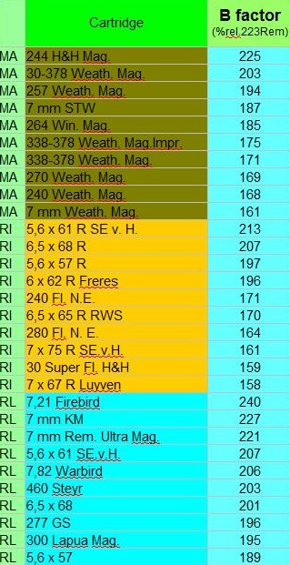

b factor marirl.jpg (101.9 KiB) Viewed 8367 times

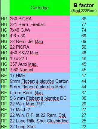

b factor hgrf.jpg (70.61 KiB) Viewed 8367 times
Some interesting observations;
The 375H&H and 460Weatherby are 103 and 98 respectively, ie. damn close to the 223 (100).....
The 308Win has a B factor of 96... so a bit less volume relative to the little Rem...
The awesome 310 Cadet has a B of 30...... and its Sambar Legal in VIC!!! :shock:
700Nitro scores 100.... its the 223 of 70cals!! :lol:
22LR = B of 15
500S&W B=42, 460S&W B=48....
In case you're wondering SE V.H. means Super Express vom Hofe

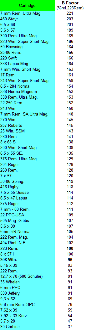

Listing of common rimless rounds, these are the one most recognisable, note this excludes magnum rounds;
b factor rimless common.gif (23.21 KiB) Viewed 8332 times
Yep, the 7mmRUM is up there!!
