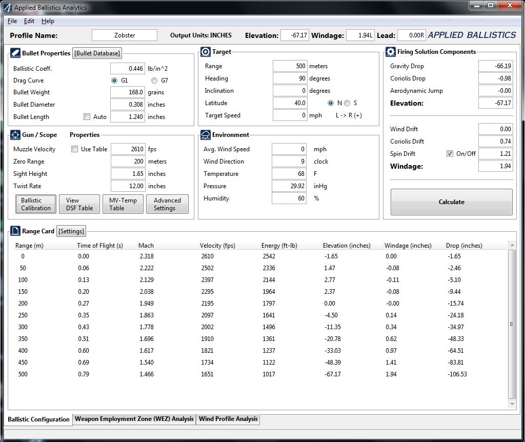

Post by brett1868 » 11 Jun 2015, 11:04 pm
Table below based on some research and assumptions. Good out to 500m, I can re-compute and post longer distances if you like. Chronos is pretty well spot on the numbers, first x around the 20m mark then 2nd at 200m. 200 hold dead, 100 aim 2.77 inches low. Elevation in this app is backward to me as it is giving the elevation of the projectile rather then what you need to dial into the scope. Test out the numbers and let us know how close they are, though if you want a more accurate plot then the round needs to be run over a chronograph and the appropriate wind / temp / humidity etc etc entered.

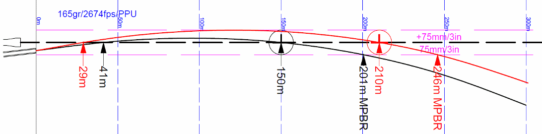

Post by 1290 » 12 Jun 2015, 12:05 pm
Time for some 'visuals' fellas, this is based on the ppu data for the 165gr 308 load, purely graphical. I have superposed the adjusted +/-3inch MPBR trajectory on to the stated 150zero traj.....
You can see the first trajectory cross, it would be less/closer if the scope mount height was lower than the 50mm (ppu stated). If you're using this MPBR of 246m, the zero would be 210m.
If you plug in the data and manage to fit it to the ppu info, you may get differing results :ugeek: :thumbsup:
