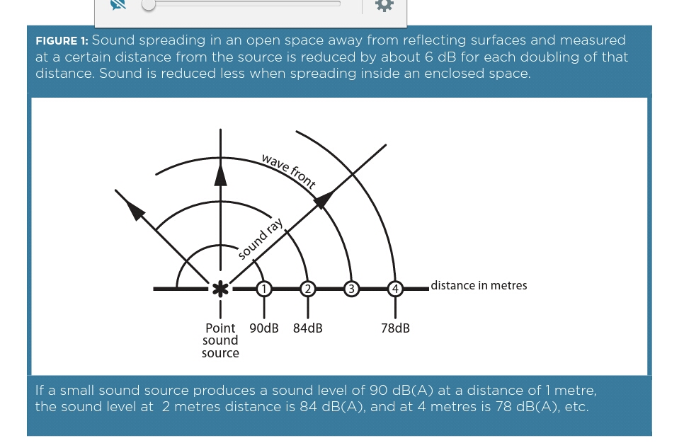

There's probably a way of calculating the degradation of the sound pressure level at a distance....maybe that what your thinking.... :thumbsup:
<<Genesis93>>
Posts: 2190
Re: Muzzle pressure and decibel level?
Post by Oldbloke » 24 Apr 2016, 9:20 pm
db reduction over distance.jpg (242.45 KiB) Viewed 8098 times
Sound reduces by 6db for each doubling of distance.
