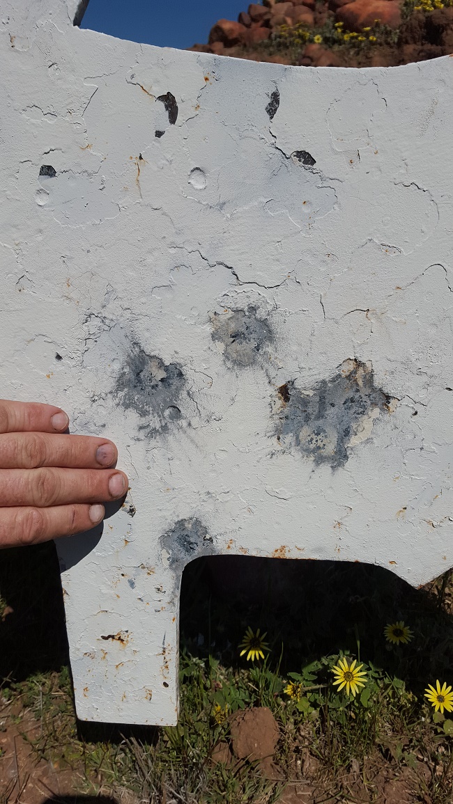

In my experience, and I shoot thousands of cast bullets a year in my lever guns, even coated bullets shoot better with lube.
There is an argument in black powder circles as to whether paper-patch bullets, which have no lube grooves, shoot better than grooved bullets. I shoot lubed, grooved bullets and can get sub- minute groups at 500m with them. I only know a couple of fella's personally that shoot paper-patch and have spotted for them shooting and they don't seem to be able to get better results with their non-grooved bullets.
Pic: 5 shots @ 500m with 410gr grease grooved bullets.
ram group.jpg (383.86 KiB) Viewed 4411 times

Gamerancher wrote: Pic: 5 shots @ 500m with 410gr grease grooved bullets.
Is that with our without patching?
(And good shooting :thumbsup: )
Xerox
Posts: 178
Re: Cast lead lube grooves and ballistics with powdercoating
Post by Gamerancher » 05 Oct 2016, 8:42 am
When you say patching, do you mean cleaning between shots? Answer is no, used blow-tube.
