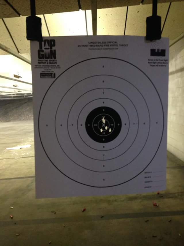

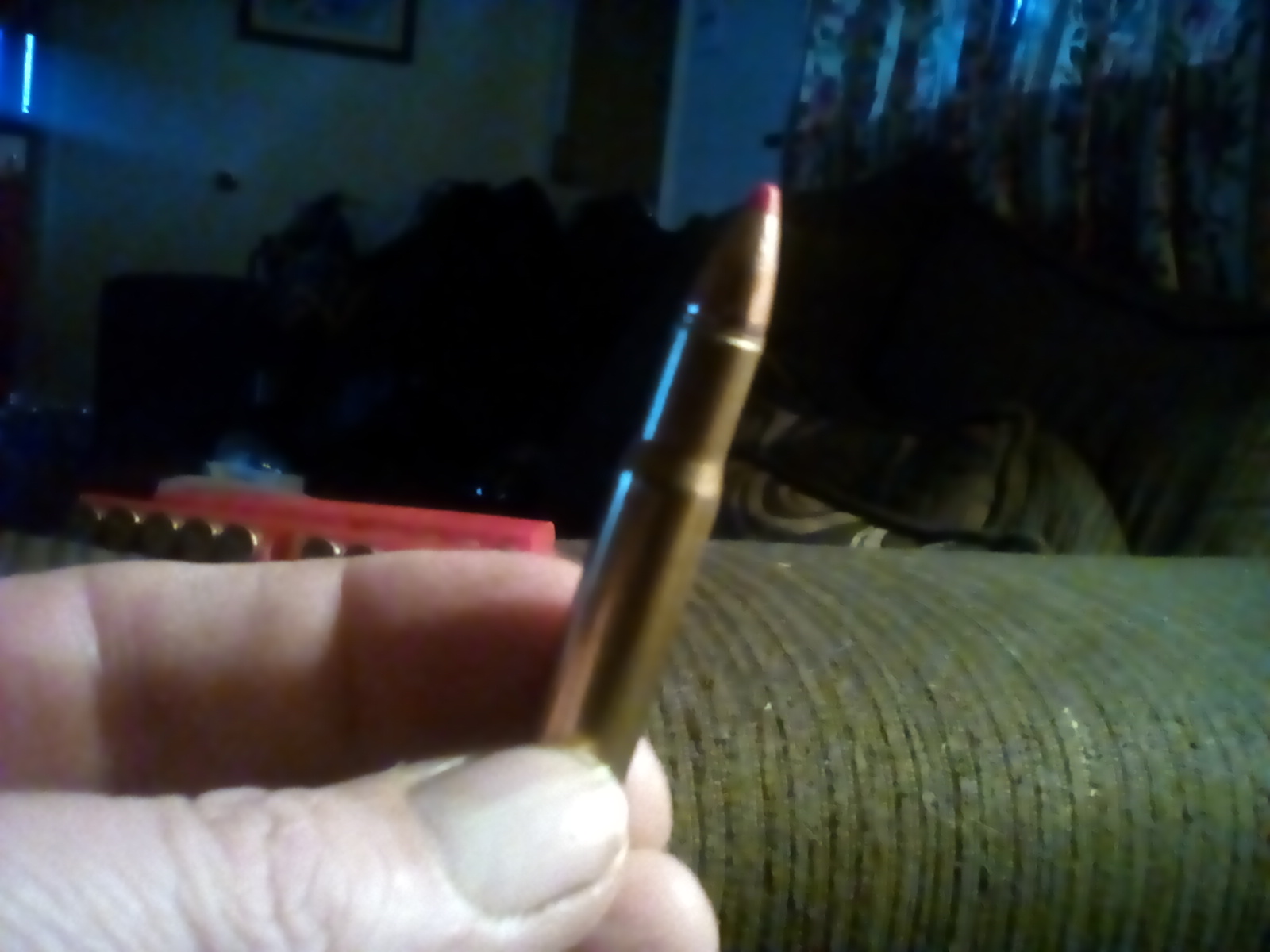

160 grain hornady flex tip this was just 25 yard indoor range but it looks like i will be makeing more

Is that the hornady Leverevolution pill?

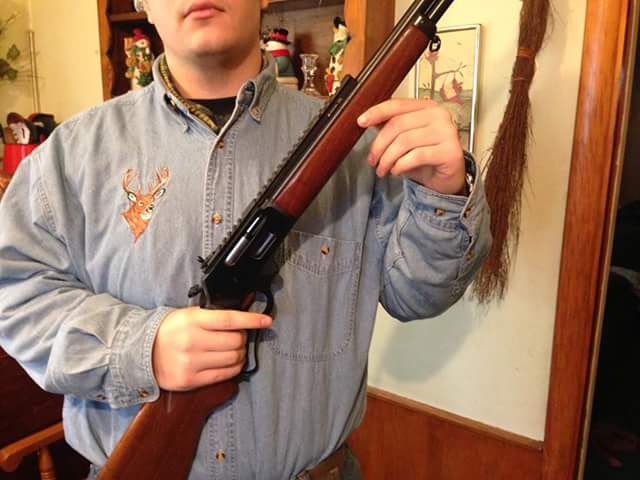

peep sight we were useing imr 4064 30 grains that was a 2inch group my son did the shooting we could not bench for better groups .
it is the leverevolutuion pill this was the gun and set up

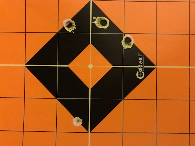

Those Hornady FTX pills shoot o-k, and (for jacketed projectiles) weirdly they are among the cheapest at my LGS. I guess they shoot slightly flatter than classical FP pills (theoretically) but there's not much in it at all; mainly more a marketing gimmick by Hornady IMO. I suppose they might retain stability a little better than classical FP pills at 400m+ but the 30-30 isn't really fast enough (or heavy enough pills) to effectively be used as a long range plinker anyway. But at closer ranges the FTX pills are definitely no more accurate than many classic 30-30 pills; for example check out this 3-shot group I coincidentally shot only this morning (100m, iron sights):

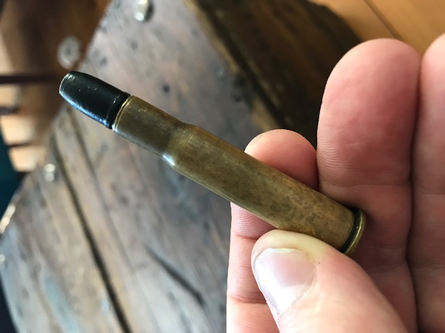

That's pan lubed cast lead over 16gr AR2207 (equivalent to H4198):
That's pretty standard for my 336 - with just the right load it's about a 2 minute rifle; it prefers heavier pills over lighter (~170gn) I cook them for about 20c each and they kill things don't you worry about that - excellent expansion.
There's a lot of misconception about lever gun accuracy unfortunately.
