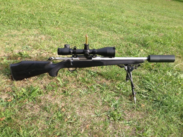

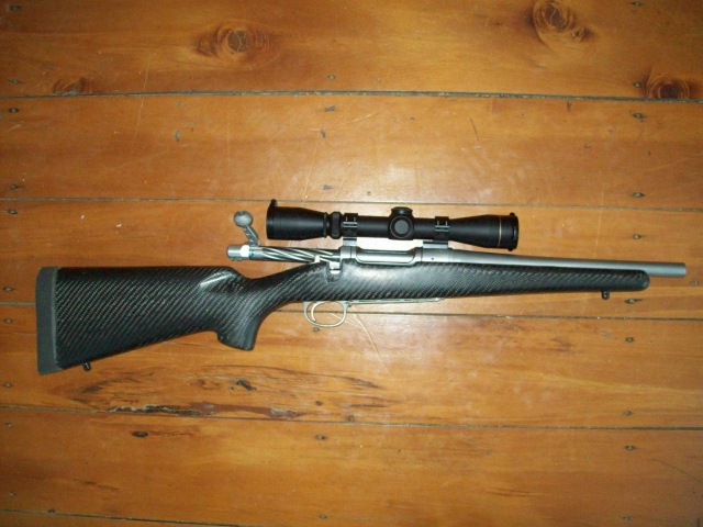

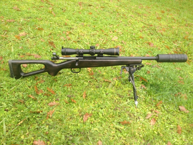

Been mucking around with the 450 BM for a few years, mainly in bolt actions, lately in a couple of AR15 uppers.
Great wee round tons of punch & generally pretty accurate both sub & supersonic.
A few rifles Iv'e built here
These both have 12" barrels & McMillan stocks.
The first one is a T3 Tikka, for supers & maybe subs.
Kimber 84M actioned 450 Bushmaster

Another one

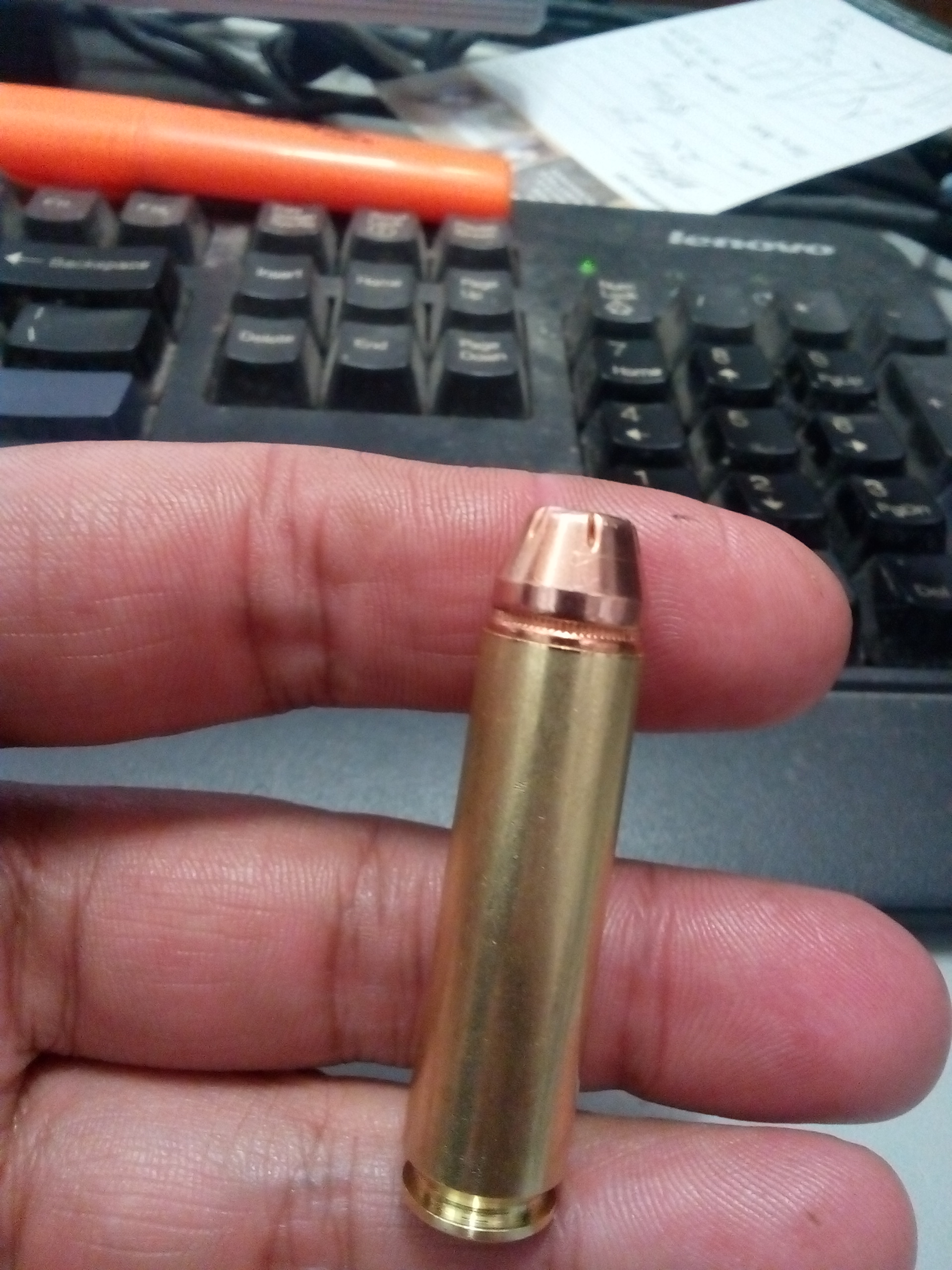

A recent victim of the AR15 with 275 TSX.
