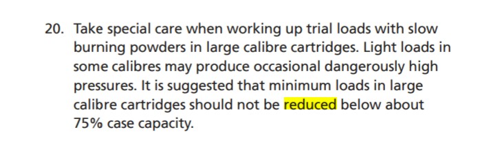

This subject often comes up so I will just post this from the adi loading manual.
reduced loads .jpg (39.15 KiB) Viewed 13132 times
