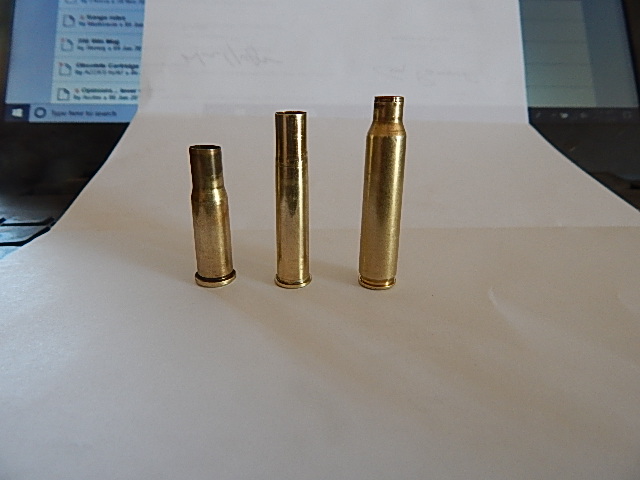

You can still buy 222 Rem mag brass so I would hardly call it an obsolete calibre. The one I have just finished making brass for is the 25-20 Single Shot which is a completely different cartridge to the 25-20 Winchester and which required me to make a major set of forming dies. I also make a lot of other old/obsolete cases and a lot of my wildcats are very complicated like my 22-44. If you have the skill set and enjoy frustrating and tedious jobs then it is very rewarding, If not get the barrel set back and chambered to 223.

25-20 Winchester on the left, 25-20 Single Shot centre and a 223 on the right.
