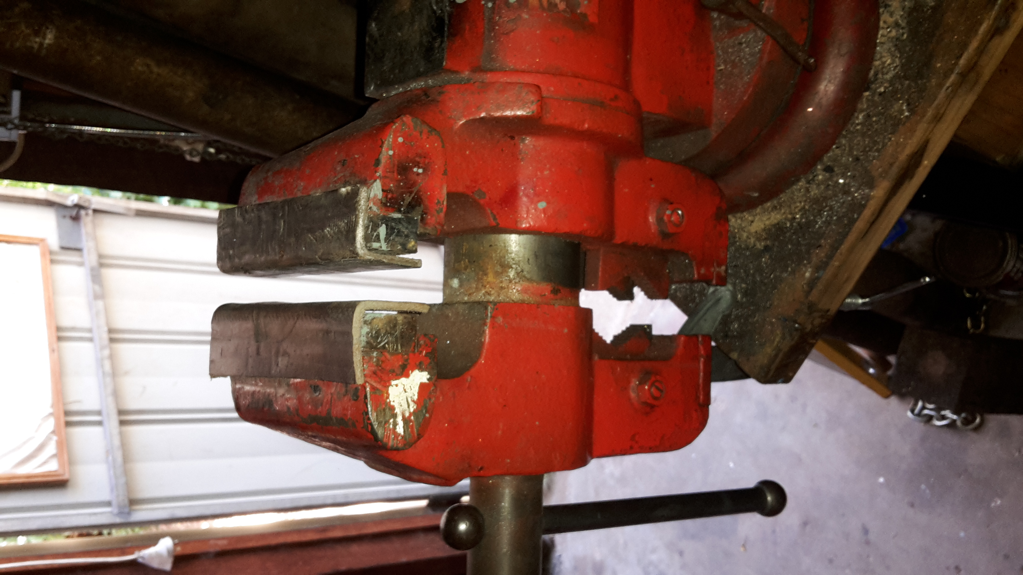

I need to punch out dovetail front iron sight and replace it with a new one...
I am wondering what would be the best way to grip the rifle in heavy iron vise? Any suggestions on what I'd need, like rubber or plywood to insulate from metal to metal contact, etc? Seen a YouTube video of people using both, wondering if anyone else has suggestions?

Wrap the barrel in electrical tape, get some polyethylene (polypropylene?) jaw protectors from Bunnings or eBay. Or use some thick card board. Make sure the rifle is supported so it's not leveraging in the vice.
And lots of wd-40 on the sight , 10 mins before you touch it.

I hold my rifles in a vice regularly.
I've made thick leather slips to put into the jaws. They work great.
I just do the vice up firm with one finger and check that the rifle won't slip by applying a little pressure on the comb.

vice no, lay the rifle flat on the bench and make up a block of wood with a V in it and put it directly under the front sight where you're going to be working. i think the dovetail is tapered, be careful. if you drive it the wrong way you'll open up the dovetail and the new sight may be loose. maybe measure the new one and work out if one end is wider
like this but just a block of wood, you don't want to be punching the front of the barrel with the rifle in the vice nearly a meter away. have a search on youtube, theres a few vids on them

Think I'm just going to go with plywood. Just cut to size to fully cover the vise jaws. The block (above) looks alright, but it was designed to punch pins out, which is a bit different to drifting a dovetail.
Other option is to make a V shape oversized block. But, that would require me to hold the barrel with one hand which is not ideal. I'd like to have two hands free for the task.

I have "soft jaws" same as leather ones above, but made out of a sheet of lead, also a set made out of copper. Pretty standard item in a metal work shop.

I've made jaw protectors, got everything setup, gave it some Inox for good measure and NOTHING! Been banging on this bitch (Browning BL-22) for a while with brass and plastic punch - nada! Switched to big hammer! The way I was holding the punch, there's no way it get's to the barrel, knuckles yes, barrel no. Anyway, I can't see if there's been any movement, but it doesn't look like it. So now I am thinking of maybe manufacturing a sight removal tool, seems easy enough. Damn it! You Tube makes it look easy (albeit no videos of BL-22).

So I took the advice. Changing the Marlin sight was easy. But BL22 just wouldn't move. While at it, sighted in Marlin with Skinner front sight and had to move the elevation receiver sight all the way up, otherwise it was shooting too low, so it too is in the shop, getting front sight trimmed. Anyhow, 1. good learning experience. 2. I feel so empty, like that feeling you get when you forget your phone at home, only heaps worse. I didn't even feel that way when I left my little terrors with a sitter for the first time. My girls belong at home, not in a workshop :(
