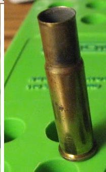

Hi guys, this case is a 357 max, neck down to 30 cal with a 30-30 style long neck!
Could a gunsmith cut a chamber with a 357 mag reamer and finish of with a neck reamer?

Post by Tripod » 02 Sep 2016, 6:07 pm
No.

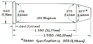

You would need a custom reamer, The reamer needs to cut the base dimensions. If you found a 357 reamer you could get it machined for the neck.
Why such a long neck? Anything over one caliber is a waste, As in the neck only really needs to be .300 long for a 30 cal to keep the projectile correctly aligned with the bore. Plenty are made shorter to give more powder room but no advantage in going longer.

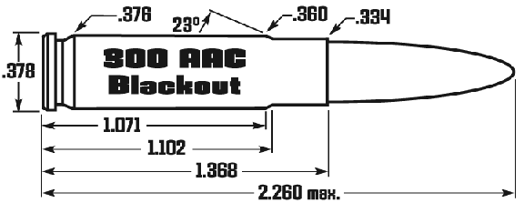

if you went a shorter neck its almost a rimmed 300 blackout. have seen reference to them being cut with a standard 300 blackout reamer then counter-sunk for the rim. 357max brass then sized in standard blackout dies.

If the chamber can not be cut as suggested the first way, then could it be cut by running a 357 mag reamer slightly short,
followed by running inside that 357 mag chamber to a greater depth a 300 black out followed by a neck reamer to extend the neck?

That can work if the smith cuts the rim recess as a separate step and if he doesn't mind pissing around doing an extra 2 steps. Just got to remember after all the smithing is done you still need a set of fls dies. If you want I can pm you a few more idea's that can be done cheaply and easily.
