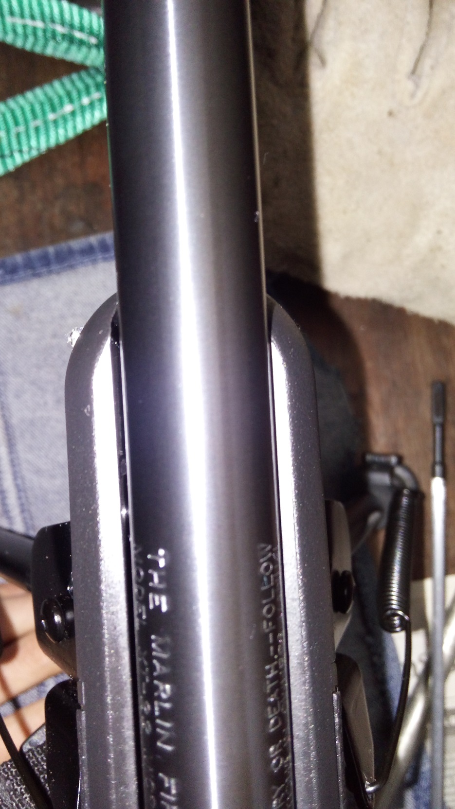

Ok so brought a marlin XT22 a month ago. Used open sights just to fool around, put a scope on it to get a bit more accuracy out of it.
Went to sight it in and couldn't get a good group for the life of me. Cleaned the gun tried again same problem. Tried several types of ammo nope no success.
Noticed the barrel cocked to one side at end of stock. When you remove the barrel and action from the stock you can see the stock is pushing against the barrel rather then just touching it.
I'm convinced by free floating it i will see great improvement, would others agree this would be my problem?

It feels like its wedge against stock the barrel does move away minimal with a fair bit of force. I tried loosening the action bolts but no win.
I hope to fix it cause the best i could do was a 3 inch group at 25m. Pretty pathetic.

Not good group. Remove the action and have a close look for burs or lumps in the stock that would be forcing the action out of alignment. Just a few thousand of an inch near the action will push the barrel out of alignment by 3 or 4 mm at the forearm tip. And it could be at front or rear of the action.
I wouldn't free float it until you get the barrel aligned/straight as it should be first. Once you get that right try 5 or 6 or more different brands of ammo.
If it still won't group then consider free floating. Some barrels like upwards pressure and some like free floating.
If all barrels liked free floating that's how they would make them.
I have four rifles and all have acceptable accuracy /groups and only one is free floated, the others have upwards pressure on the barrel.

I took barrel out of stock again today no burs but it looks like at the rear of the action (barrel being the front) is a tight and the front of the action is a tight fit.
I drew a diagram with yellow being action, red being the barrel, black being the stock and blue arrows showing interference.
I feel as if i removed some plastic from front or rear of action this would bring the barrel center. I have few more types of ammo to try before i go messing with it to much including CCI but run out of time today.

Relieving the I letting walls in those two areas is where I would start.... but I would then bed the rifle properly!
Be very careful when relieving these areas. Take a little off each area evenly and refit. Repeat if necessary. Take it slow.
Unfortunately these are the pitfalls if new rifles; especially ones in cheap synthetic stocks. Even timber stocks suffer. A friend bought a Zastava 22lr a couple of years ago and the in letting needed a bit of a touch up to improve accuracy.

This looks like the problem. Relieving the letting walls in those two areas is where I would start.... but I would not bed the rifle until this is fixed and a few brands tested first. Once fixed it may not need bedding.
As G said remove small amounts at a time and try and repeat as required. Less is more. G is a bit bedding crazy. True good to bed but if it shoots OK why bother.
I'm not sure what the best method of removal, perhaps fine emery paper or file. Less is more.

It looks like a synthetic stock if so does it have a V block or any pillars?
I wouldn't waste any ammo until you have it sorted. The barrel definitely looks as if it were made to be a free floating type.

If you are handy with hand tools, a PROPERLY sharp chisel will just slice nice little slivers off where you need to relieve. If not, a sharp blade, like a Stanely knife or scalpel, used perpendicular to the plastic surface, will scrape it back nice and gently. Do not use the knife to cut, use it as a side scraper.
All going well, you won't need to bed it but, you know, why not!?! :unknown: :drinks: :lol:
As Sungazer says, the stock definitely looks like it was meant to be floated.

So after some free time, I was able to test some more brands only slight improvement.
I took a little plastic off the stock in a couple of places and we are winning.
I went out today and shot a 13mm group @ 50 metres with out trying too hard.
I can probably get better out of it but I'm happy with that, I brought it as a bunny gun or some entertainment when camping. It was cheap and you get what you pay for in the end.
