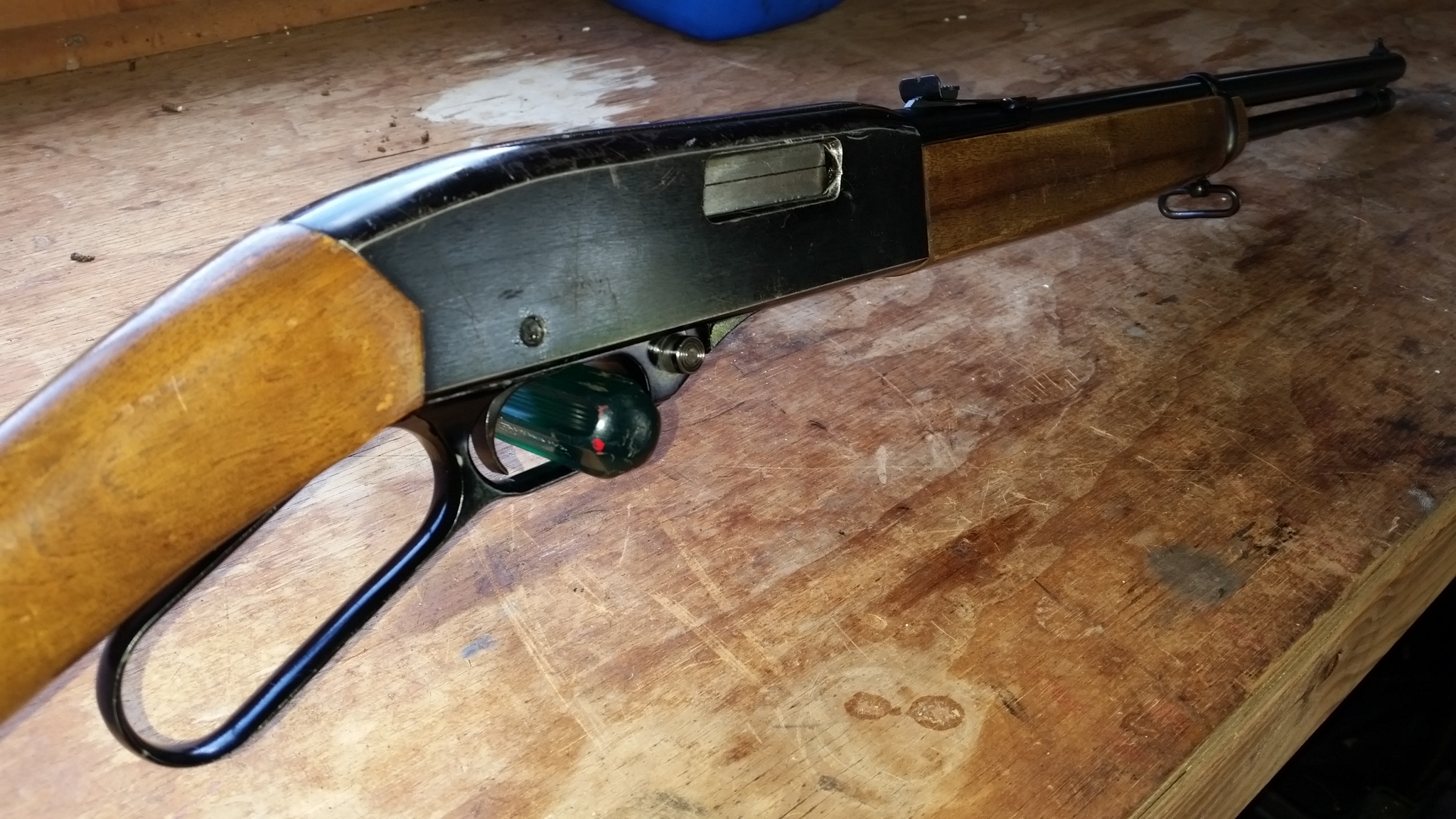

Hi folks.
I recently purchased a Winchester Model 150 from an interstate seller of one of the online gun sales sites. I know these rifles were never the greatest, nor really popular, but I once had one many years ago and simply wanted to replace it because I just loved using that rifle at that time. The rifle was advertised as in good condition and so I paid probably too much for it once the included permit and funds to dealers at each end are included.

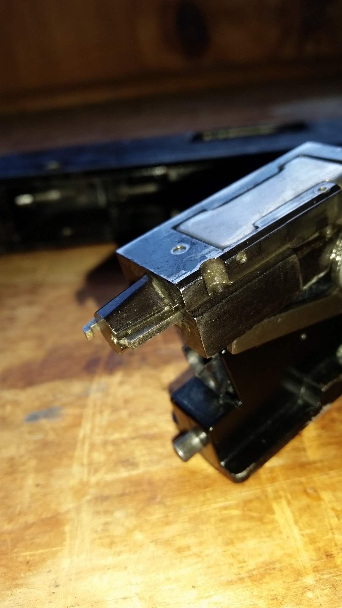

Anyway, the rifle is now mine and it seems what one seller's idea of good condition is not the same as another purchaser's expectation. The rifle has a broken firing pin and the chamber is carved out from dry firing. As parts are no longer available unless imported from the US, my local GS was willing to manufacture the firing pin, but told me the rifle was not repairable due to the damage to the chamber edge. He said it would most likely cause case ruptures and blow-back.
At present, the rifle neither chambers, nor extracts correctly but I think this has more to do with the missing piece of the firing pin not supporting the left side of the cartridge.
I'm after any second opinions, particularly to whether the chamber is repairable. I don't think a simple swage will fix it either. See photos included.
Any and all help will be greatly appreciated. Cheers.

Can't see that it's worth the trouble. I'd imagine the barrel would need to be removed and rechambered. Likely to be a costly exercise as I suspect the barrel is a press fit but that's just a guess.

If you wanted to spend the money it could be fixed. Numrich has the firing pin and the barrel could be lined.
I think contacting the seller and trying to return it would be your best bet. Was it an individual or a shop?

It was a private seller, so no chance of returning it unfortunately.
The barrel has a barrel nut attaching it to the receiver so the barrel could be replaced if I ever found one in better condition.

You could get the barrel relined if it comes off easily.

If the barrel can be removed there is no reason it can't be turned back and rechambered. It will just cost you a bit.

Gwion wrote:If the barrel can be removed there is no reason it can't be turned back and rechambered. It will just cost you a bit.
Or put some weld in and file back to shape.

I had the 190, semi-auto version. Excellent rifle.
I would try some epoxy to fill the chamber damage and see how well it shoots.
The firing pin is a fairly simple matter of cutting it out of some steel plate, filing to size and shape, then tempering.
Or buy it from the US for about A$40.
