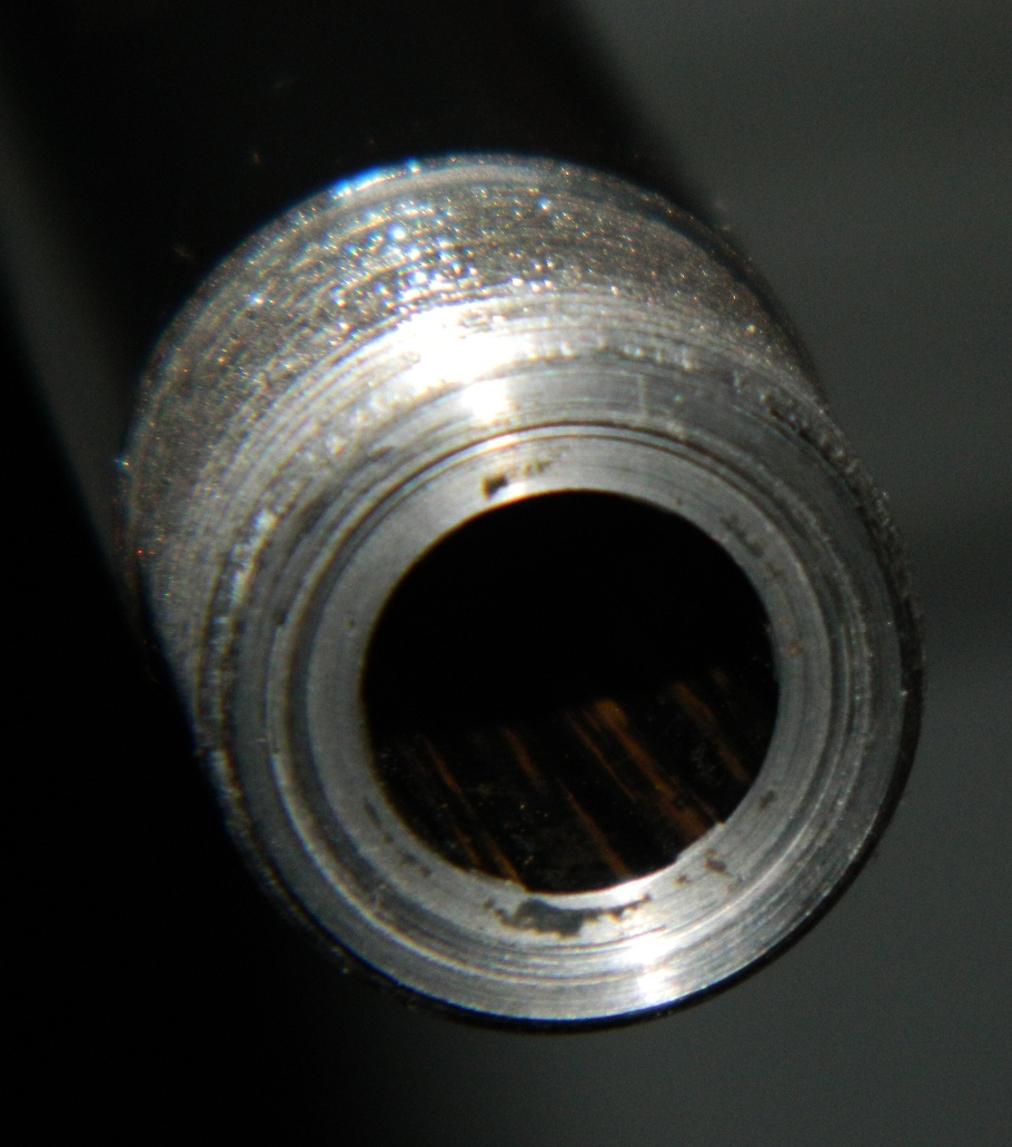

Zobster, what I generally do is to cut a muzzle thread that is as close to muzzle diameter as possible.
The main reason I do this is, IF the barrel has not been properly Stress Relieved, it is best to cut as large a diameter thread as possible!
What can happen, is if the barrel has not been properly stress relieved and you then machine it down from say 5/8" muzzle diameter to cut a 1/2" diameter thread, the Bore of the barrel at this point (the muzzle), can actually expand out a couple of thousands of an inch at this critical location! NOT A Good Thing!!!
So what I do is cut as large as possible muzzle thread, and machine a shoulder flat at the very end of the barrel, for the Brake or "Can" to butt up against!
Here is a grubby example (half cleaned off carbon etc and Anti-Seize compound on thread) of what I'm talking about, on a standard Rem 700 muzzle (M-16 x 1mm pitch thread).
.308 Win, Rem 700 muzzle
Also, please note how I cut the Crown of the muzzle and also, the Copper bore fouling in the bore.

Here's another image of the same muzzle and a better image of the Copper fouling etc....
.308 Win Muzzle.

Post by zobster » 06 Jan 2016, 3:02 pm
Homer wrote:G'Day Fella's,
Hope that helps
