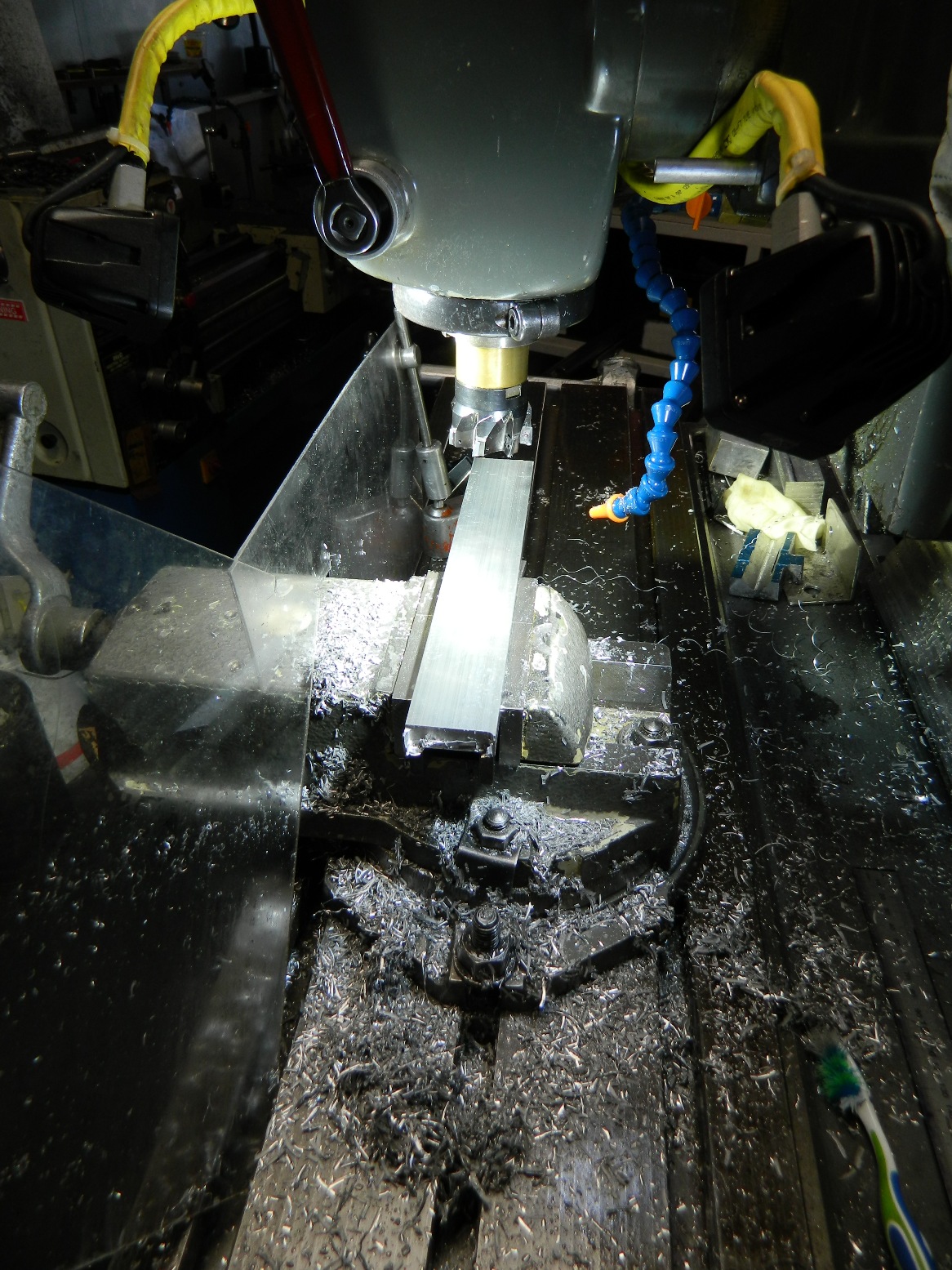

Here is the end of the shape and profiling machining;

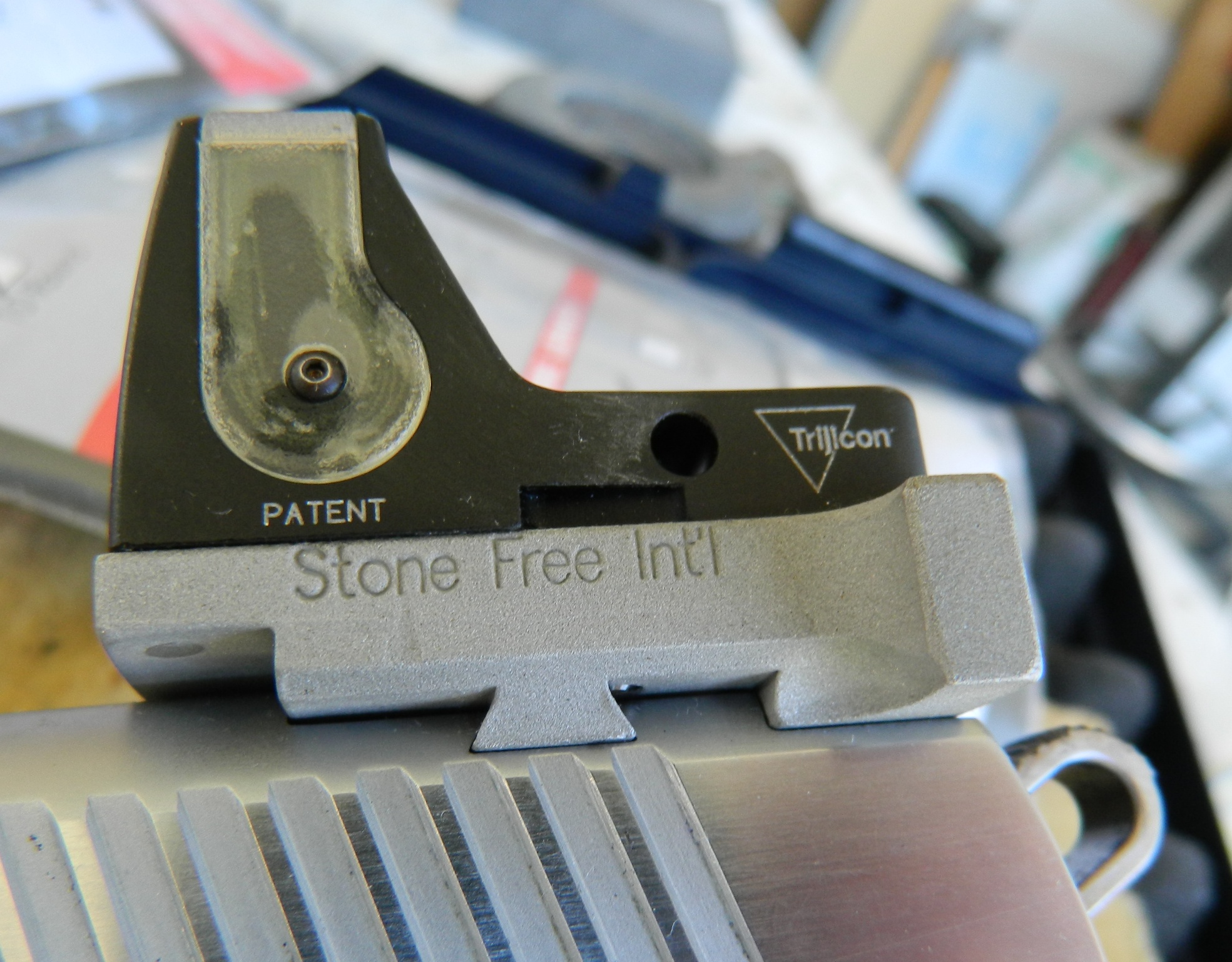

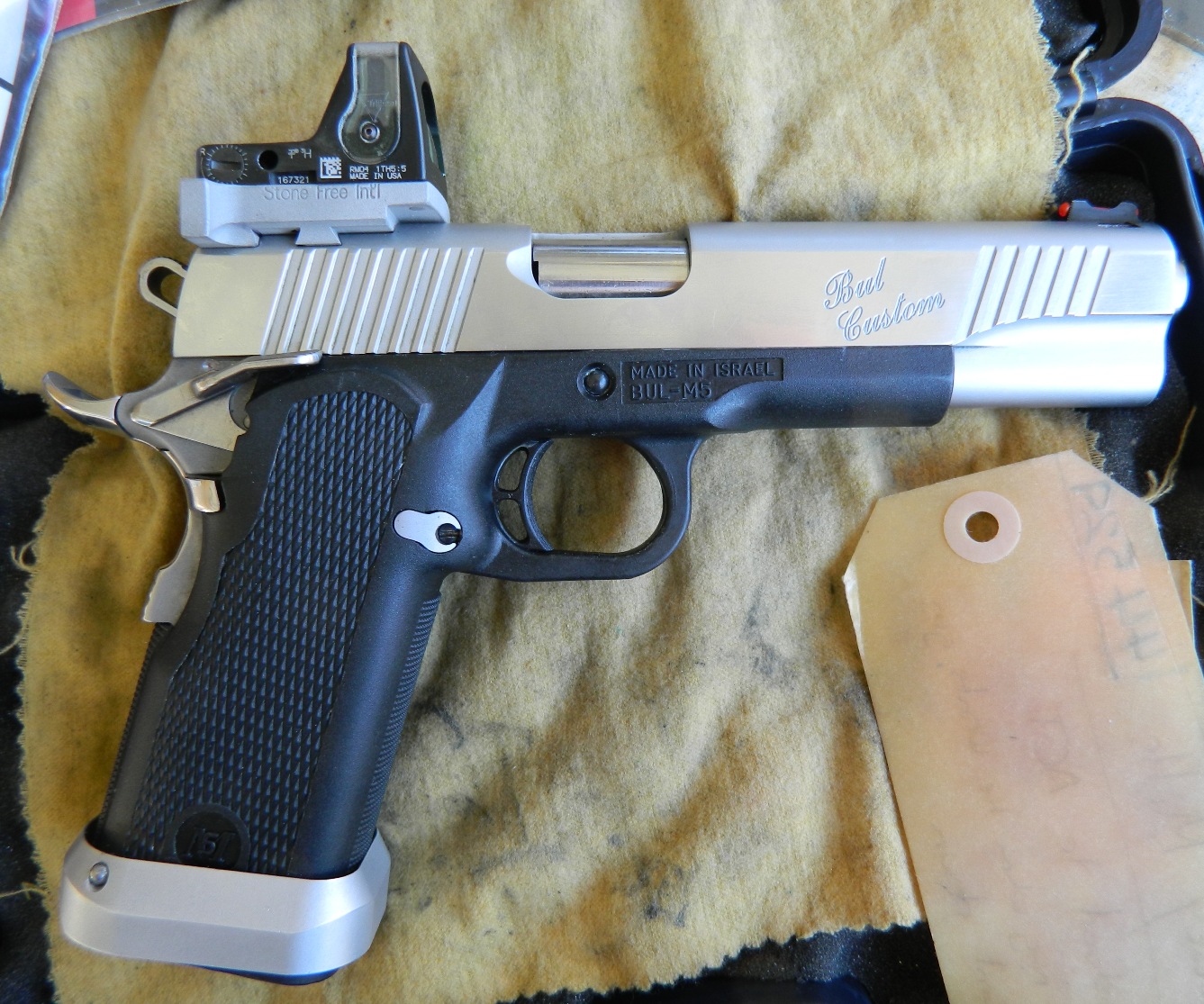

Here is the base/mount in place (along with the sight), after hand fitting the dove tail, and the front recoil contact surface.

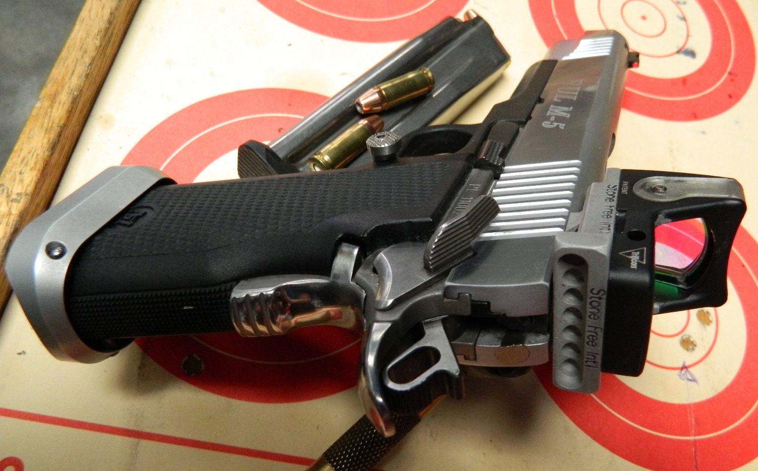

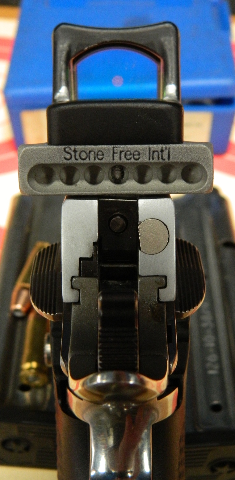

After some initial live fire testing, I was happy with the proto-type but decided to reduce the weight by "Jenny Craig-ing/Swiss Cheesing" it a little.

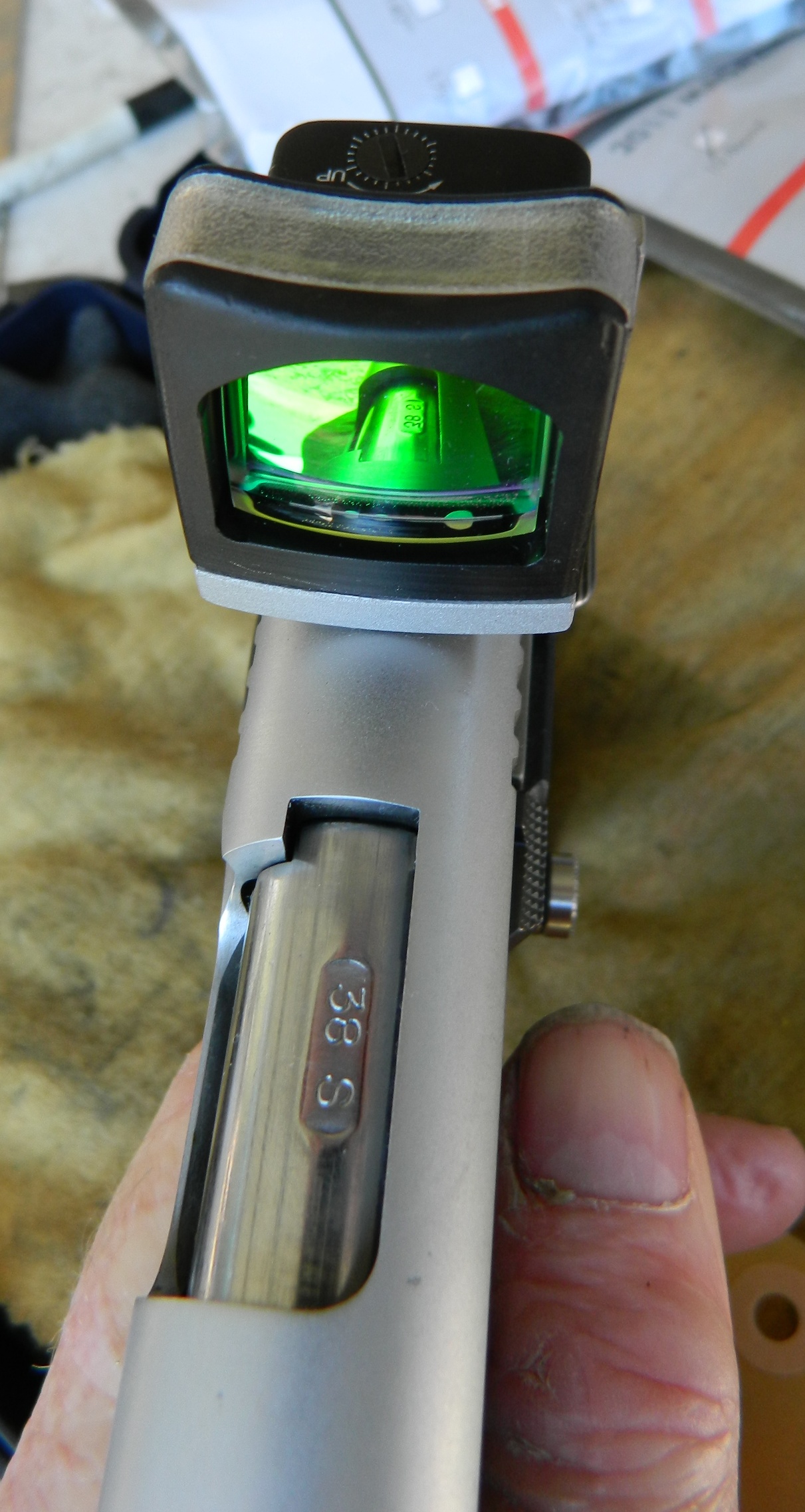

The pistol/sight combo has now been used, in a number of competition stages with good results.
