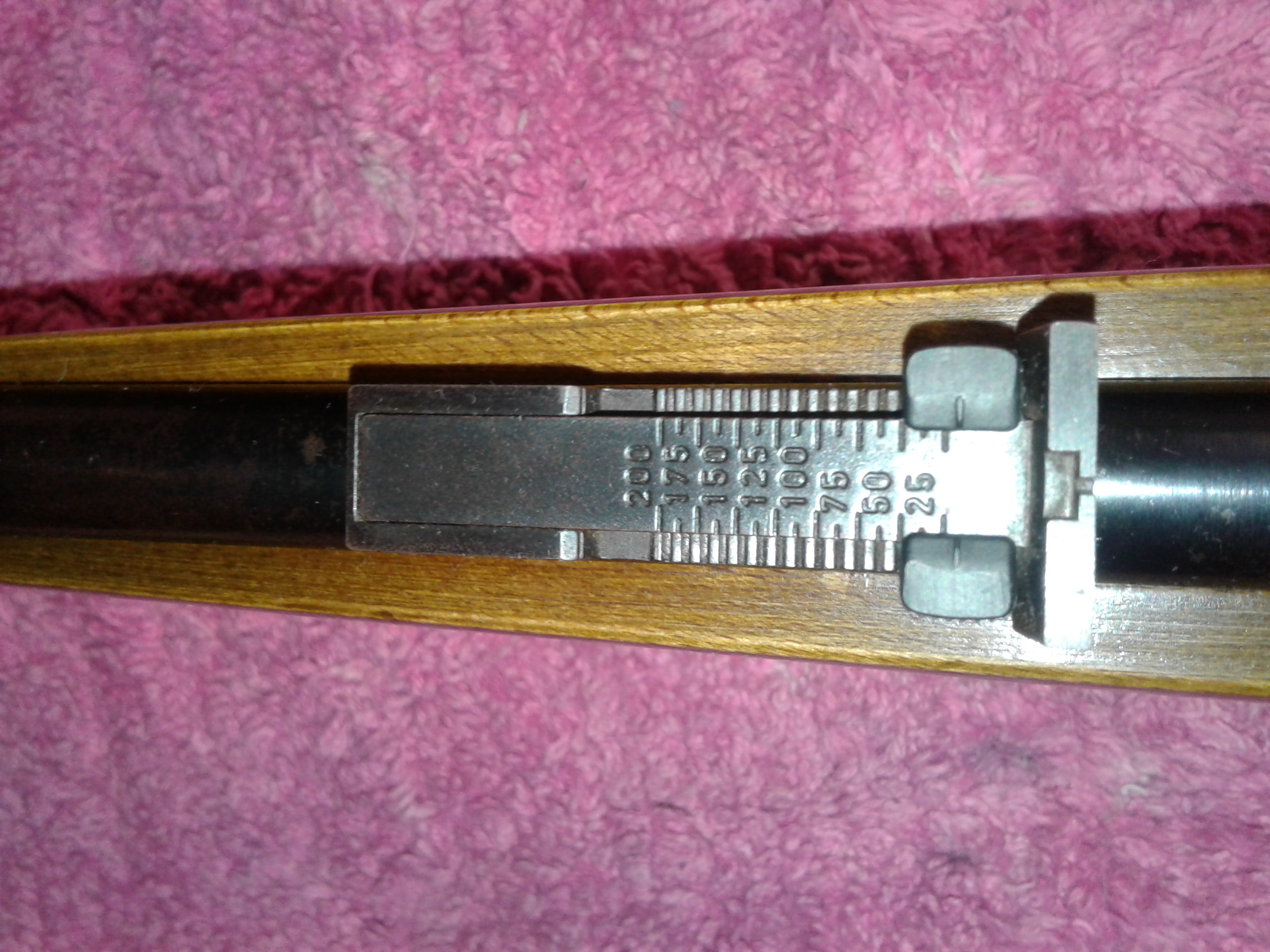

G'day All, Just a quick question if I may. I recently inherited an old 60's? Voere .22 from my Uncle and I was wanting to fit a decent scope to it as it came with the original 4x15 high power sniper scope he bought for it lol. So I need to remove the back ramp sight as the scope I want to fit is hitting up against it. There is no barrel band or a screw on the sight so...…..does that mean it is soldered or dovetailed on? How do I get it off? I have a bad history of f*cking things so I have now learnt to ask questions. Cheers.

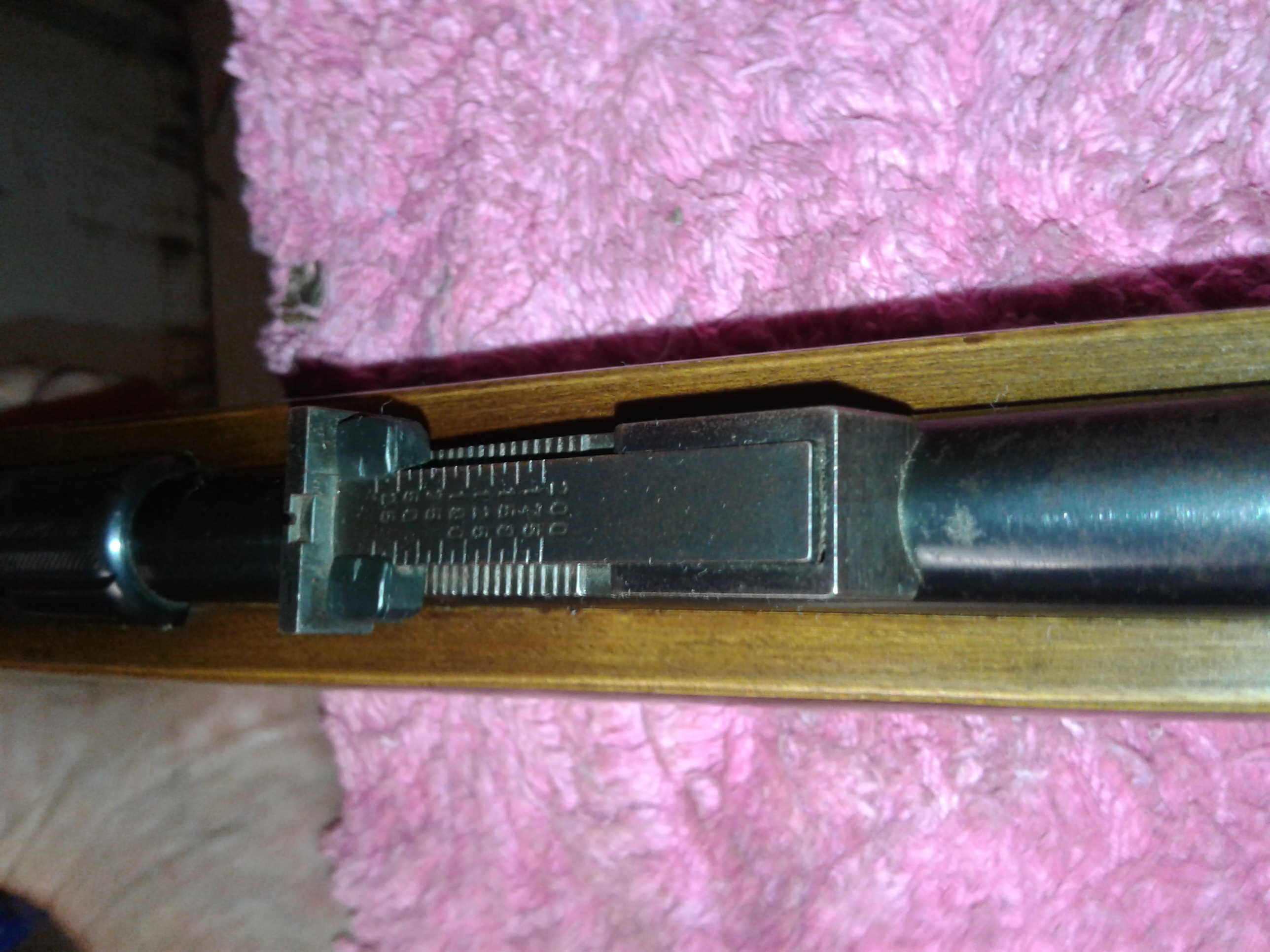

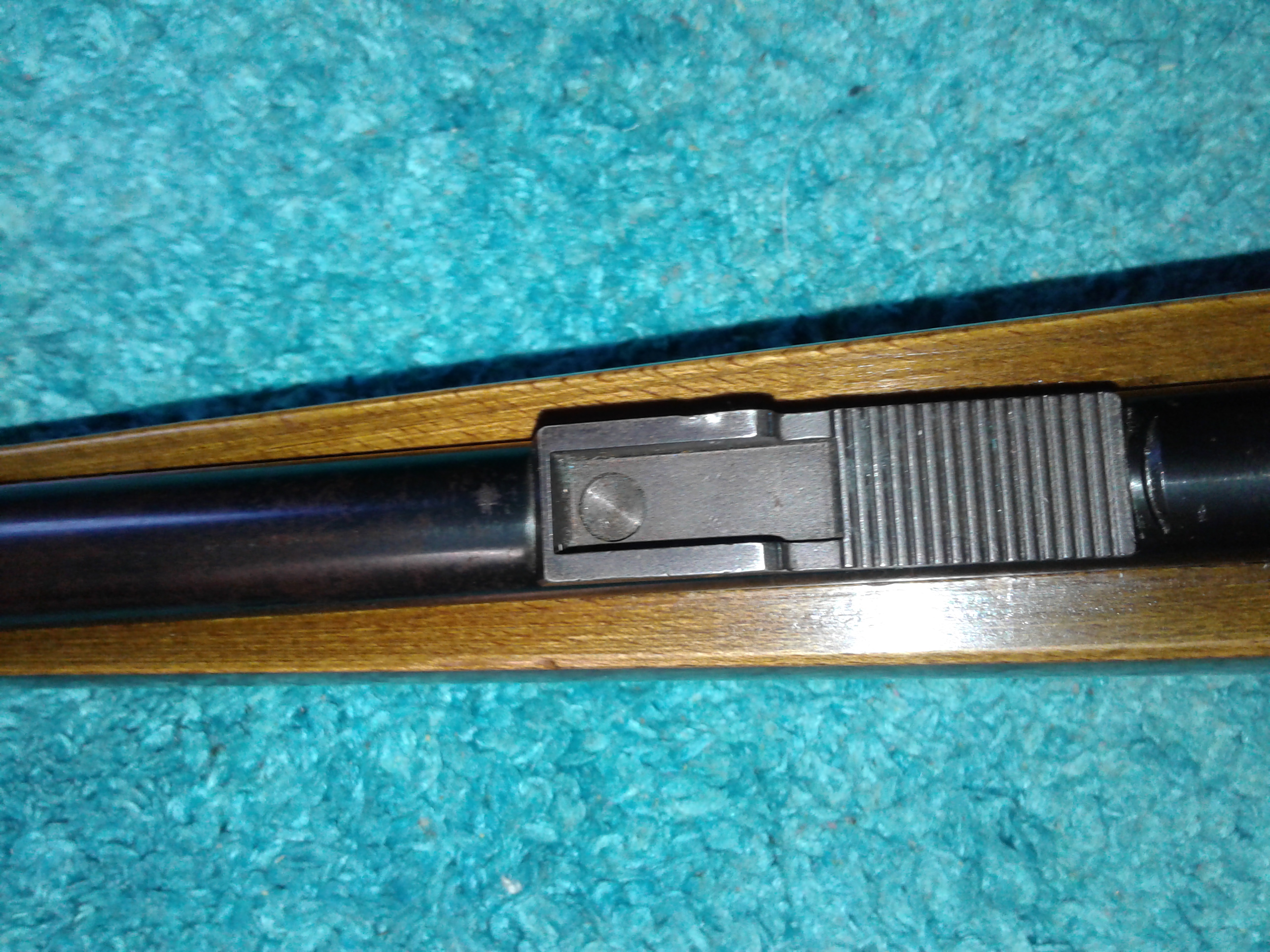

Rightio, here are some pics. I don't want to start bashing away and do damage. The front sight is the same it sits on top of a flattened off area at the muzzle. It's a good old gun marksman. It has a lot of sentimental value to me.

i could be mistaken stoney, but i reckon if you drift out the pin holding the "adjustable" part to the rear sight base, you might find a screw under there. thats how my rear sight on my krico was attached. i have a nice gunsmithing pin punch kit down here.....

bigrich wrote:i could be mistaken stoney, but i reckon if you drift out the pin holding the "adjustable" part to the rear sight base, you might find a screw under there. thats how my rear sight on my krico was attached. i have a nice gunsmithing pin punch kit down here.....
my thoughts as well
sometimes I have seen them put on with a screw and silver solder
if it is silver soldered heat with a plumbers torch and tap lightly, it will fall off when ready
the solder is a bitch to remove

So it seems it is soldered. How hard/How do you remove the solder Marksman? The front sight is dovetailed, the hood is steel but surprisingly the sight itself is plastic?

Gunna have to take the action out of the stock, heat up the sight with uncle’s butane torch ( if he can find it ), heat it till you see the surface colour change, then give it a gentle tap . You don’t want to heat it anywhere near red or glowing. If the rear sight were bare metal, it would turn a slight “blue “ colour when the heat is about right

the way I have done it to a few is to remove the barrel and action put it in a vise with soft jaws
apply heat with a plumbers torch moving the heat all over the sight and barrel, tapping it till it will just fall off
the solder may still be present after it falls off and wont take blue
so its either put up with it or remove and reblue
