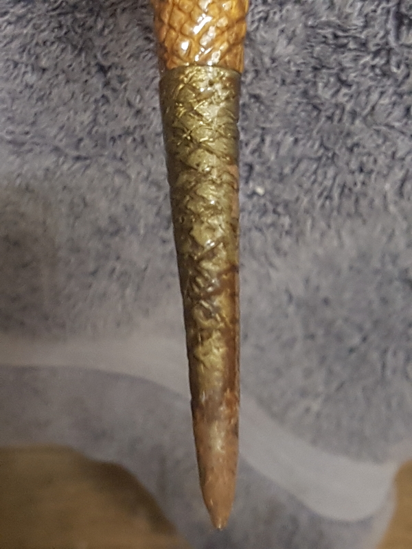

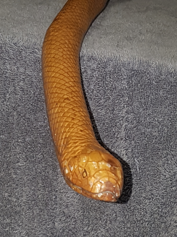

I used it on a walking staff I carved as a snake.
As I carved it by hand with small hand chisels, I could only do a bit at a time then sealed it. I worked on it for over 2 yrs, sealing, carving, sealing, carving.
Then, when I'd finally finished I brushed the Danish on one last time and let it set as a finish.
I made the tip of the tail from a bolt.

To put the tip on so it wasn't likely to fall off, I drilled out the hole so it was bigger inside than at the entrance and poured some molten lead in first, then with the tip heated by butane torch I pushed it into place. The excess was pushed out and when it cooled it was nice and solid.

It's yellow box. I wanted a particular snake effect so I hunted down a green branch that would give me the general shape, when I found it I took a strip of bark off the bottom and left the branch on the tree for another month for the exposed wood to dry and brown, that gave me the belly colouring without the worry of trying to get an even stain on green wood.
When it was browned properly I cut the branch and stripped it. I put it away for 2 weeks to let the green surface dry a little.
Then using a Tiger Snake I've had in a bottle of metho since 1969 as a reference I carved the head and then drew the head scales, mouth etc in pencil and carved those.
I bought three 4lt tins of Danish, cut a length of 90mm pipe, capped one end so that I could stand the stick in the pipe then fill it with the Danish oil, cap the top and left it soaking in it for 2 weeks so the oil could really penetrate.
A rub down then a month to dry.
Then the finger killer, carving all those scales into wood that was hard as rock.
Using the small hand carving chisels I'd work until my fingertips got too sore, then give it a rub down/rub off with Danish and stash it in a cupboard for a few weeks then repeat.
Sounds like a lot of pissing about for a walking stick but I like making things.
