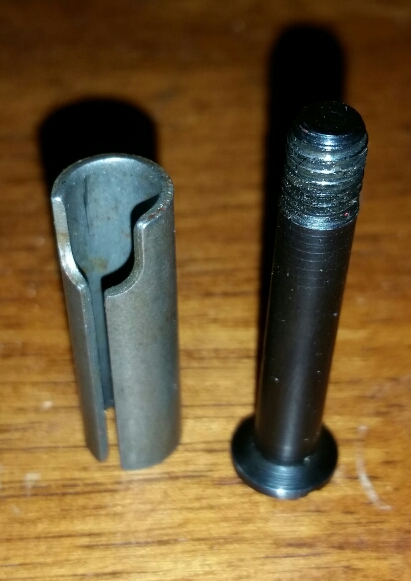

Post by Stix » 08 Dec 2018, 10:18 am
Hey Marksman...
Ali tube only because everything i see & read says aluminium pillars etc.
As you say its just to stop crushing...
I actually got hold of an original brno pin/tube but think ill put a tube in incase i bodge it... :unknown:
2018-12-08 10.28.59.jpg (159.97 KiB) Viewed 8221 times
I dont want to cut up my tyre inflator for the project...cos mine works :lol:
So i guess using steel makes sense now you mention it...as you say can do it up tighty tight.
The original is about 9.2mm OD, 1.1mm thick
The Aluminium tube i was gonna buy is 10mm OD with 1.6mm wall so as i said above there is more clearance for the screw than original...& i figured drilling out the stock a further .4mmin radius wont compromise it any... :unknown:
Guess ill fire up google now & see if i can find some steel tube in same dimensions...
