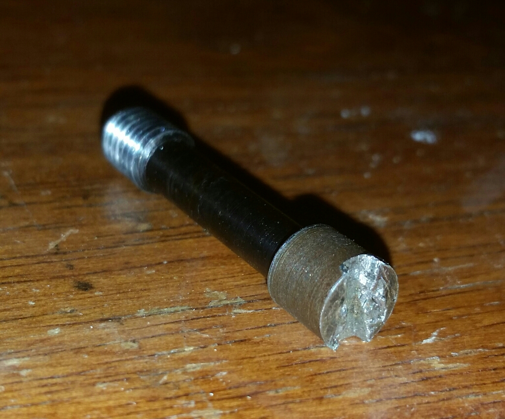

For example, i need to replace this...its off of an old Sportco built Martini action to fit the forend to a nut dovetailed into the barrel....
2019-02-10 12.21.56.jpg (602.76 KiB) Viewed 2650 times
Then there's the threaded bit that (appears to be) just push fitted into the forend...
2019-02-10 12.19.08.jpg (408.68 KiB) Viewed 2650 times
Id also like to make another forend to experiment with bedding on this Martini so as to not hack the original timber, in which case i need to get another screw the right length & thread as the existing dovetailed nut...

That particular screw you could build the head up with weld and file it back to shape, or possibly just cut it and weld the head of another screw to it. If you build it up with weld you can even index it and then cut the slot to run along the axis of the rifle if you wanted to. Have you determined the size and pitch?
As it's not threaded into the barrel or action, you could also replace the nut and the screw with metric ones. Filing a nut to fit the dovetail wouldn't be too hard and is hidden anyway.

No i havnt determined the size or thread yet....just thought id ask the question first...
Obviously hoping to not have to make stuff like that due to time restraints.
Yes i could file a new nut to fit the dovetail, & not thst it eould be seen, but that eould look like crap, not to mention ive not the tools to know if i could get it true (perpendicular to the barrel in every way). :unknown:

Let us know the dimensions and I'll see if I can find something. I think I kept some of those dovetail nuts and action screws from some Lithgows my dealer scrapped.
I can see the sense in that, but the time involved to make it would be pretty short, less than an hour I'd say. Dropping some weld on the screw head and filing it to shape would be quicker, and welding another screw to it would be even quicker still with no finishing required.
It would only look like crap if you wanted it to, if you want to finish it nicely it's really not much more effort.
Not really any tools other than some files, a vice, a caliper to measure with, and some patience, not that long ago all rifles were made entirely by hand, and they looked bloody lovely. With older firearms it's always possible that some bits have already been replaced with hand-made replicas, or bits adapted from other things.
