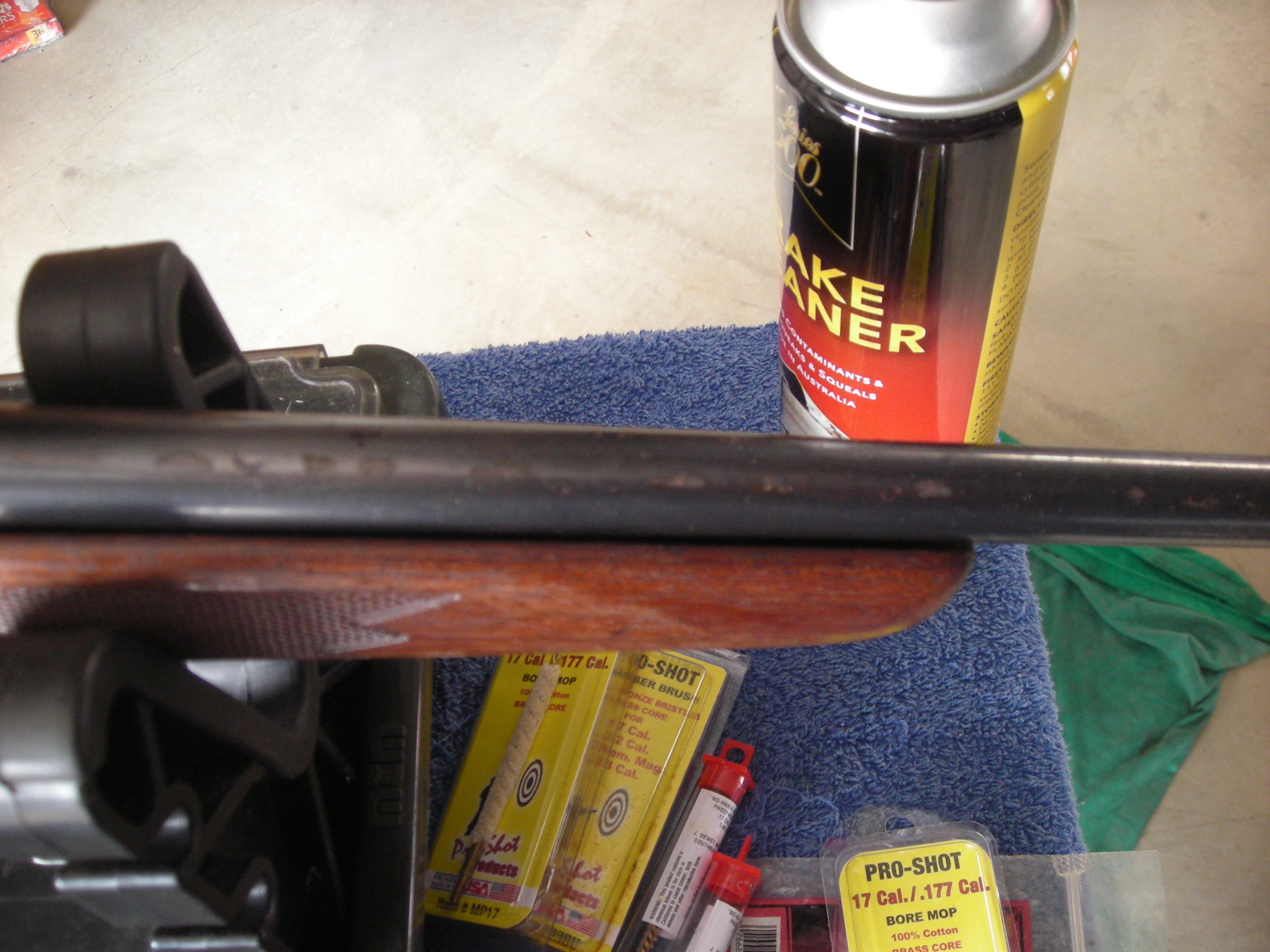

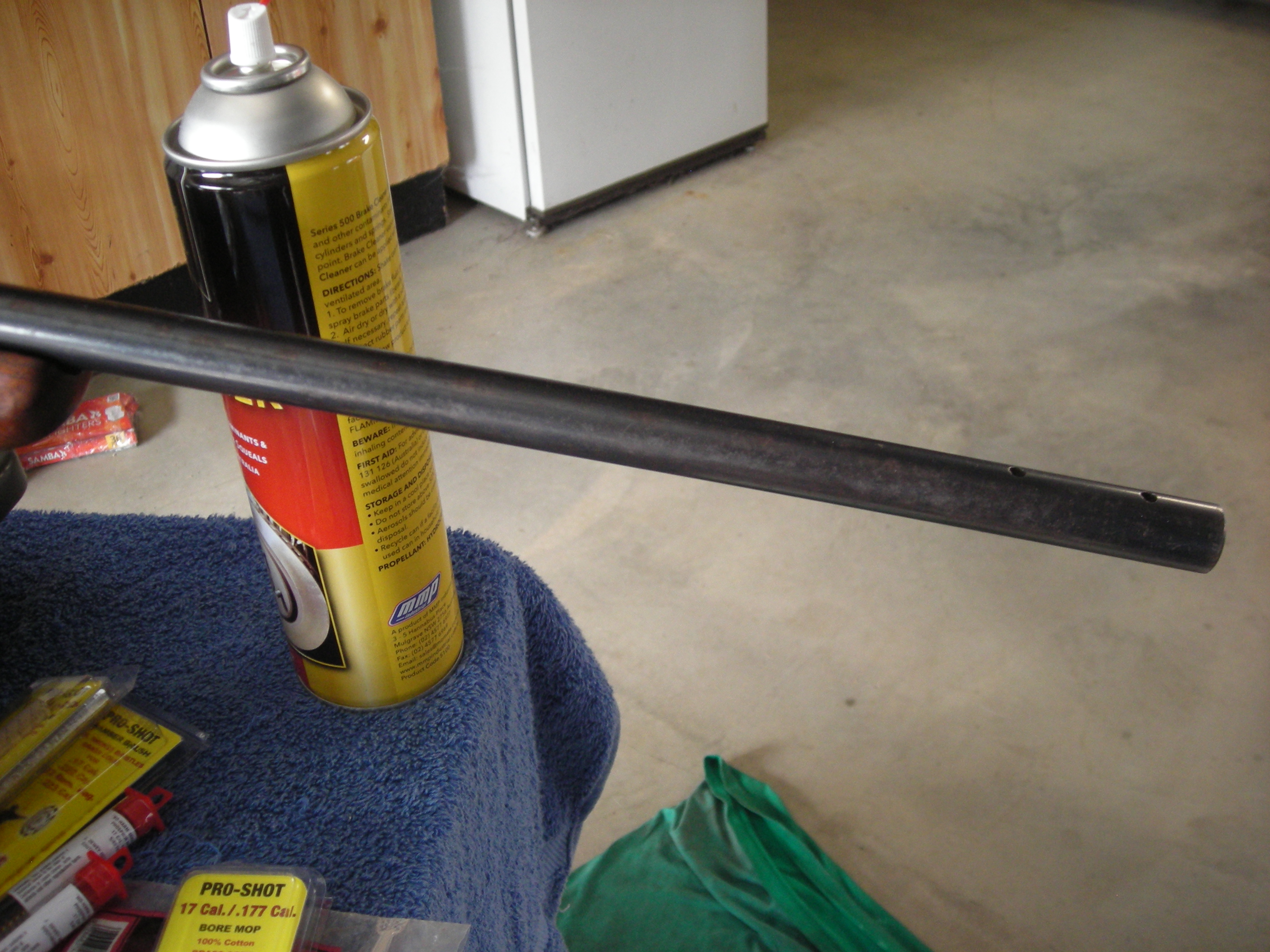

Cleaning the barrel is a slooowwww process. I have spent a few days on it so far, and I am still getting carbon and copper out of it. I have read that some people have found that layers of carbon/copper can build up, and that you have to progressively get rid of them. I am finding something that resembles that problem. Normally, I have patched out with solvent to remove carbon until patches are clean, then changed over to copper removal. Once that is removed a few more patches to check for any more carbon and then it is finished. Not so with this rifle. So far, when I switch between solvents it starts cleaning again, and a lot more fouling comes out.
It is an old rifle, so I guess that I am dealing with 30 years worth of carbon and copper. Products and methods I use work well normally, and I have seen this problem before on old rifles, so I just need to keep plodding along.
GQshayne
Posts: 976
Re: .17 Remington Project Rifle
Post by GQshayne » 02 Jul 2019, 4:20 pm

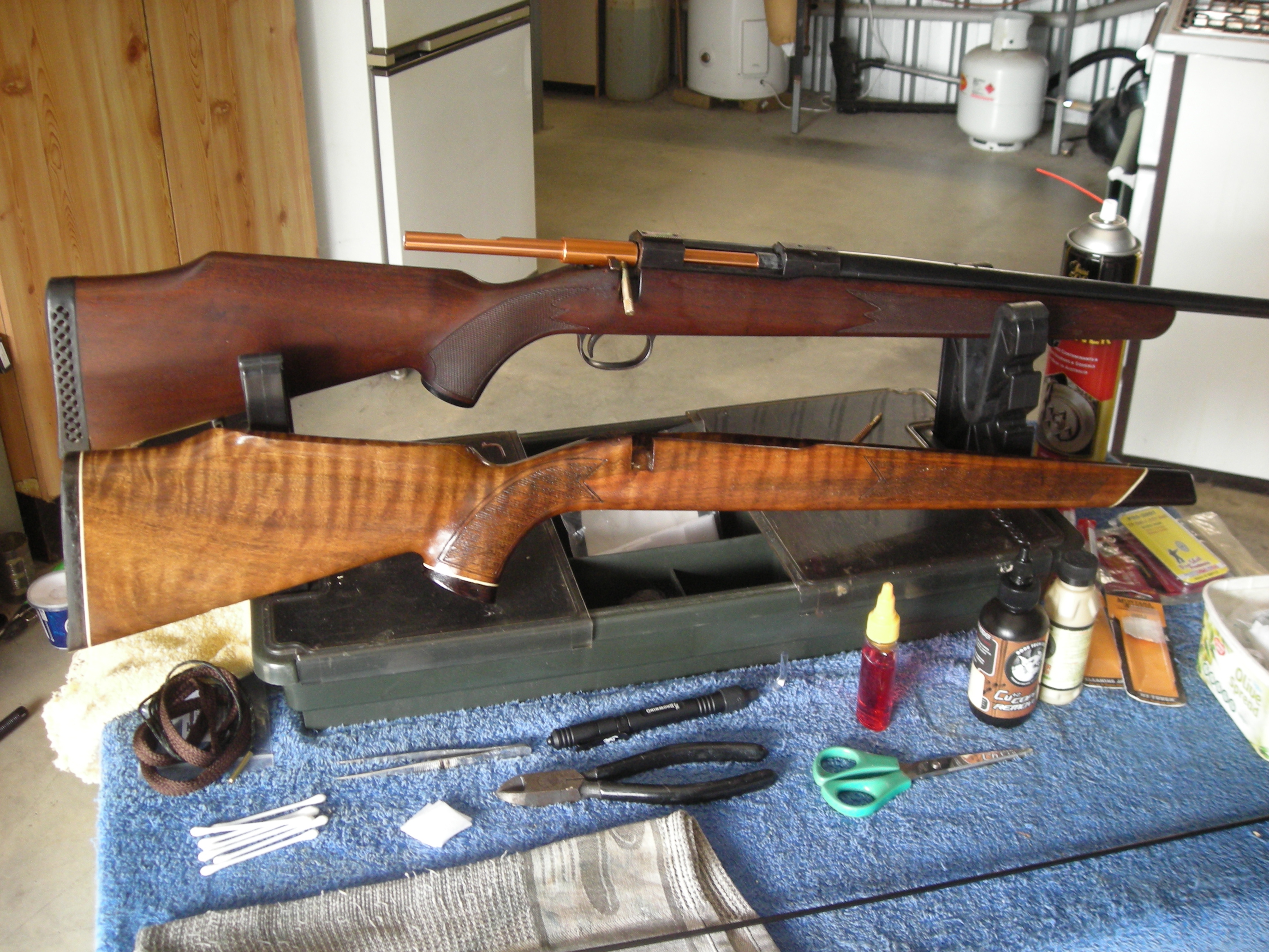

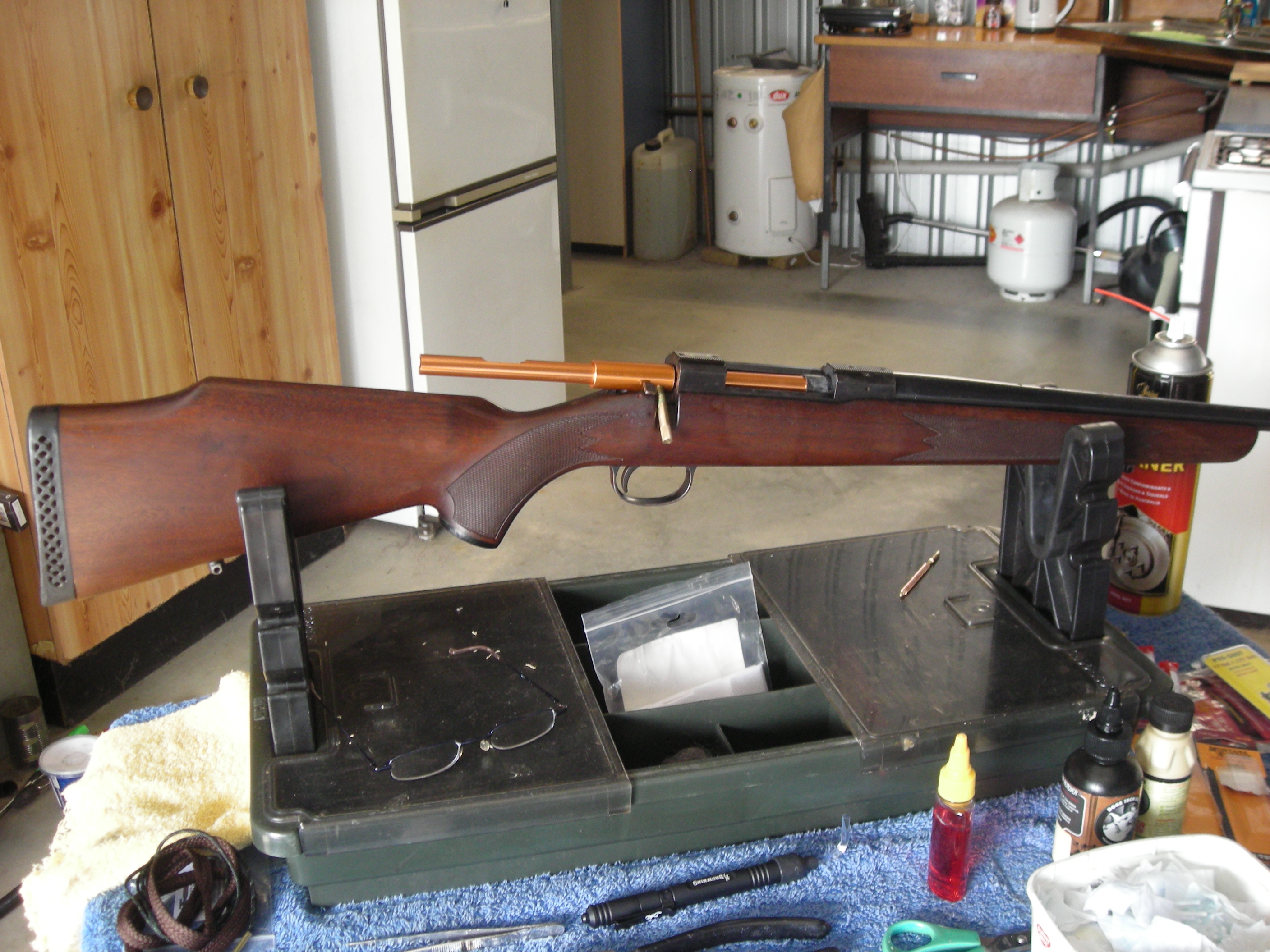

Cleaning is continuing! Looks like I am getting close to a result now, with patches coming out cleaner than previously. Perhaps I could have done this quicker, but I have tried not to brush it too much, rather letting the solvent do its job, and then patching it out. I have used a few patches..... :roll:
And here is the old girl as she is now. Stock is in reasonable condition for its age, with only one bit of damage that cannot be repaired easily. The forend has a good ding on one corner, which is too deep to do much about. I think to try to fill it etc would make it worse. It is only small, so is best left alone I think. Wet sanding with Tru Oil will fill it a bit, and round the edges off. That will have to do. The stock will then be sold off to a new owner.
Bluing is well worn, and there is some corrosion as well. Not bad though, so no major pitting that I can see. Looks like it has ben resting against something that held moisture, as the rust marks on the barrel are in a line. I think it will all polish off.

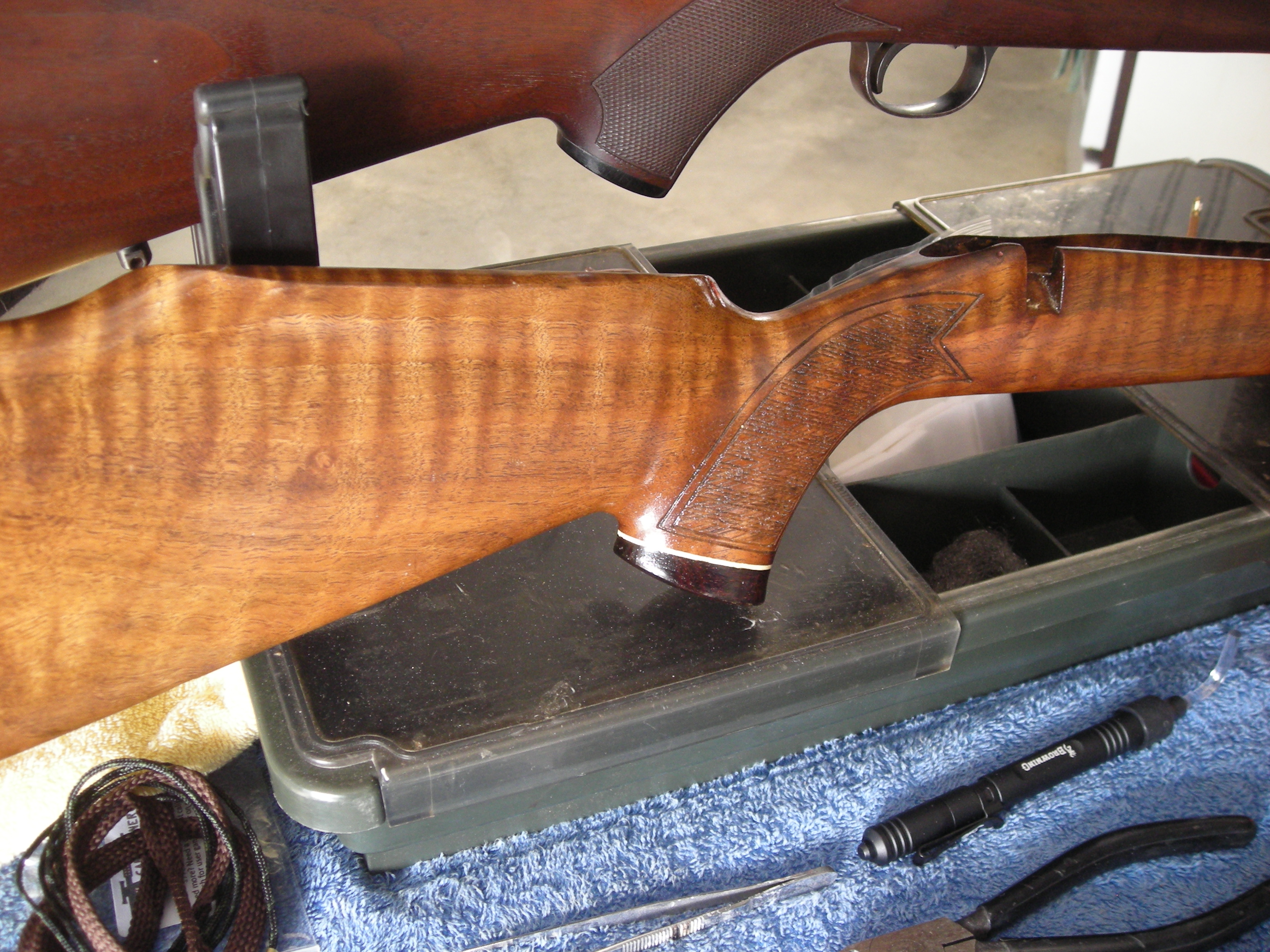

And the reason the normal stock will be sold is that I have a Deluxe stock for it. It is in very good condition, with no major faults. It has been refinished at some point, just not very well. It is pretty good, but not as good as it could be. So it will be refinished before the project is complete. Nice piece of timber, in the old Monte Carlo style. I quite like this, and am well used to its feel, as my well used Tikka in .243 has the same stock.

Post by GQshayne » 03 Jul 2019, 7:18 pm
Yep, It can sometimes. I am still working away at mine, I am still getting cooper out of it. I thought I needed to do something different today. I did not have any Sweets handy, which I will use I think, so I thought I would give the old hot water trick a whirl. I have not done this before, but my father has in the past on badly fouled rifles. So I boiled the jug, poured it slowly through the bore, and then did it again. The plan was to get it hot, get the water out, and then get some copper removing in there while the barrel was hot. So I put a patch through to dry it out, and it came out filthy!!! After a week of cleaning, with no solvent, it was quite dirty. So it obviously works.
I just had a thought. I should put some solvent on that patch and see if it changes colour. At the moment it just looks dirty, but solvent may turn it blue, which would confirm if it is copper. Worth a try.
GQshayne
Posts: 976
Post by GQshayne » 05 Jul 2019, 7:26 pm
Still cleaning...….. :wtf:
The dirty patch mentioned above did not show signs of copper when solvent was added to it.
It is a .17 Rem, so one of the most notorious barrel foulers, but I expected to be finished by now. The theory of copper and carbon getting deposited in layers seems to be the case. Changing between solvents and methods seems to be the way to stir things up and make some progress. But it is weird to have put 200 patches through a barrel, and then all of a sudden the next one is black.
