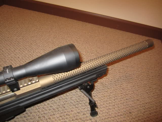

Post by MeccaOz » 03 Jun 2014, 4:17 pm
They do Look pretty cool, The AR guys in the states seem to be all over it :)
Not dimpled exactly, but I like it !

Post by tiki » 04 Jun 2014, 3:04 pm
MeccaOz wrote:Not dimpled exactly, but I like it !
+1
Yeeah, that looks good.
The dimpling looks cool too, the diamond cuts like that make it look a big tougher though.

Post by Mark TAC » 11 Jun 2014, 11:12 pm
I disagree that it is pointless. There would be a LOT more surface area on the diamond pattern one, even compared to normal fluting. It would cool really fast. Essential on an AR used in a prairie dog town (two things we sadly do not have here :( :( )
I reckon the honeycomb one would have a LOT more surface area than normal flutes too but not as much as the diamonds.
And really that diamond one would not be that expensive, it is just spiral fluting, but more turns per inch / foot whatever, and then another spiral flute run the other way. So anyone set up to do that sort of fluting would piss it in.
Also, cleaning is not really an issue as they are parkerized or Cerakoted. Both very solvent resistant so squirt it with brake cleaner, crud falls off, done.
I think it looks bloody horrible though.
