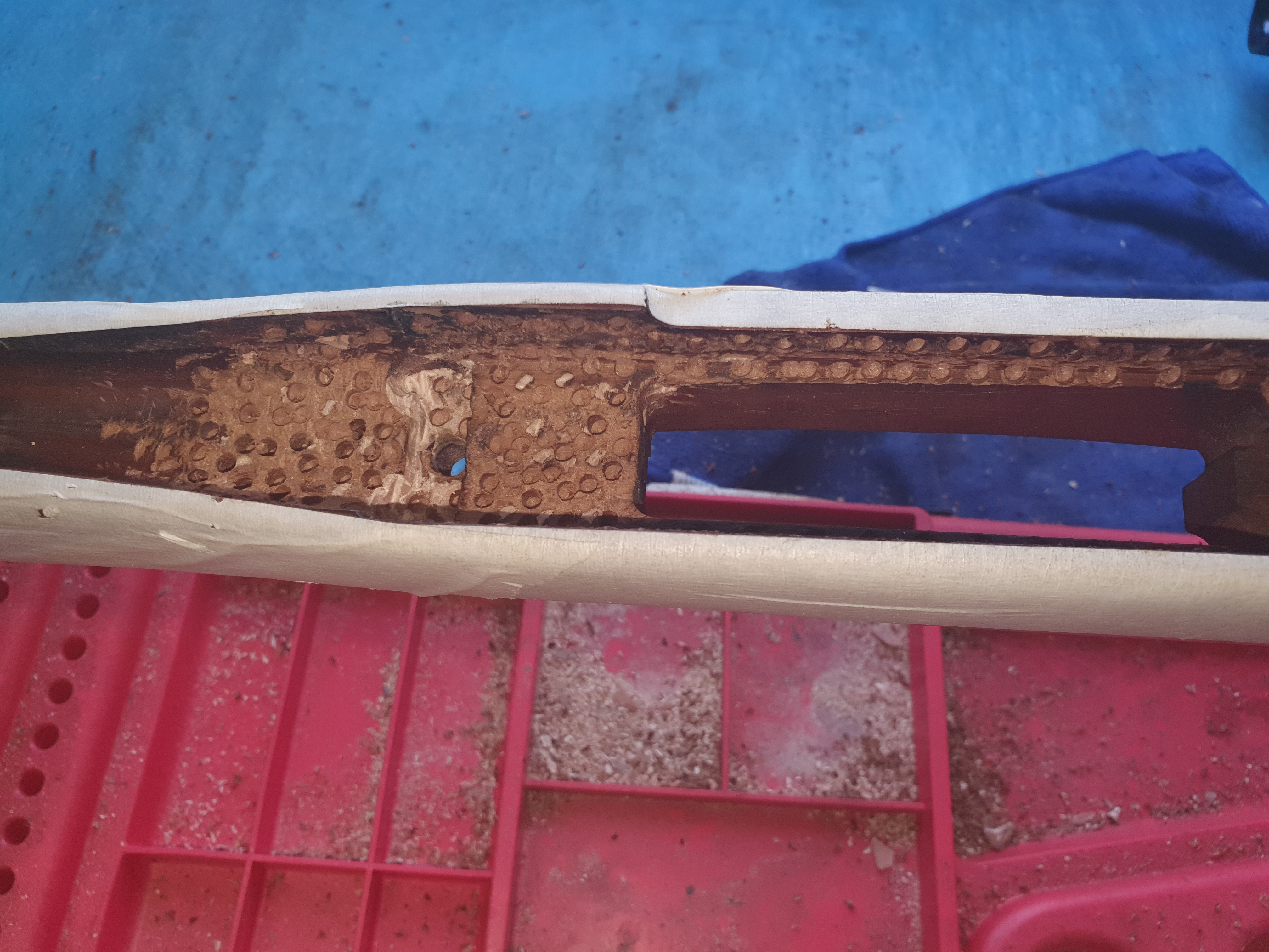

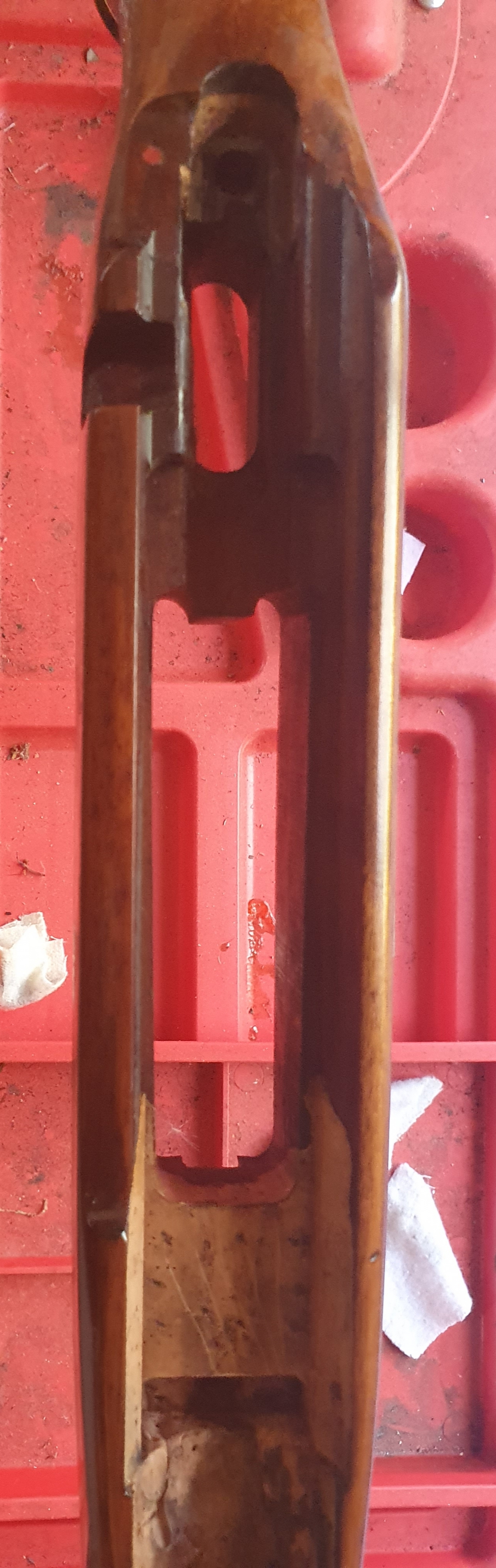

So started drilling into the stoch and removed the old pink stuff what ever it was from the stock.
I dont know if this is the best way of doing it through. The howa that i have in 308 with one of those horid houge stocks i did in the same mannor and it ended up working a treat.
Big tip i learnt from the last stock that I did masking tape works wonders for preventing scratches who says you dont learn things when your older lol.

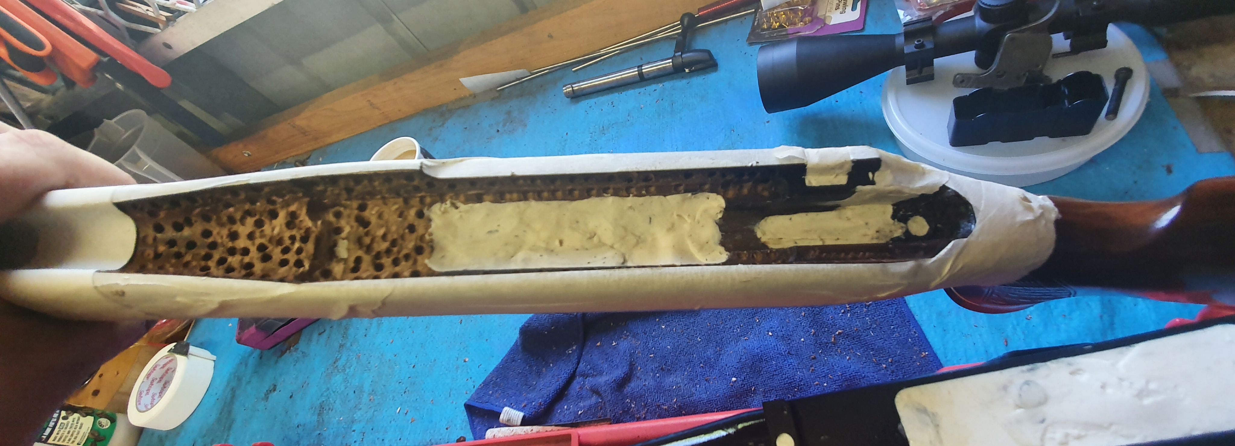

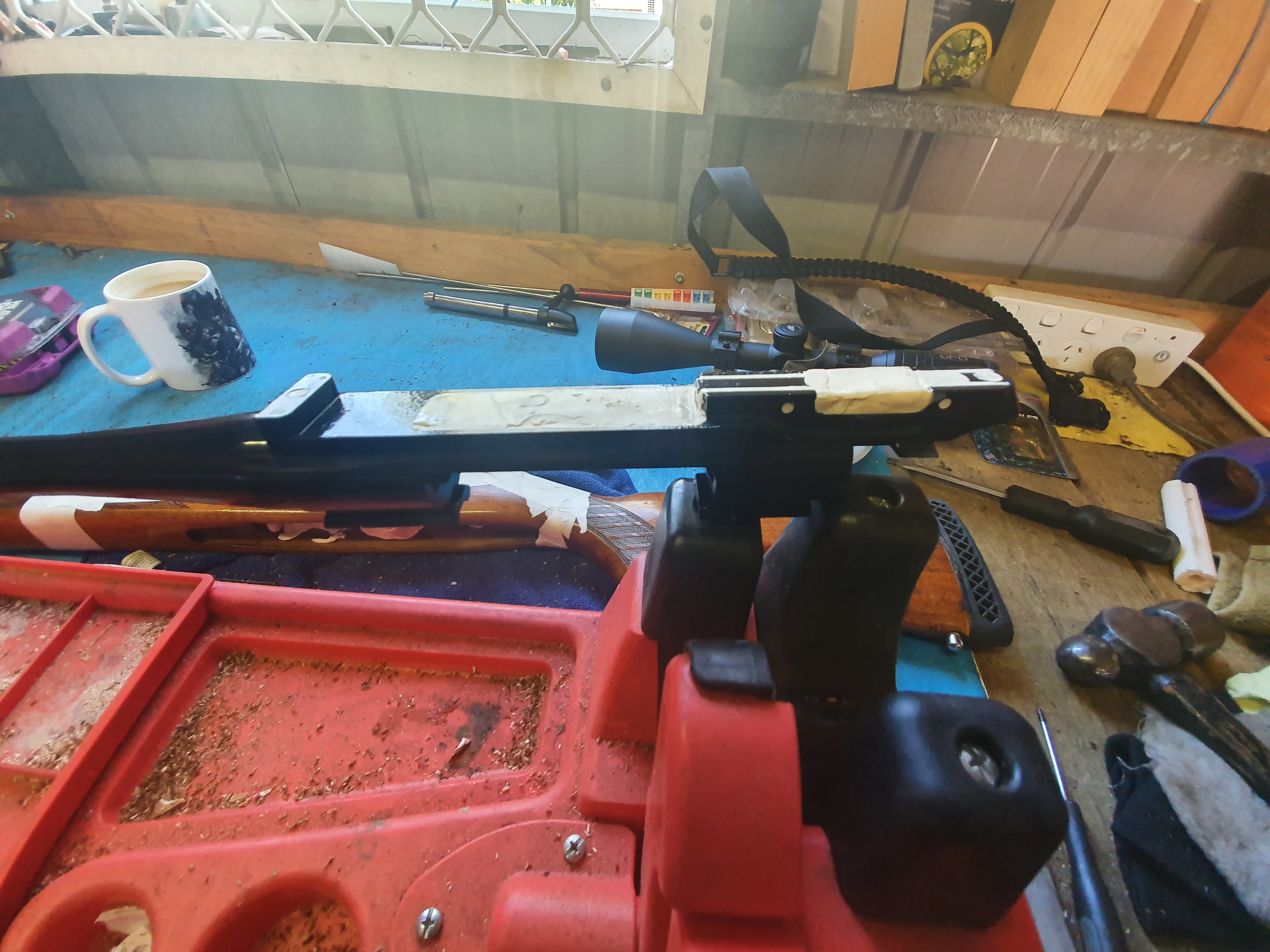

After a bit more mucking around and i was happy witht the stock prep i started placing down the plastacine dams.
Did the same thing with the action to prevent any unecessary contact with bedding compound to help with the clean up.

Hey there Marksman ill be using Devcon 10110 for the beddibg job first impressions mate it seems like great stuff. I have used the match bedding compound by Nathan Foster before and thought I'd give the devcon a go.
Not to say that I didn't like the foster bedding compound just thought I'd give the devcon a go end result mate i can't tell the two appart.
AZZA'S HJ47
Posts: 698
Re: BSA 222 rifle bedding Job.
Post by AZZA'S HJ47 » 13 Apr 2020, 5:50 pm
Whilst the Decon 10110 mixed well the one thing that set it appart from the Foster bedding compond was the viscosity the devcon was a little on the thick side and whilst it did flow when placed in the stock it was a little thick for my liking.
The foster bedding compound however you can pour into the stock and is propably a little easier to work with.
I placed the rife into the stock and slowly applied gentle pressure to the action to seat the rifle using some strech tubing I tied the rifle to the stock and left it to dry for 24 hours.
After around 2 hours i returned to the rifle to trim the excess Devcon away to ease the clean up process and at this point all appeared to be as it should have been.
Personally i would have liked to get the rifle action loosly bolted in with the action screws however i didn't want to chance damaging either the bolts or the action as the thread for these is i think off the top of my head 3/16 x 26bsf and not something ive had and luck finding.
