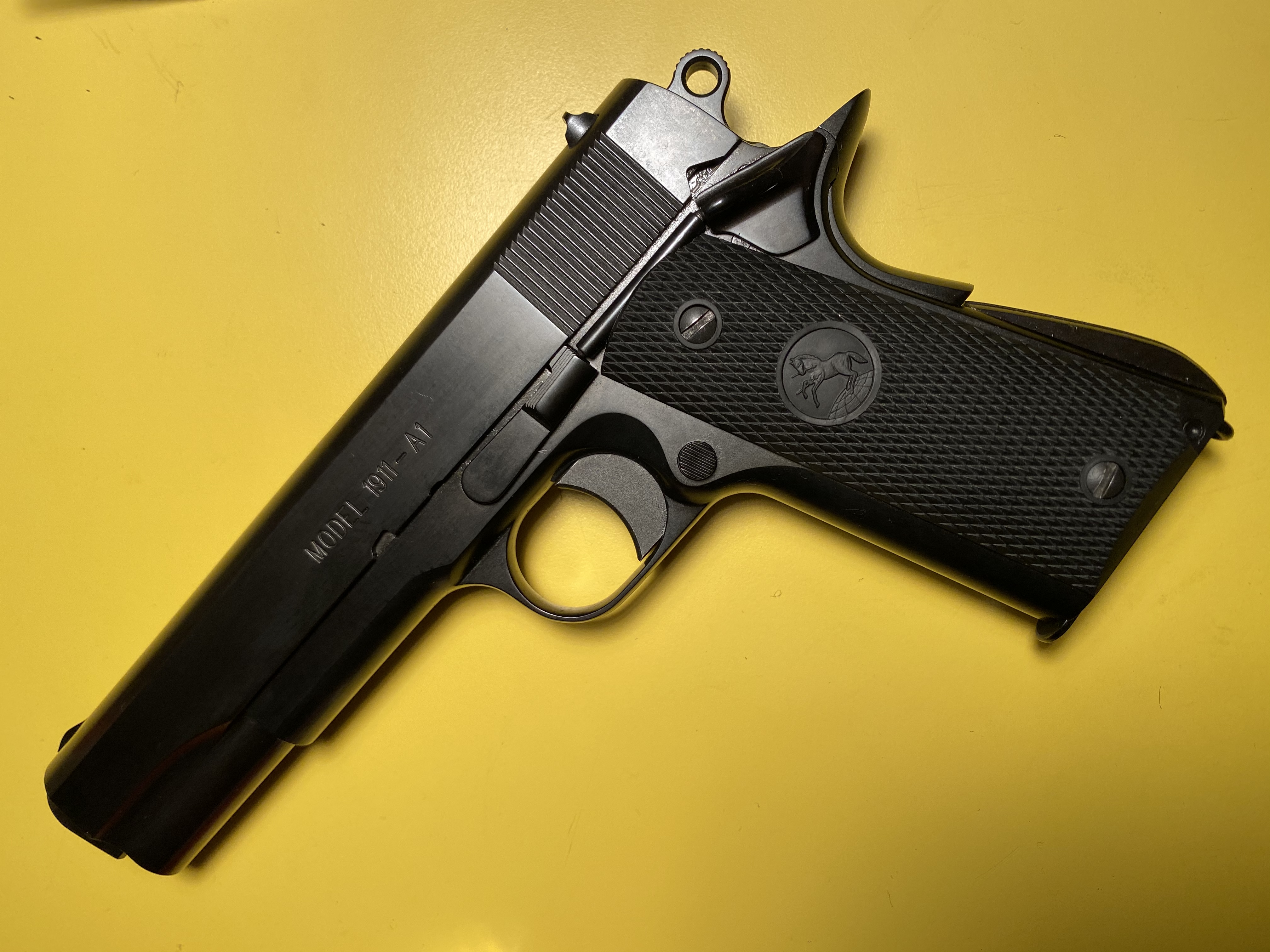

Just finished rust bluing a 1911 last week-end. I used this product:
https://www.brownells.com.au/index.php? ... anu_id=859
I had done a rifle in the past with Brownells' own "Classic Rust Blue" solution that requires humidity, etc, and likewise got good results, but the Mark Lee stuff is fast, and calls for heat, rather than humidity. I used the kitchen oven, and did 10 cycles in perhaps 5 or 6 hours. Result is a very deep, smooth black. From the look of it, I'd expect it to outlast "hot salts" blue.
As No1Mk3 wrote, prep is everything. I polished to 1000 grit, which was probably overkill - the process does dull the sheen, as I'm sure you've read, but better safe than sorry.

She’s a beauty cleger well done and thanks for sharing! The blue on the yellow also makes for a killer photograph!

I think the pack of ciggies makes the pic---shame about the colour of the lighter...a part open box of redheads with black ink scribbled moustache on the girls face, sat off to the side would make for a great staged pic...!!... :lol:
Looks like a good blue job though,,,well done... :thumbsup:

Thanks, guys! My knife and fountain pen were out for repairs, so I had to make do.
I should mention that I was on the fence re: buying a $20 "carding brush," but in the end I went ahead and did. I'm glad, because it would have been very difficult to clean out tighter areas with steel wool alone. Even though the Brownells brush is really just a stainless wire brush, its rather finer and softer than I could find in the shops around here.
