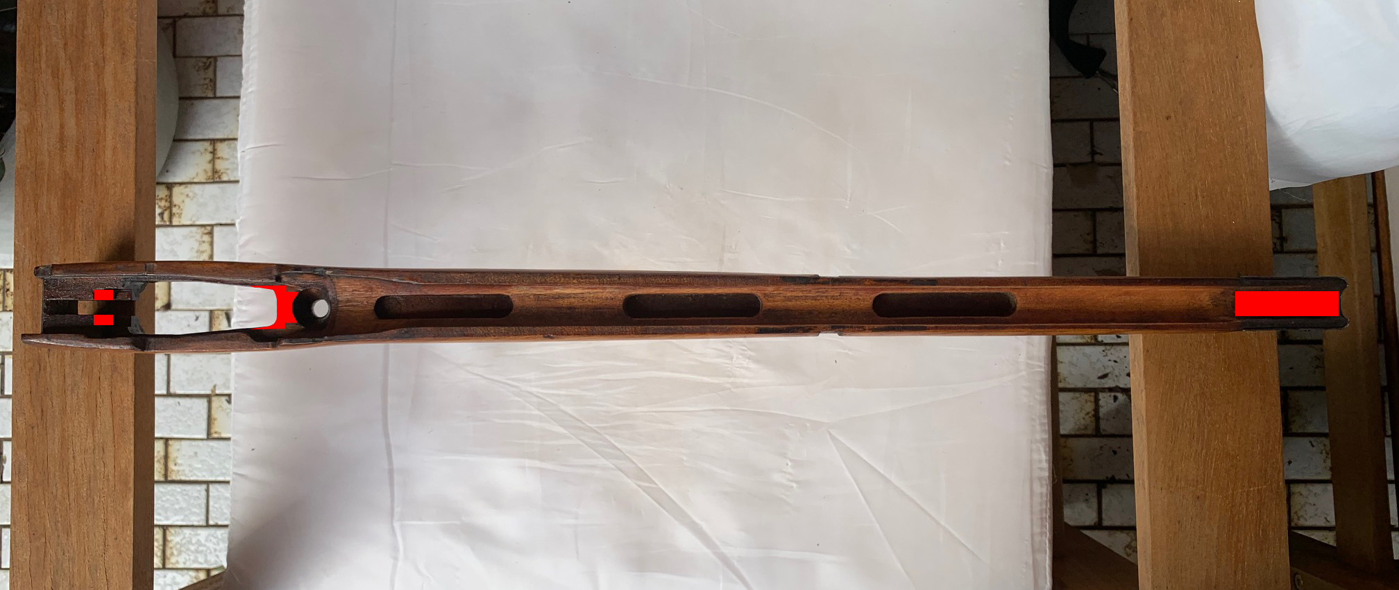

Red areas were how my particular No4 originally bedded. The action could be better bedded.

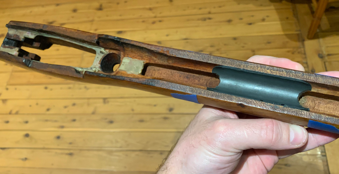

Firstly we need to understand how our action interfaces with the forend. Remove the action from the timber forend as normal.

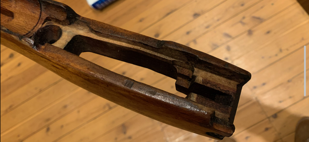

Lots of old oil and mung that needs cleaing up

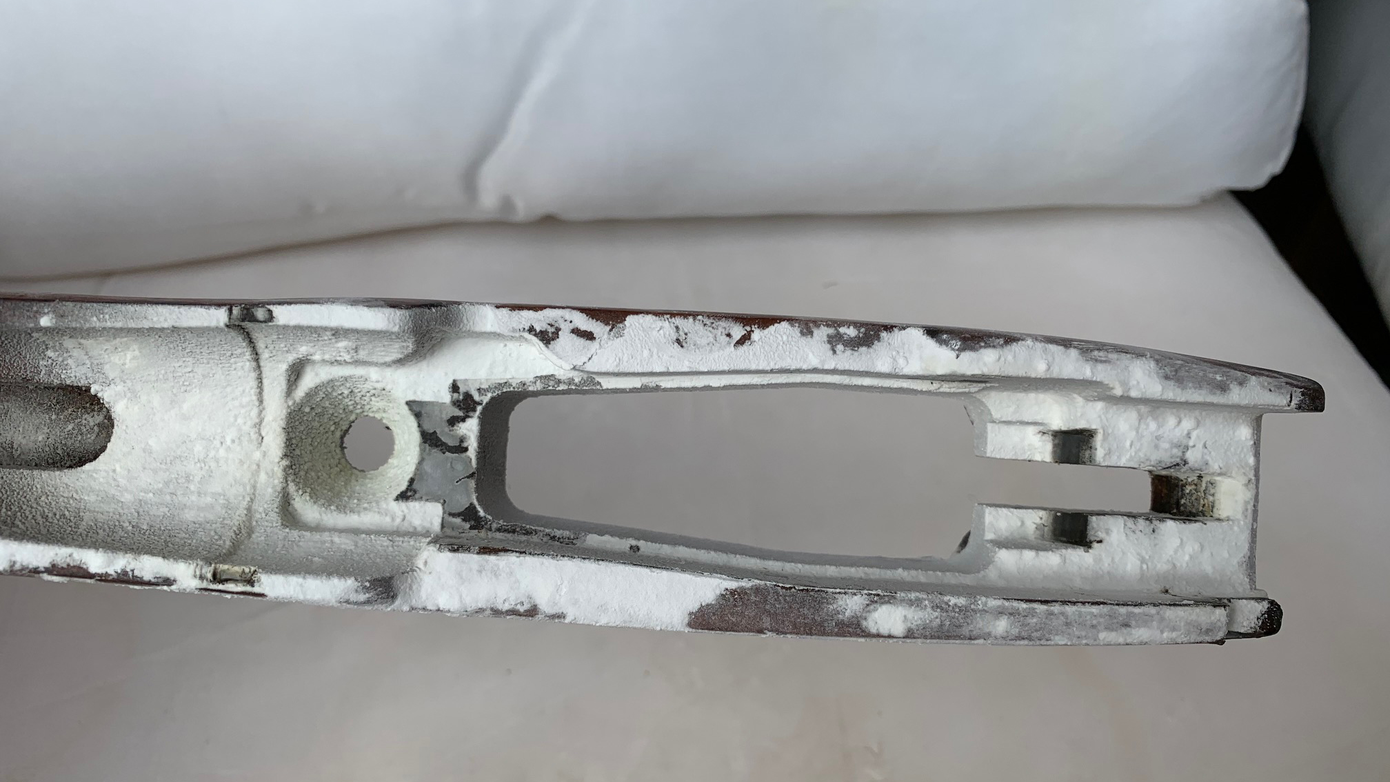

Spray the timber around the action area with WD40, then dust with talcum powder. Reassemble the action and trigger guard, and tighten up the king screw. Disassemble once more and observe how the action has imprinted into the talc dust:
Dust + reassemble to see the interface
In my example, you can see a distinct area immediately behind the king screw that has made contact. Moving rearward (besides the draws), there is little observable contact. On the upside, my draws look to have equal distribution onto both recoil lugs; this is absolutely critical to accuracy. If your gun is not centered on the draws, stop here and address that issue first. Bedding the recoil lugs is beyond the scope of this guide.

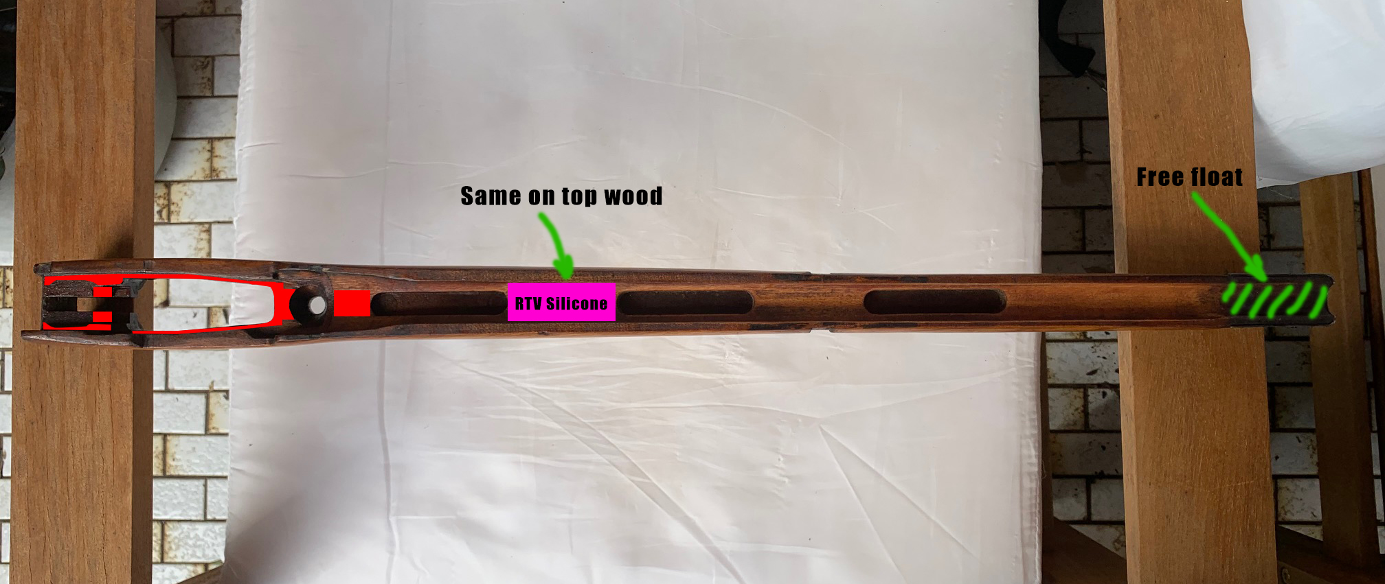

Ideally the action should bed down all along the length of the action as shown in this diagram (in red):
And here is the goal; bed the action/barrel, free float the tip.
So that defines the goal of PART 1; Acraglass Gel bed the action along the red areas.

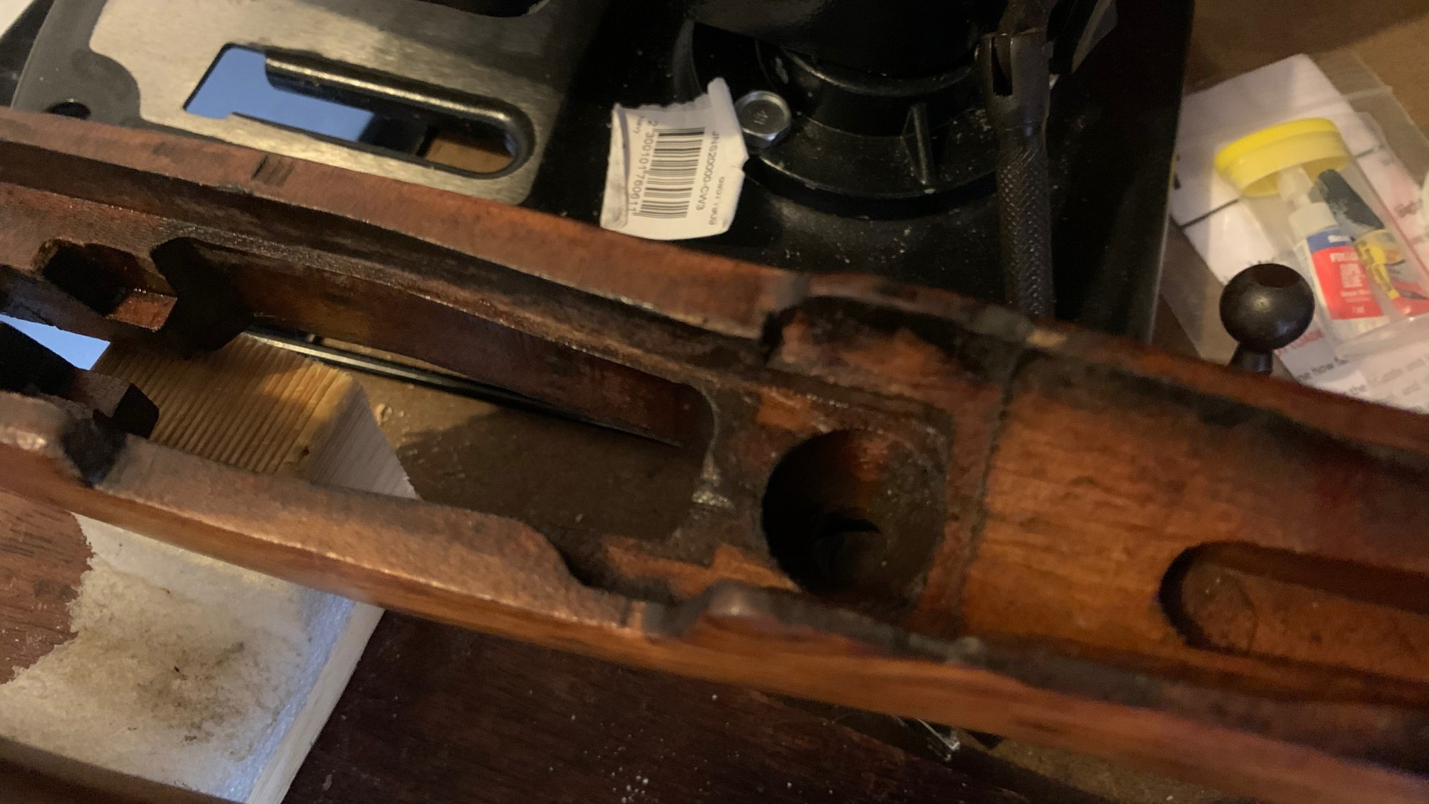

Clean as much oil as you can from the timber. This can be ahieved with acetone, a toothbrush, a heat gun and some elbow grease! After the targeted area has been thoroughly cleaned and dried, roughen it up with a small file to give the epoxy somewhere to "grab".
Forend has been cleaned and "roughened"

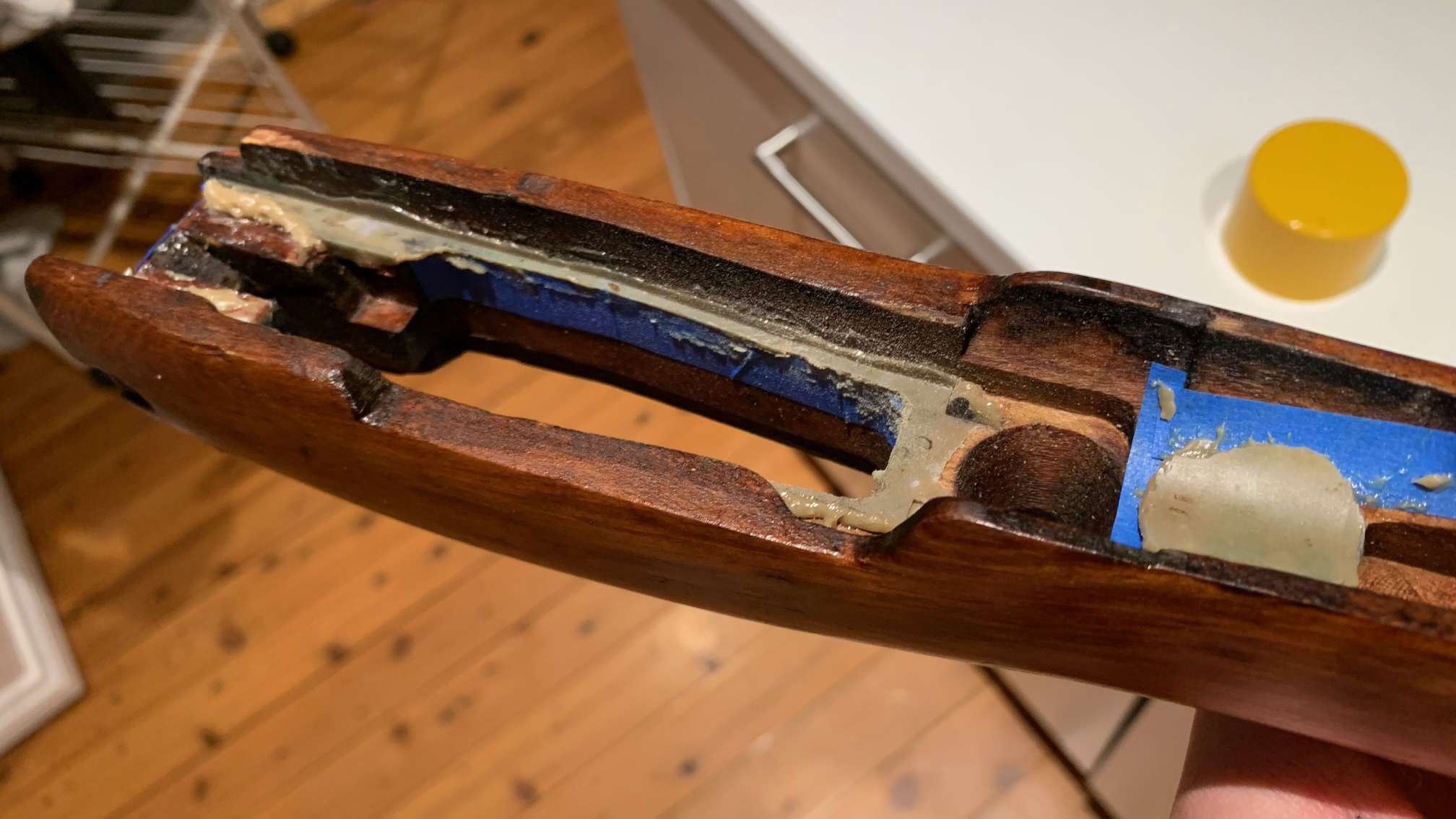

Wadham talks about two possible barrel bedding materials; the modern epoxy bed, and more flexible and traditional cork-strips bedding. This is where I deviate, opting for a third option in the form of RTV gasket silicone (klnown as "Permatex Ultra Black"). I see RTV bedding as comparable to cork, yet much more concise and permanent.
Again, clean the timber thoroughly on the first platform using acetone/heat. Meanwhile mark and mask your barrel in the appropriate location. Degrease and apply two-to-three coats of release agent to the barrel around the circumference. Mask adjacent areas of timber with painter's tape on the forend to protect from any extrusion. Lay down a thick consistent bead of RTV silicone (not the acetic cure type!) onto the targeted timber platform.
A liberal bed of RTC silicone ready for reassembly
Reassemble the barreled action and trigger guard and tighten the king screw. The silicone should extrude out either side of the barrel as it beds down as shown;
RTV silicone should extrude out either side a little
Wait 48 hours for the silicone to dry in cold climate, 24 hours in warm. Carefully cut away the extruded bead slightly lower than flush to break any mechanical lock. Clean up any overhang/extrusion with a scalpel leaving something like this:
Cleaned up with a scalpel
Now, do the exact same thing all over again, only this time for the top timber above the same spot. Once completed, the idea is once the top and bottom wood is reassembled, the RTV beds will gently clamp down around the barrel (above the targeted platform), providing support and rigidity, yet still allowing a little cushion room.

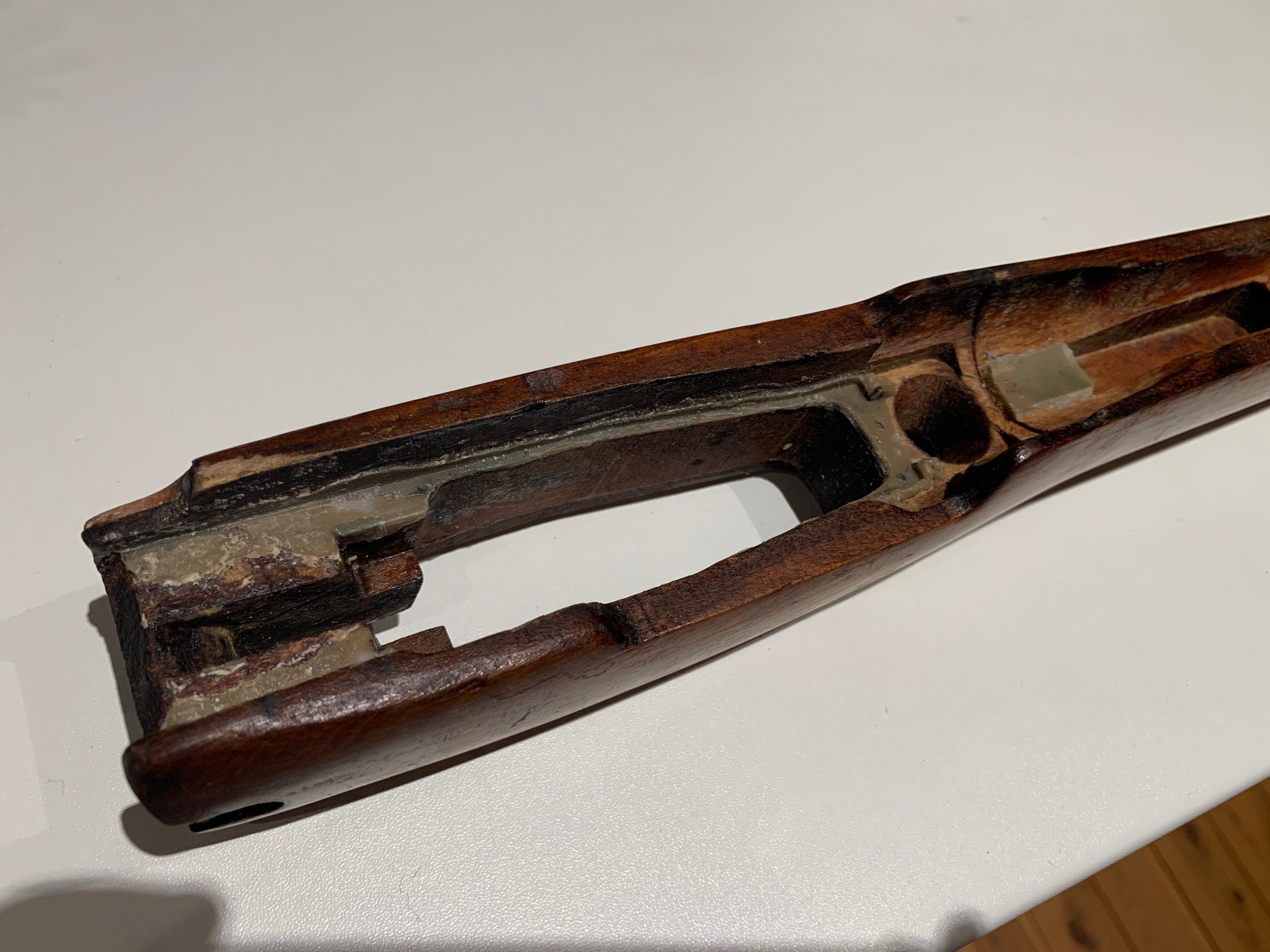

PART 3: FREE FLOATING THE FOREND TIP
Part 3 is relatively straight forward; we just need to relieve the timber swell at the tip of the forend such that the barrel is completely free floating This can be achieved incrementally using some sort of bearing blue. I use matte red lipstick as a cheap and convenient alternative to machinist’s blue. Again, the Dremel can greatly speed up this step with care! Keep removing material until the barrel can noticeably flex up/down/left/right once reassembled; the last thing we want is for the barrel to whip against the forend under recoil.
Factory timber pad at tip of forend free-floated

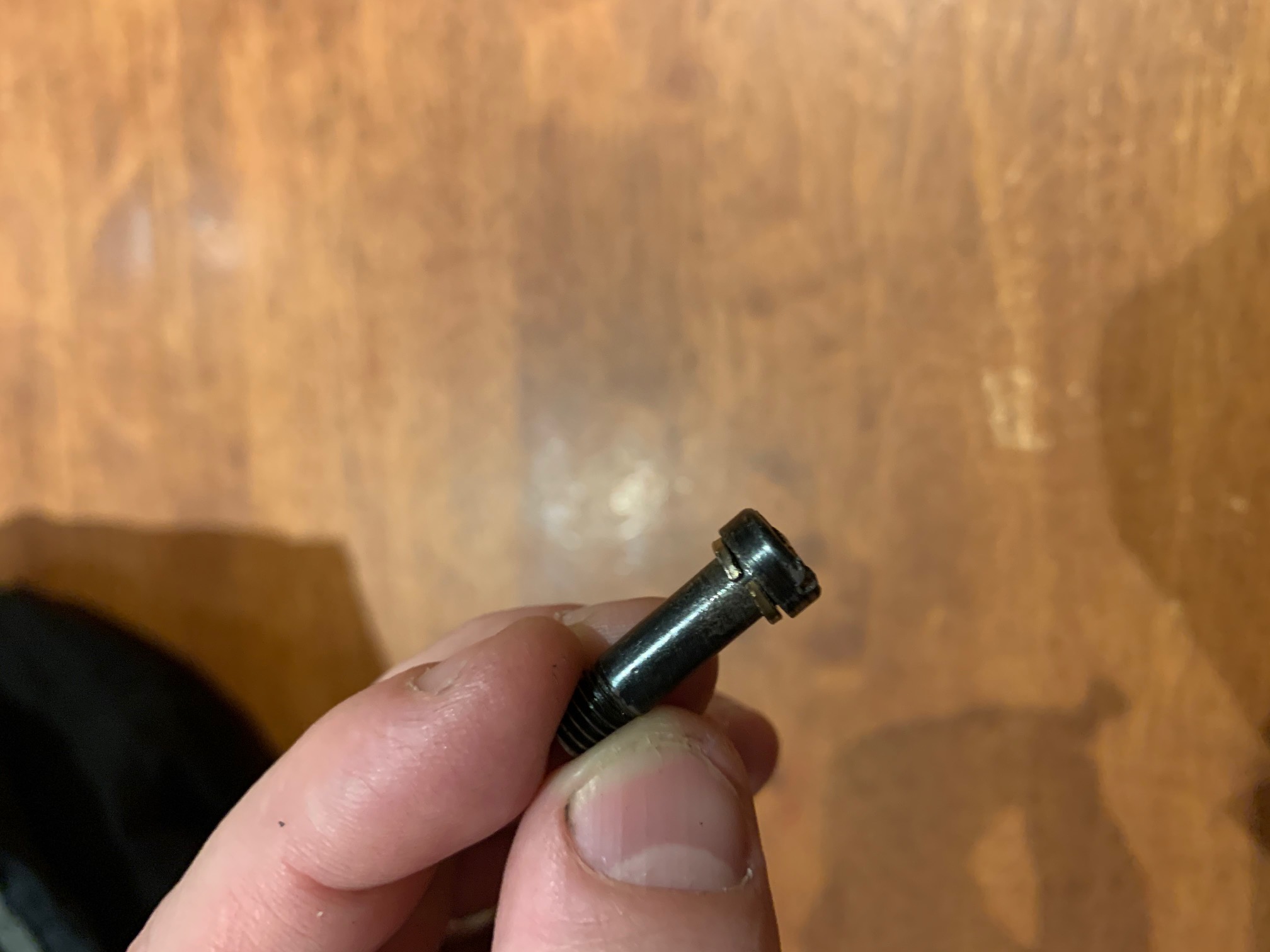

After observing "verticality" in my groups (as somewhat shown in the OP target), I further investigated the potential cause. There a few things to consider. 1) King screw bushing length 2) Timber shrinkage 3) King screw washer / king screw length.
11) king screw bushing 19) king screw 20) king screw washer
Of all the accurizations, the relationship between the king screw and the forend is possibly the most critical, and warrants much investigation and experimentation. And because over time the forend can dry out (without the constent application of linseed oil), there's a good chance your timber has srunk away from the trigger guard. That's exactly what I found with my rifle, and what was causing the vertical stringing.
Make sure a washer is present to prevent the king screw from bottoming out in its hole
The king screw should not bottom out in its hole, hence the need for the king screw washer (20). The king screw bushing should not be tightly clamped between the trigger guard and the action (as was the case with my rifle). Shim the trigger guard until the king screw bushing is not binding, resulting on the clamping force instead being uniformely distributed onto the timber forend. This was actually a technique used on the L42 sniper.This can be done with pop can as I did:
Mine took four pop-can shims to take the pressure off the bushing
Trace the pop can with the guard for a precise fit
Or better yet, a steel shim(s) or washer.
