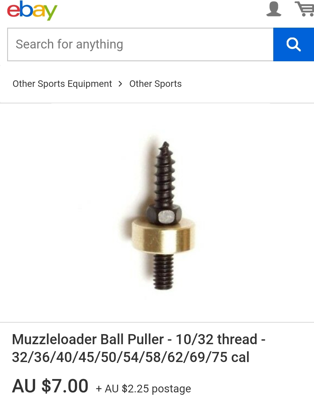

Post by Oldbloke » 18 Aug 2020, 11:07 pm
Self tapper on the end of a rod. Sam as BP boys use to remove lead balls. I got one in the shed.
