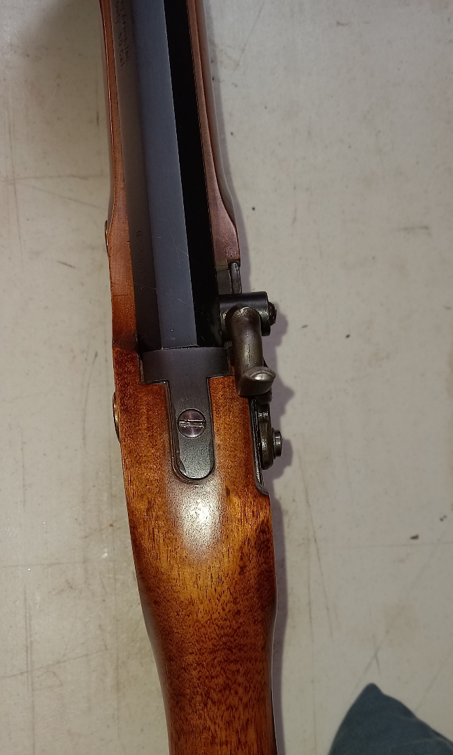

I bought a very cheap muzzle loader about a year ago. Its a 0.50 ball and patch. Wow, its been a learning curve. Lol
As my eyes are no good with open sights anymore I figured a peep would help. But they are difficult to get for my gun and cost fitted almost as much as the gun was to buy. Lol
Currently getting about 2" at 45 yards and would like that at about 70 yards for hunting.

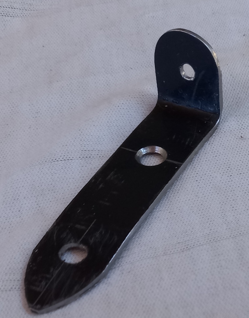

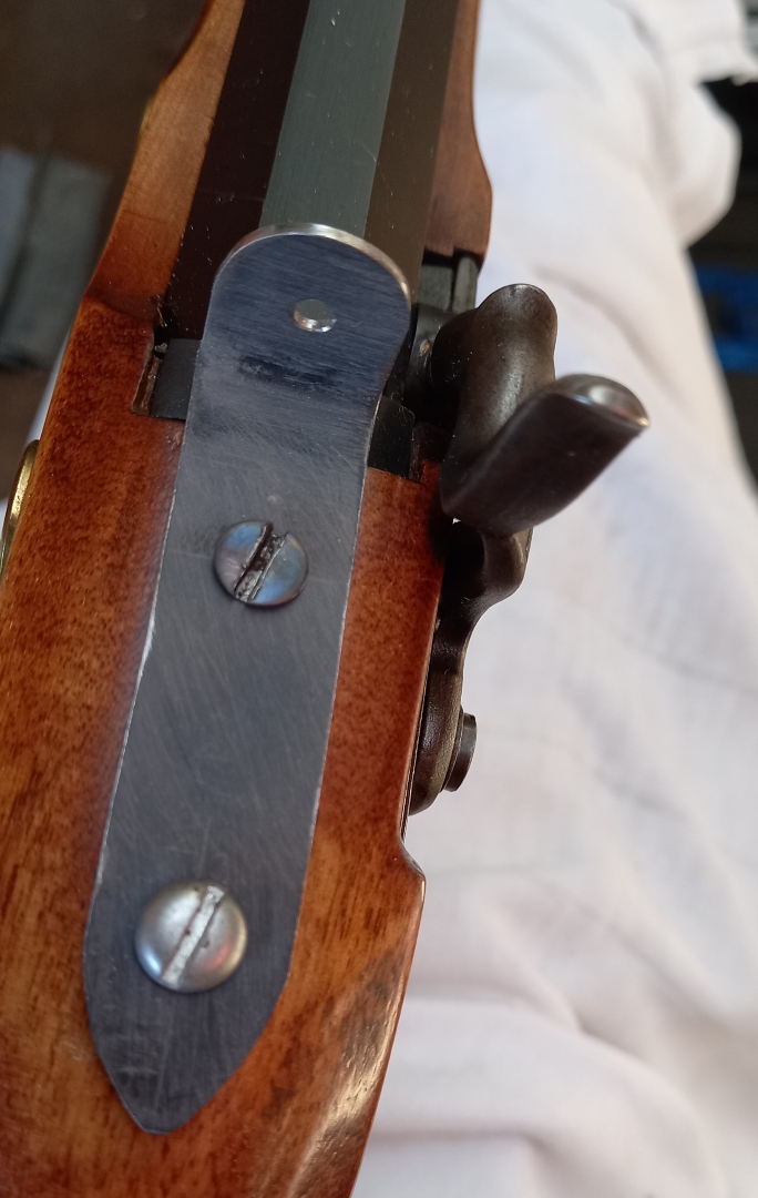

Sooo, its DIY time again. A picture is worth a 1000 words. Just needs painting with pot belly black now.
Note the rear zinc screw is in a slotted hole to allow L to R adjustment and vertical will be achieved with some shims.

Post by LawrenceA » 23 Jan 2021, 1:32 pm
Well done.
Consider slimming the whole thing down. It will block a lot of sight area if chasing running game.
Also if you get it red hot and dunk it in oil and will blacken nicely.
That stock looks like walnut. Not the usual Beech. Hmmmm

Peep installed.
Marred the paint slightly, but good enough.
Peep installed.jpeg (202.74 KiB) Viewed 7220 times
Re: DIY Muzzle loader Peep sight
Post by bigpete » 26 Jan 2021, 2:06 pm
Good enough as is

Still very accurate for a muzzle loader I would have thought, although I know nothing about them. The lock time is...................casual, is it not? Good luck with the peep. I shot with one for 50 years, on and off and there are others on the forum who have experience, I think. One thing wrong with yours is that it is not close to your eye like a target shooter, so groups might suffer but if it is for hunting, then it looks right.
