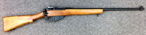

Post by Stoney » 06 Sep 2018, 8:38 pm
No.1 Mk.III* or No 4 Mk l .? For strength, accuracy ? Purely the action.?

Thanks fellas, I have now purchased a Parker Hale Standard No4 Mk1 in Excellent Condition. It appears to be Parkerized and the barrel and action are 10/10. I want to re-barrel it to 7x57R. Question is, am I destroying a decent gun by re-barrelling it?
