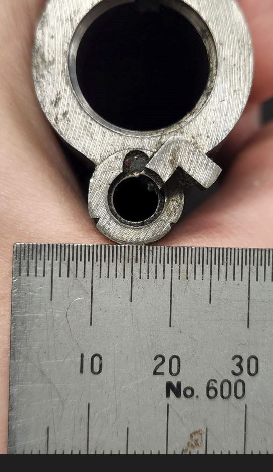

Anyone aware of a rail mount to suit a Savage 24J - its a combination 22LR and shotgun/
I want to mount a red dot on the top barrel ie: the 22LR, normal mounts arent going to work cause of the top round part of the barrel.
Looks like the grooves are cut like an 11mm
Any ideas?

Tubs wrote:Anyone aware of a rail mount to suit a Savage 24J - its a combination 22LR and shotgun/
The attachment file.jpg is no longer available
Any ideas?

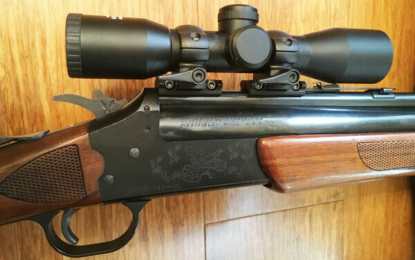

Those are a pain, really needs an old-school style claw mount - these might work
s-l500 (2).jpg (25.11 KiB) Viewed 4229 times
https://www.ebay.com.au/itm/353053799215
Scaling your pic it looks like the curve is about 3.5mm to bottom of the dovetail?
You could email one of the suppliers of these and ask them to measure the depth.

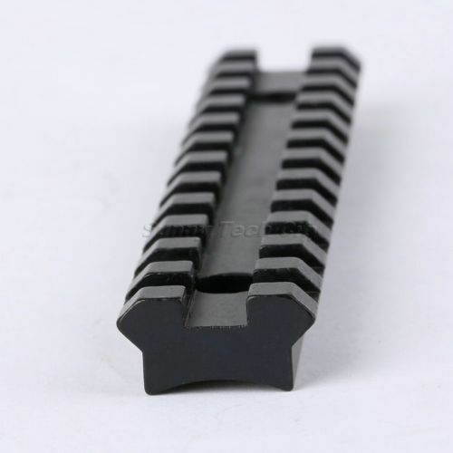

Or buy a curved-base rail and mount it with an epoxy.
s-l500 (1).jpg (15.28 KiB) Viewed 4229 times

Thanks. I dont think this will fit though cause of the height of the barrel - it's not flat like other dovetail mounts
Any ideas?
Hey L, I need a rail for a red dot, rings r good but a dot better given its for a shotty/rimfire, so that eliminates option 1.
All of the detachable mounts arent high enough, 3.5mm is alot of height.
Leaves option 3. Given the barrel is very narrow (22) do u know if the surface area would be strong enough epoxied to handle shotgun recoil and if any rails exist that would sit the smaller barrel?

Tubs wrote:Hey L, I need a rail for a red dot, rings r good but a dot better given its for a shotty/rimfire, so that eliminates option 1.
Thanks
It looks like there is enough meat there to drill and tap a rail onto it, but I would try epoxy first.
Any machine shop can mill the base of a rail to a 6.5mm radius (or whatever) to fit the barrel.
I'd even try it in the lathe with a boring bar and a four-jaw chuck.
Have you talked to Savage about what they suggest you could use?
I Googled it and scopes don't seem uncommon on these.

Thanks mate, Ill buy those claw mounts and start there...
